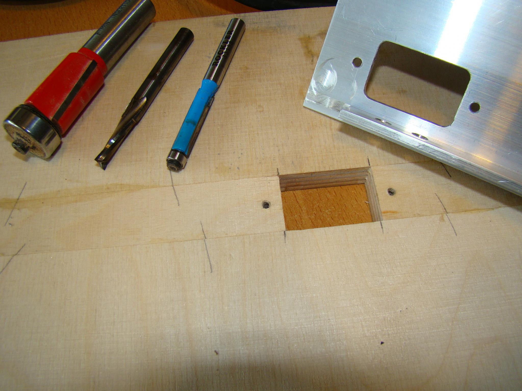

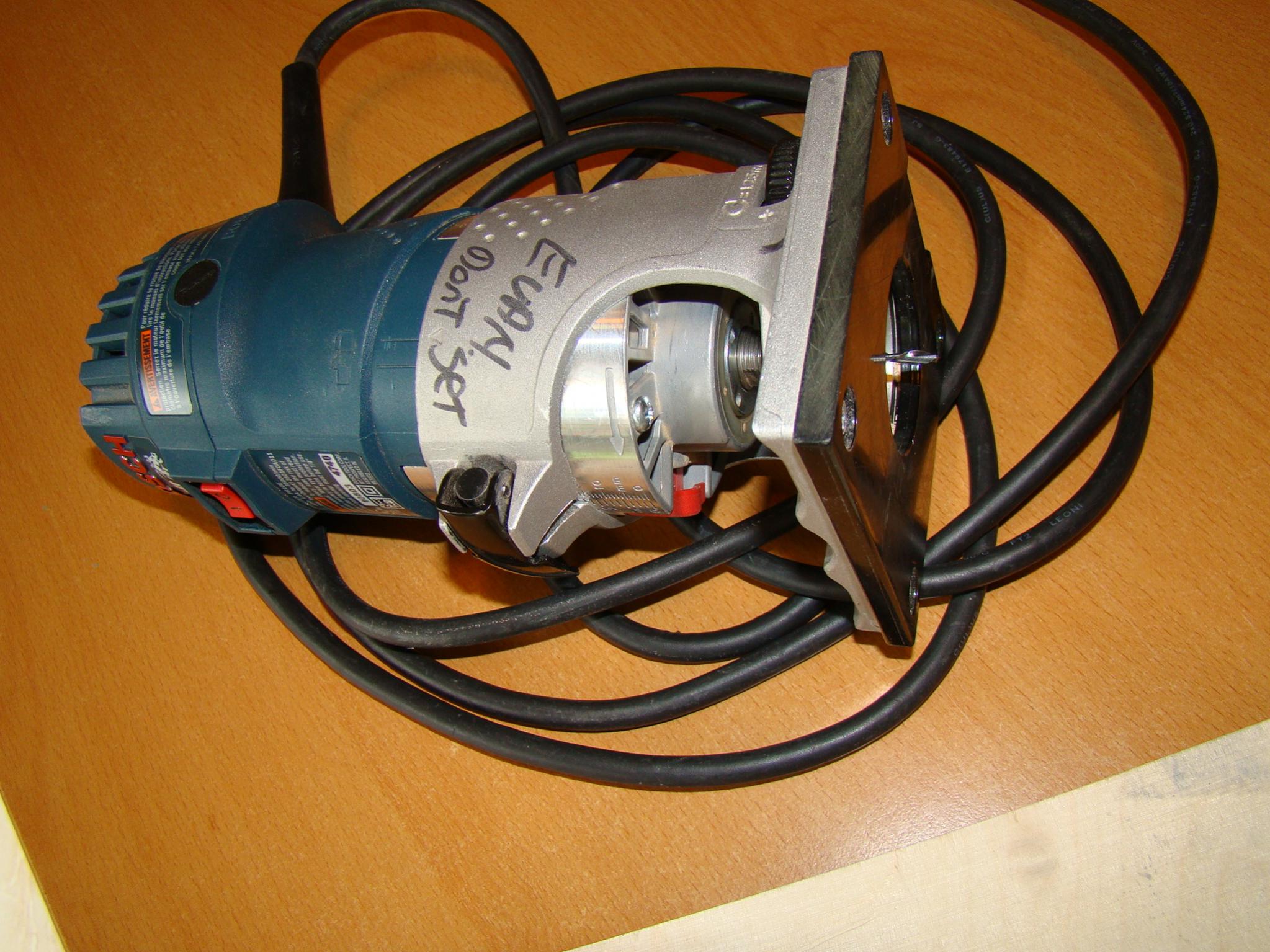

Use the palm router

Use the palm router
That's really nice - looks like you have an adjustable rectangle in the wood!
Can you explain the process - is it 1) make template in wood, 2) clamp metal to top of wood, 3) drill large hole in center for bit to pass through, 4) use the bit with the flush bearing on bottom to trace out the perimeter?
Straight 1/8 metal bit on the router, which *must* move along an rail or against a firmly clamped L shaped aluminum extrusion.

you got it. A hand router is fine. Carbide is harder then aluminum. Same rules as routing wood. I like spiral flute bits but they are not required. Take small bites move not too fast and no climb cutting. The climb cutting thing is tricky at first but becomes second nature. People will say climb cutting gives better results but the chance of the tool getting away from you are too great.
I like these bits but any will work.
