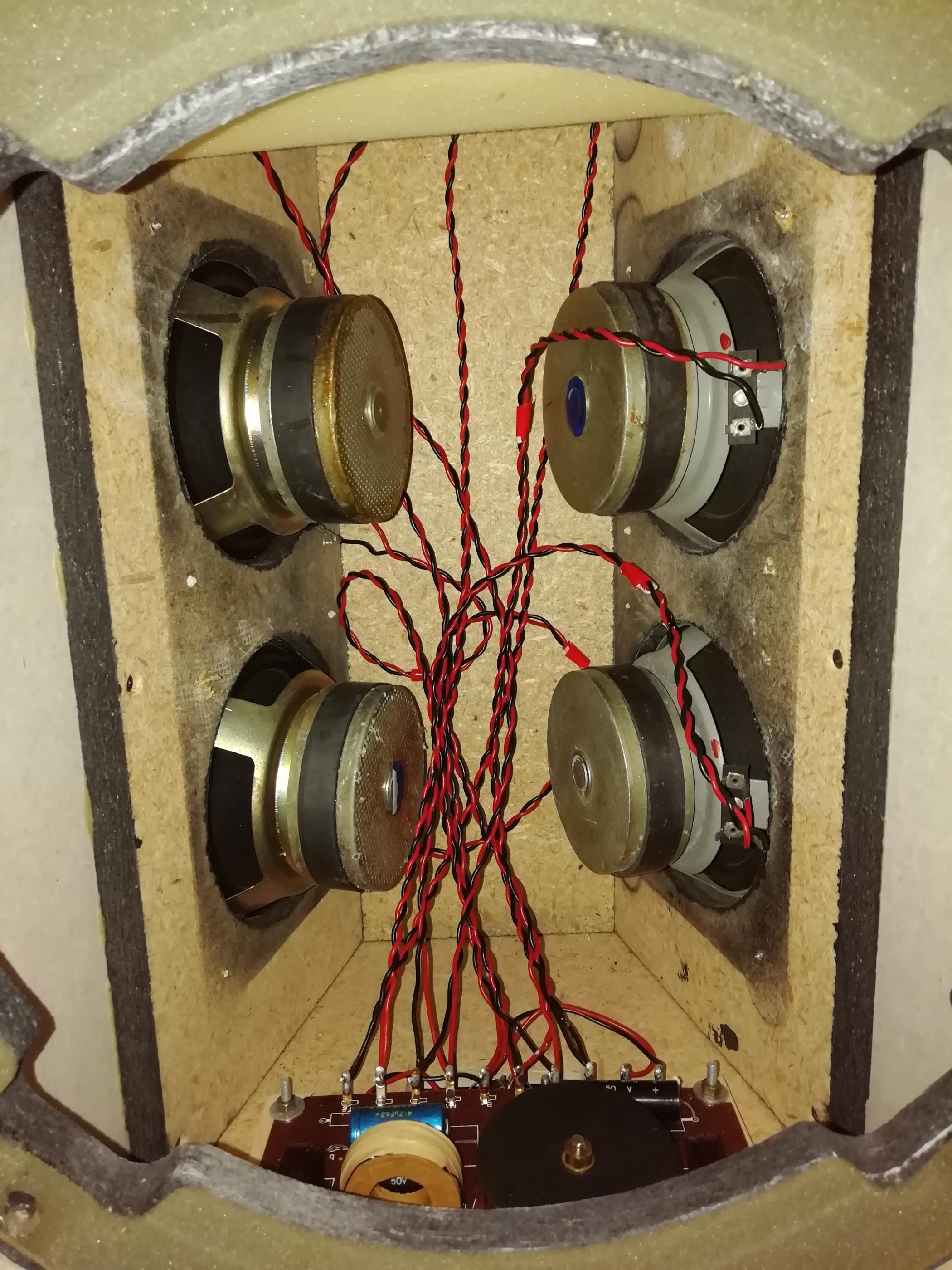

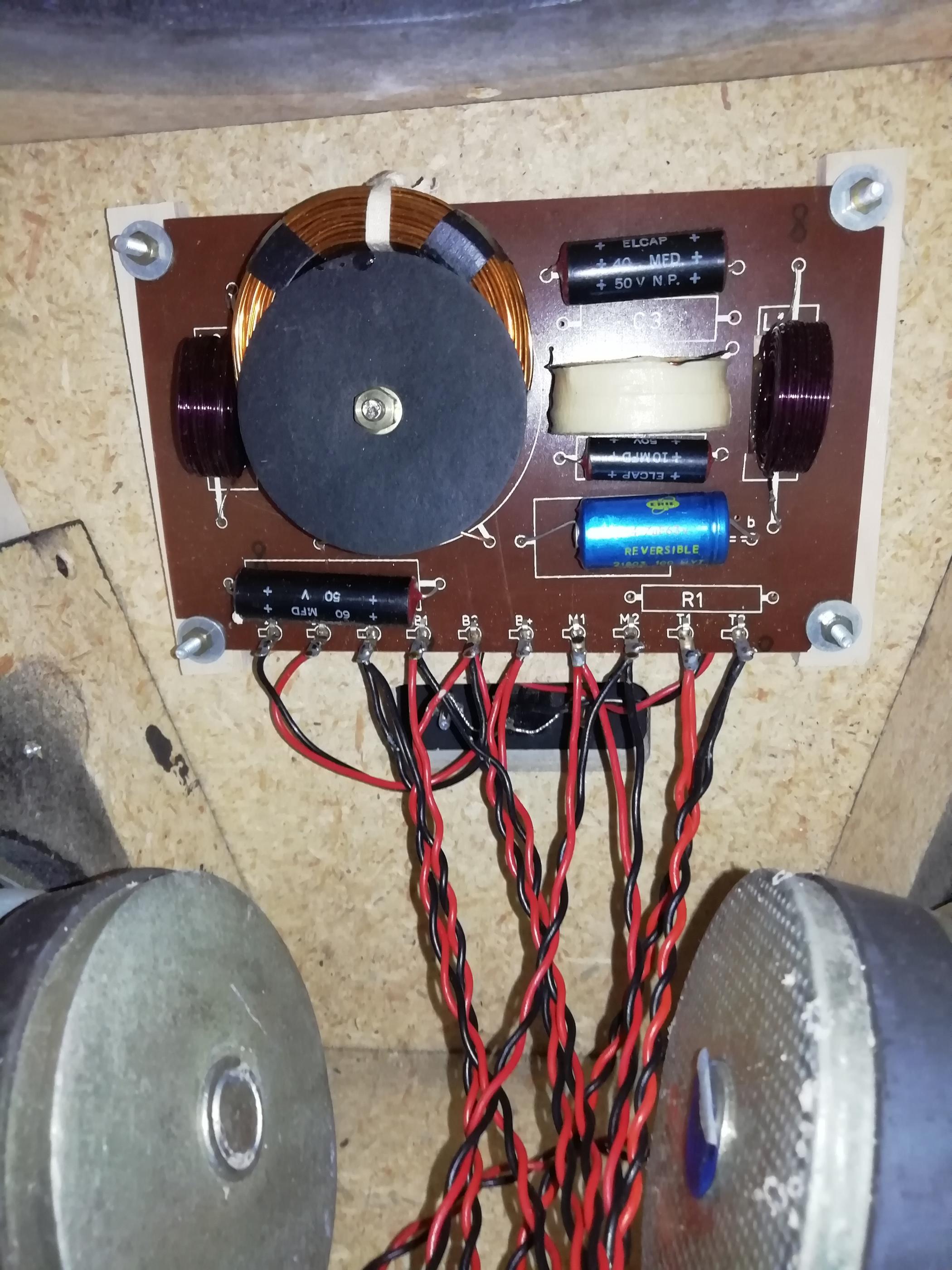

I've started work on renovating them, took off the passive bass radiator to reveal the crossover.
Wiring could do with a tidy, my next move is to replace the old capacitors on the crossover. Would anything else need to be changed? Inductors never really have issues do they?
Capacitors are
4.7uf 63v
40MFD 50v
10MFD 50v
60MFD 50v
My thoughts were to buy ALCAP capacitors as they are a close match to the originals.

Yes, those old electrolytic caps (Elcaps etc.) will need replaced. The crossover will have been tuned with the ESR of electrolytics in mind, so best stick to electrolytics such as Alcaps. Also consider the Mundorfs from Wilmslow Audio.
Mundorf Electrolytic ECap Capacitors
The inductors can be left alone.
The twisted pair wiring looks good to me and you would hear no benefit from changing it.

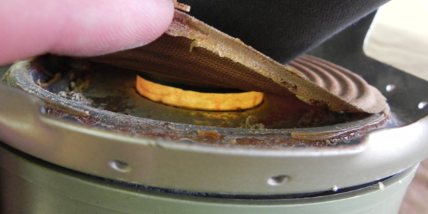

That's a common problem with drivers of this age. Also worth checking that the rear suspension spider is still securely glued to the driver basket - see attachment.. . . over the years the glue somehow had weakened and the surround was coming away from the chassis.

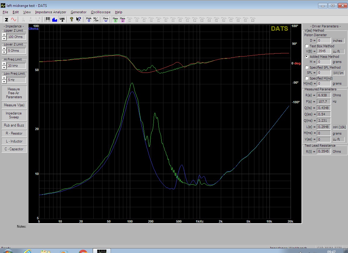

Well spotted Galu from the graph produced it shows from around 400hz to 1.5khz isnt smooth even after glueing the surround.

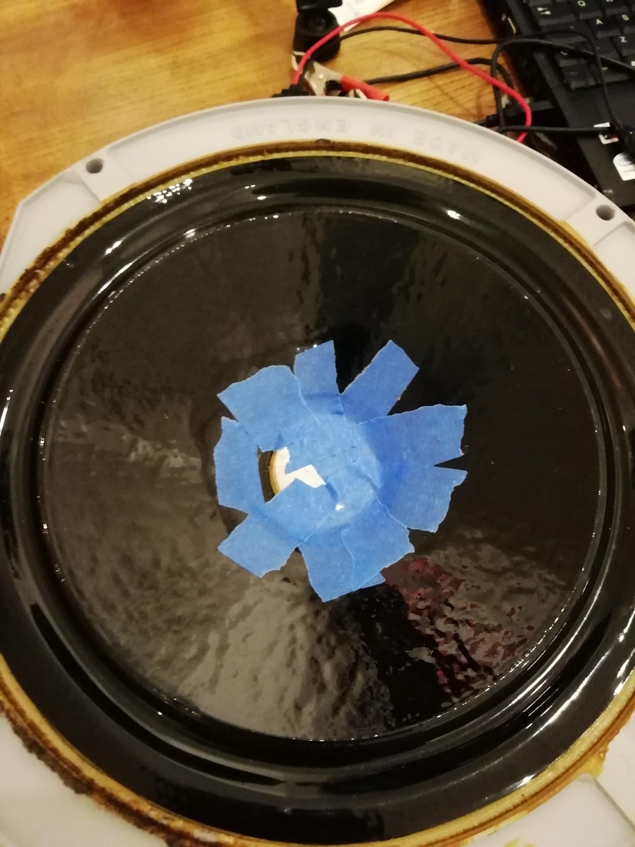

I doubled checked the spider and it was fine, what i need notice though was as i moved the spider the voice coil was sliding up and down the cone/diaphragm! The glue here had also come away, so that has been glued now and hopefully i will do another test and it should be a smooth curve.

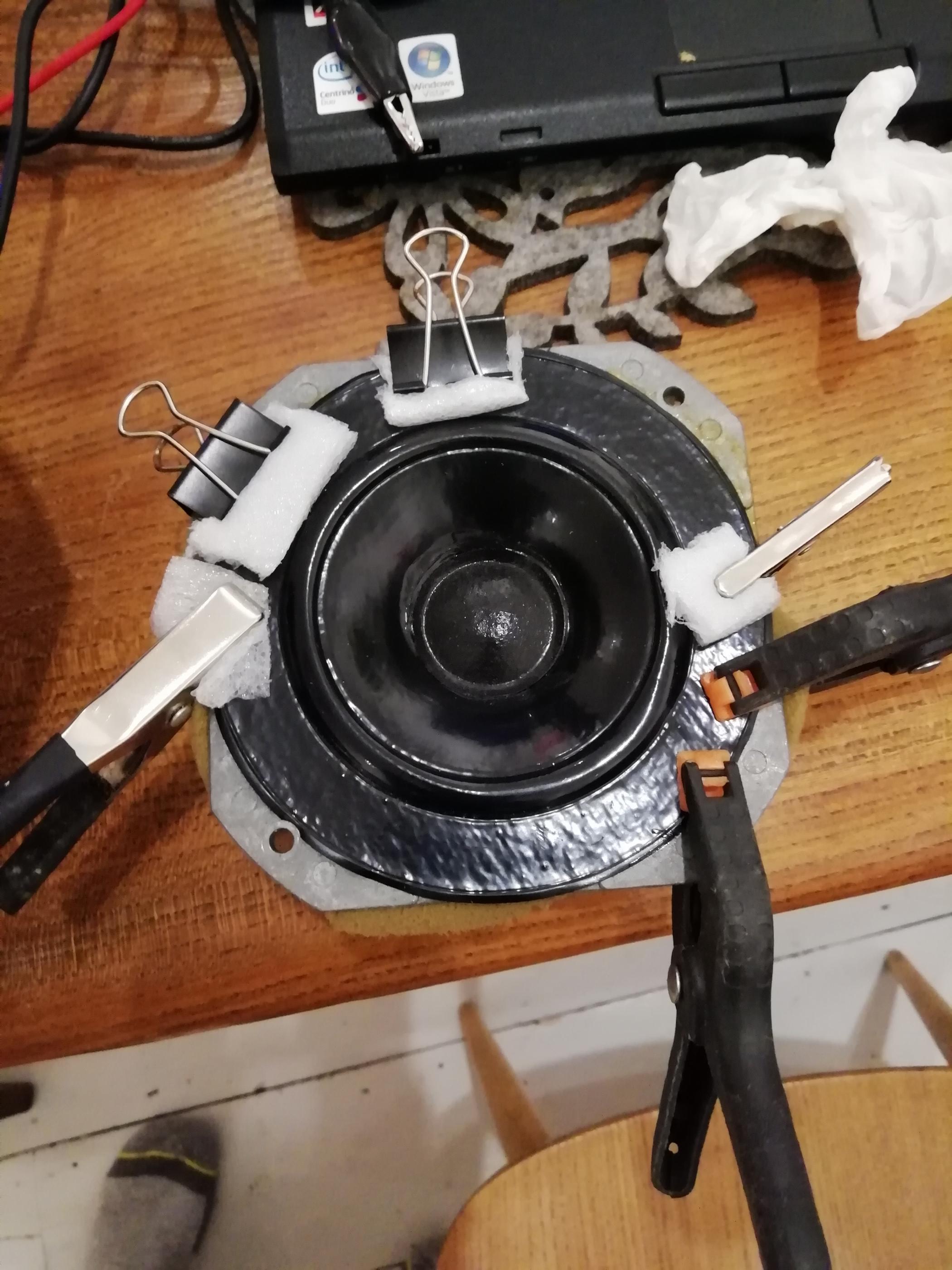

Every Driver has been thoroughly checked with the dayton dats v2, the bass drivers i will match them up closely.

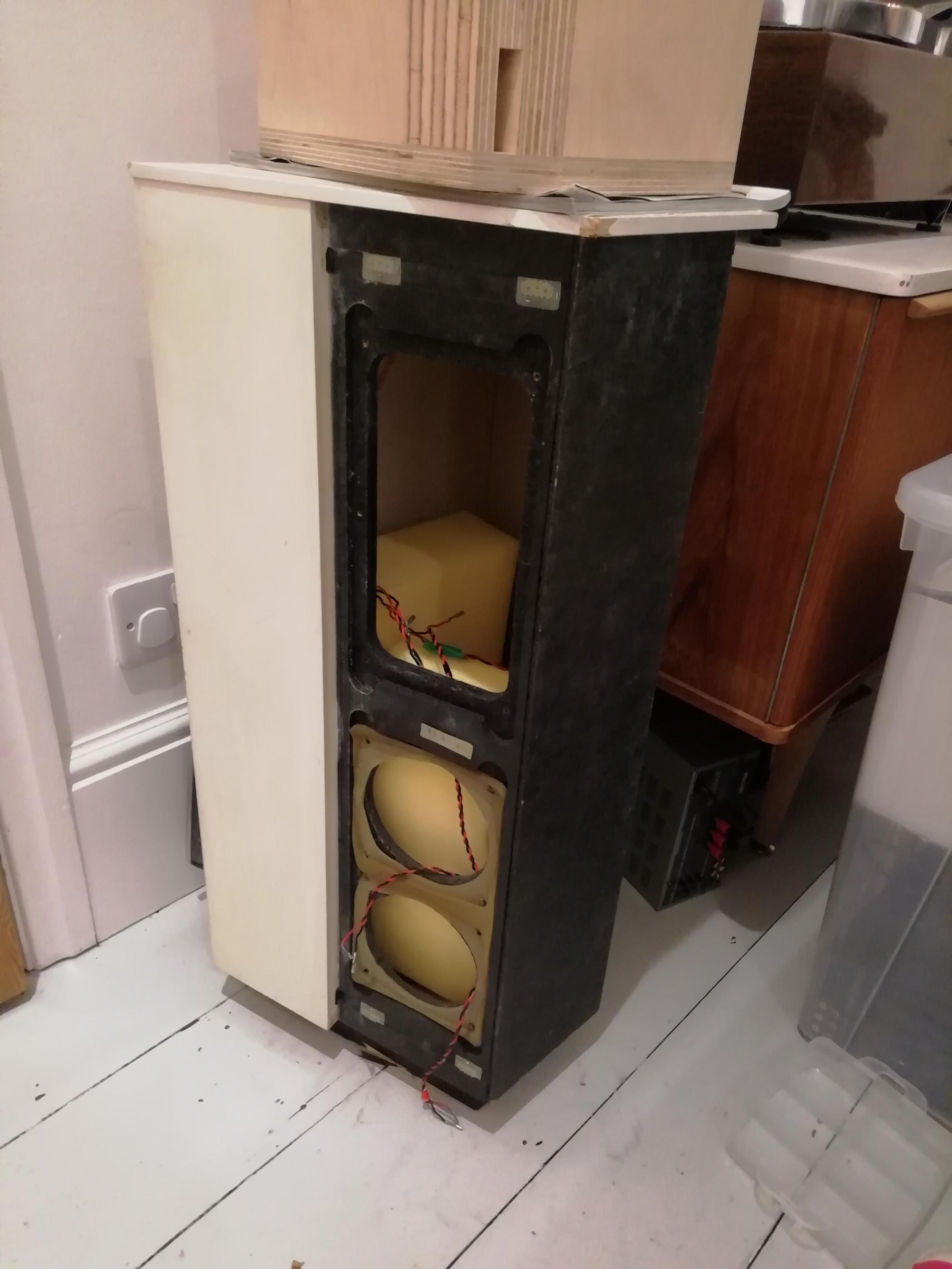

I have glued and checked all parts where needed now!, next is to tackle the cabinets and get them filled, sanded and repainted.
Not to happy about the sponge dampening material, i have lots of polyfill and wool to thinking one cabinet i will leave standard and the other use poly acoustic wadding and see which one sounds better.

Foam alters the sound quality at high frequencies, while wool felts alter the sound quality at lower frequencies.
At least that is what it says here:
How to Use Sound-Damping Materials in DIY Loudspeakers
Perhaps you could also experiment with a mixture of the two?
Yes Galu that's worth thinking about because filling the enclosure will increase the effective volume and alter the low frequency response damping etc. But after all these yrs the T/S parameters of drivers and bass radiator are likely to have drifted a bit.......so the result will be like the marriage vows.....it will effect the speaker 'for better or worse' ha ha.
