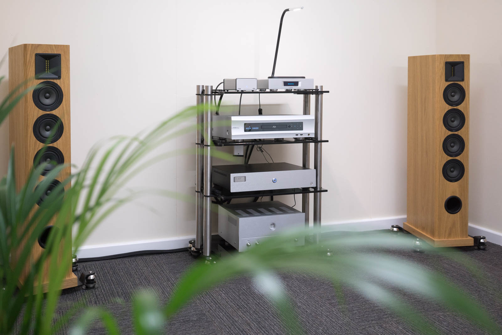

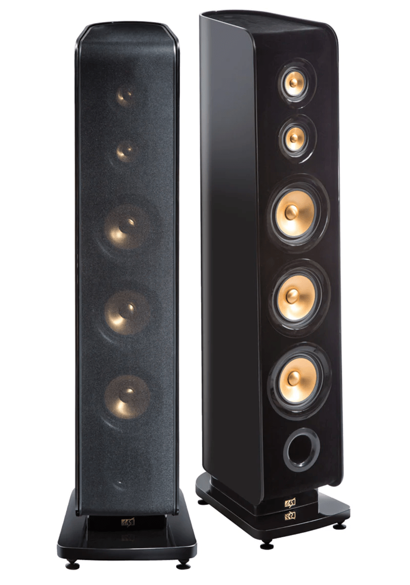

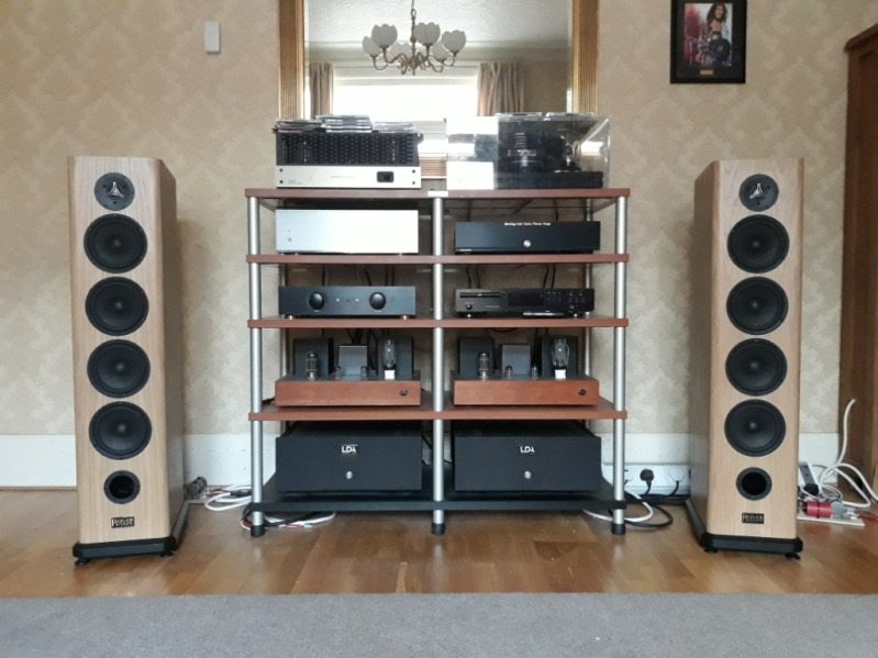

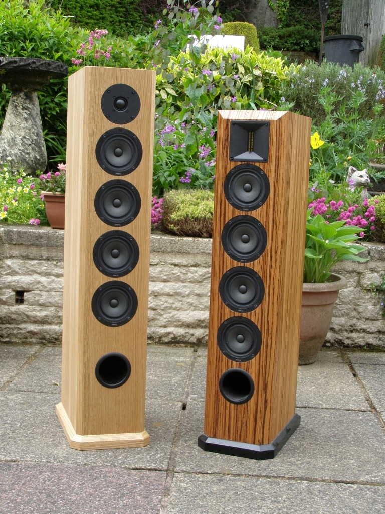

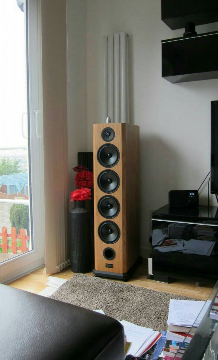

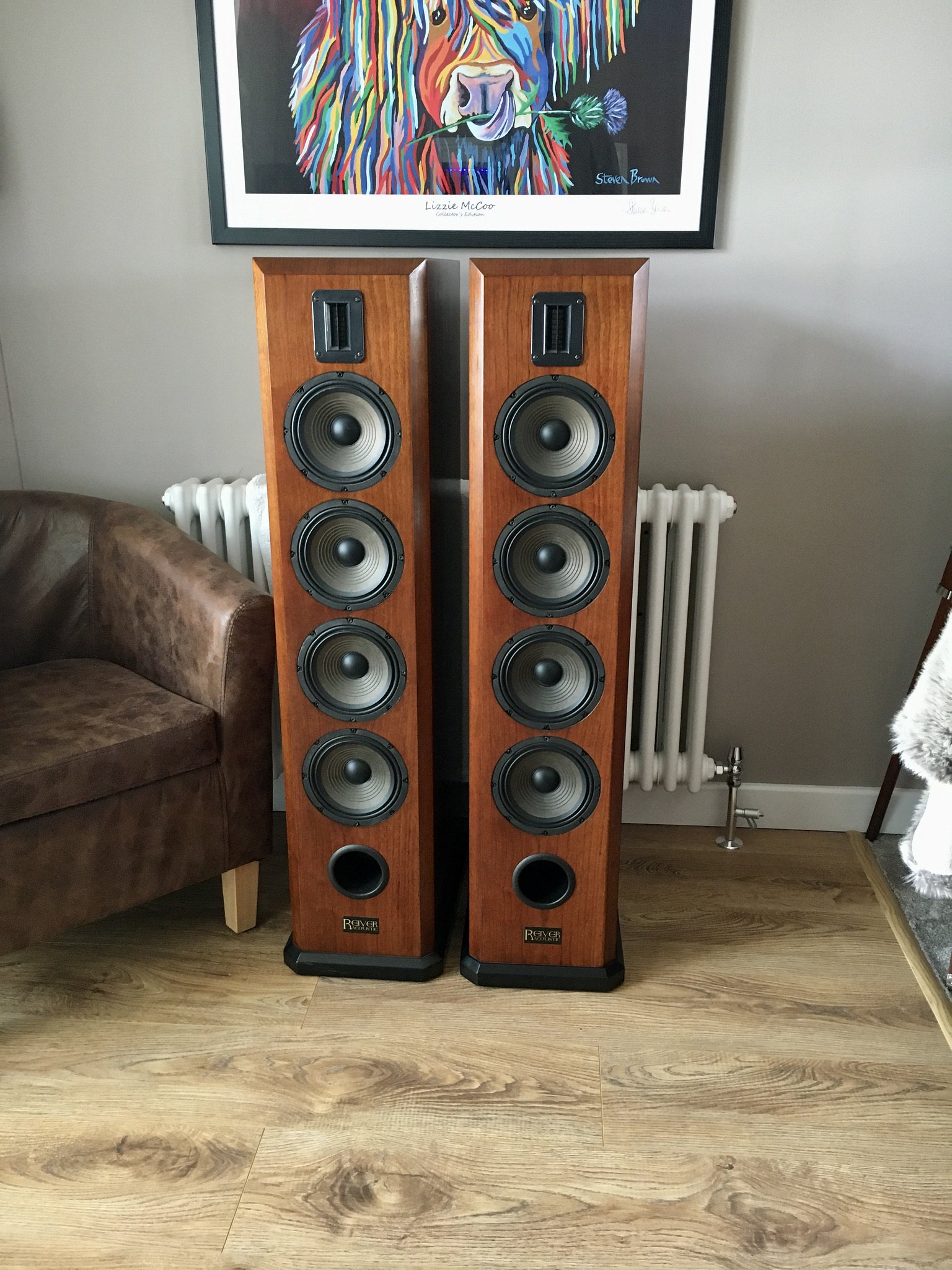

This do (given chronic-insomnia and 0200 BST on my laptop)? 😉

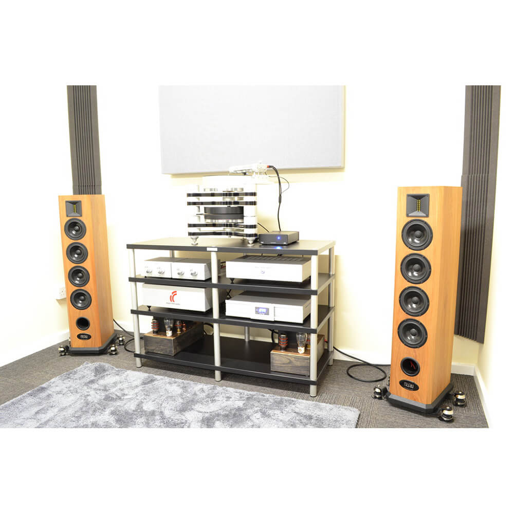

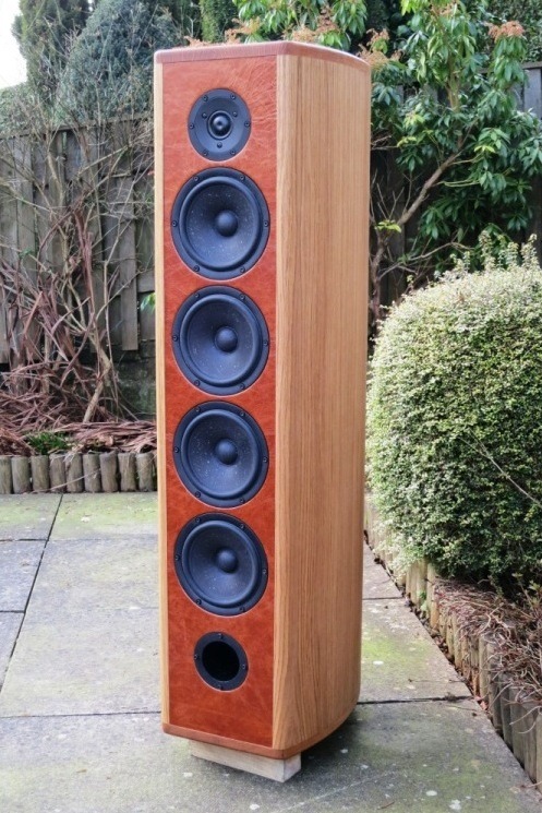

From top left:
MCRU 165; MCRU 127 (not visible in these pictures, but these had a rear-firing tweeter in addition to the forward-firing); Edingdale GT; Edingdale MkII; Edingdale MkI; Edingdale SR; Jenna & Rossendale (side-by-side); Norge, Viotti Tower. First two designed & built as OEMs for MCRU by myself & my cabinet-building partner in crime Colin, the Edingdales, Jenna, Rossendale & Norge for our own (now retired) Revier Acoustics brand, Viotti Tower designed for / with MA-Sota.
From top left:

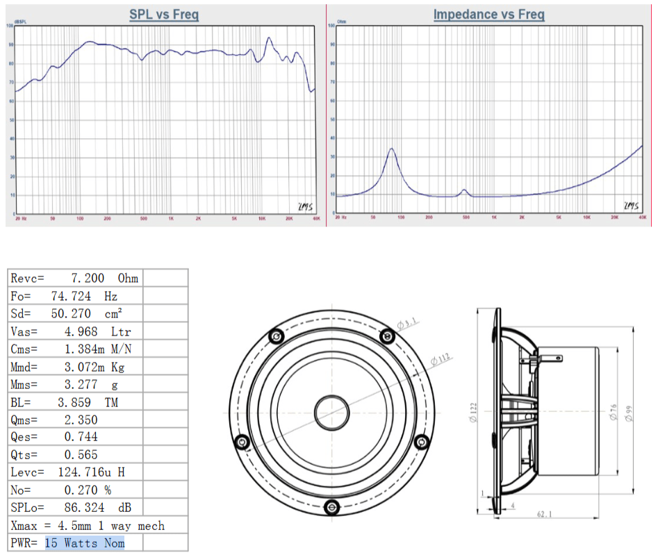

Can you explain it?
https://gr-research.com/product/lgk-woofer/
https://gr-research.com/product/mini-woofer/
No graphs, data... 🙁
LGK 2.4

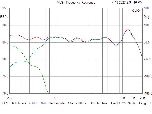

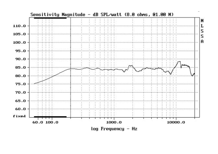

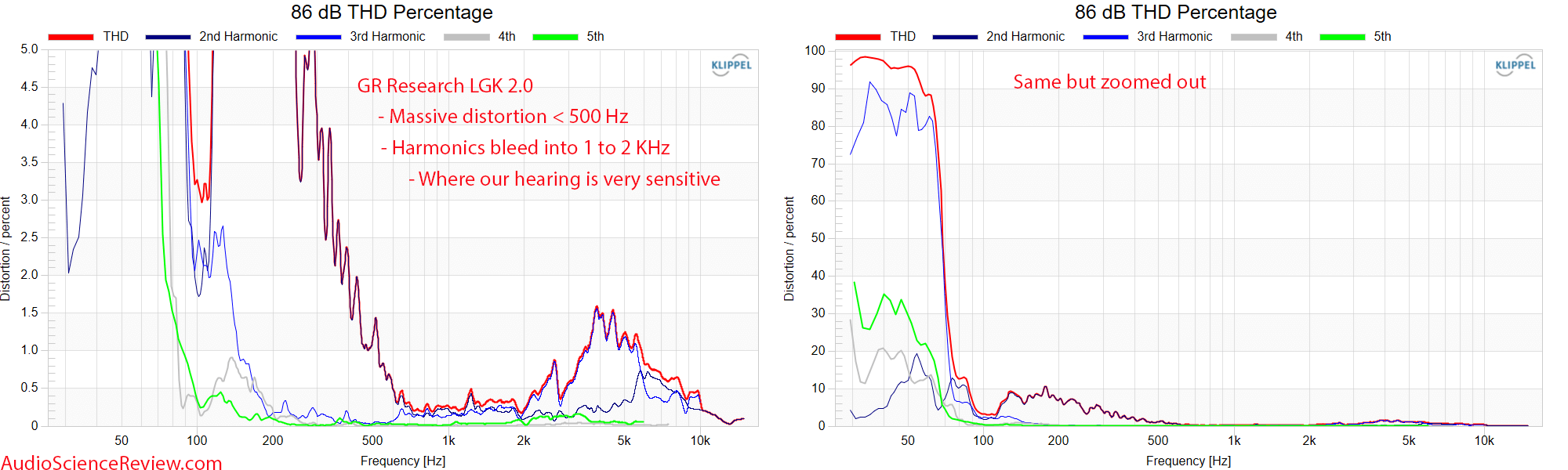

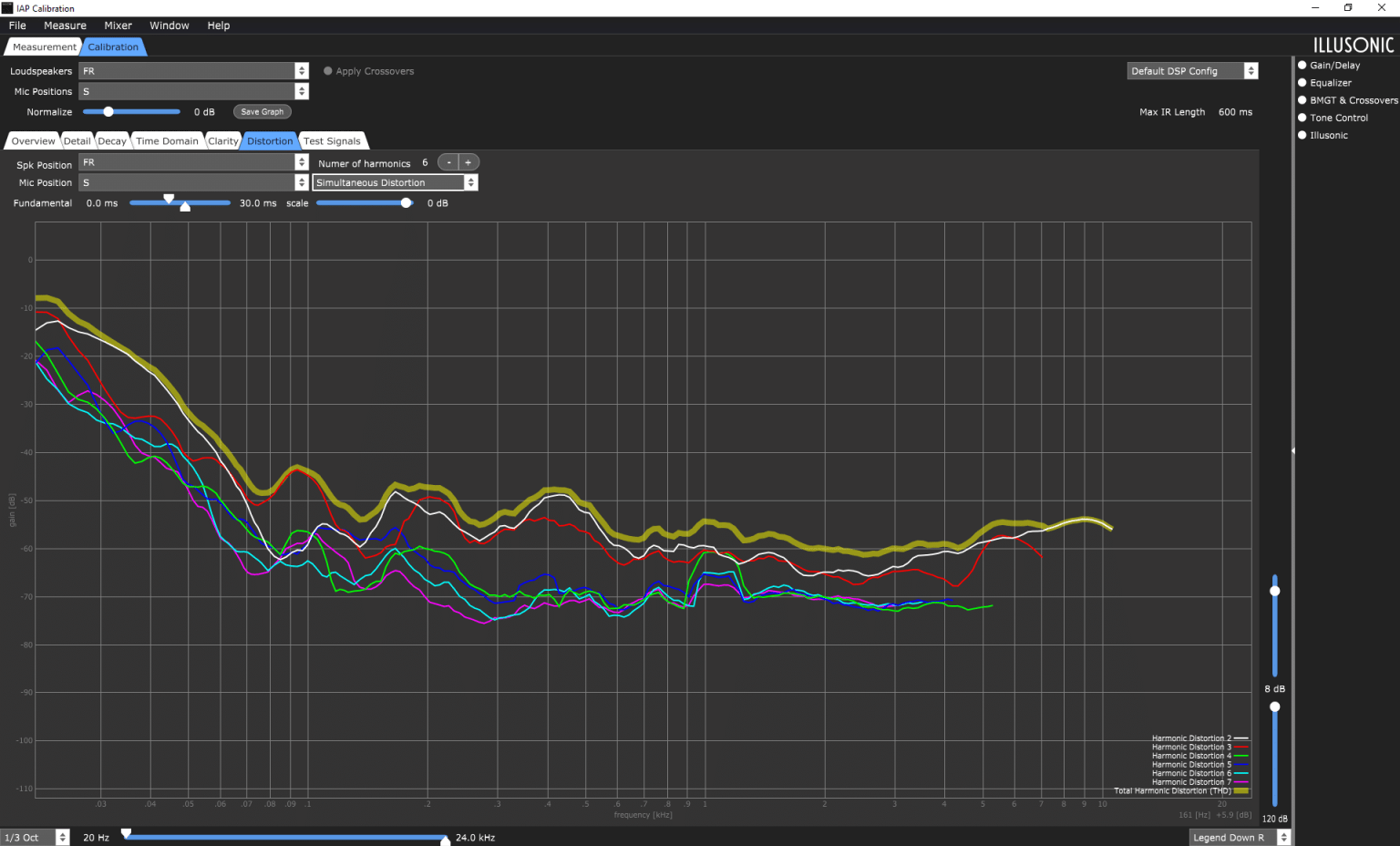

The problem with the 3" LGK is... the high distortion < 500 Hz. A priori, cutting at 350 Hz is too low for that driver. And the distortion grows after too 🙁
Yes, bad choice.
The point is that with other all-band speakers we do not know the distortion graph.
https://www.audiosciencereview.com/...research-lgk-2-0-speaker-review-a-joke.34783/
Yes, bad choice.
Danny does not have the academic background, it is obvious, but he is not the only one. Very few have studied subjects like Electroacoustics, signal processing... you know.

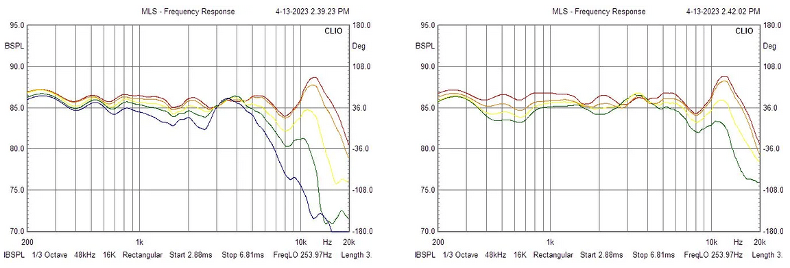

It's around -5 dB by 500 Hz. Granted not a rock monitor but not ASR level bad.it works > 350 Hz
