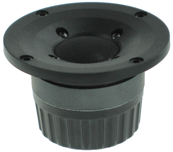

Seas 27TBCD/GB-DXT
THE ART OF SOUND PERFECTION BY SEAS - H1499-06 27TBCD/GB-DXT
http://www.seas.no/images/stories/prestige/pdfdatasheet/dxt_seas.pdf

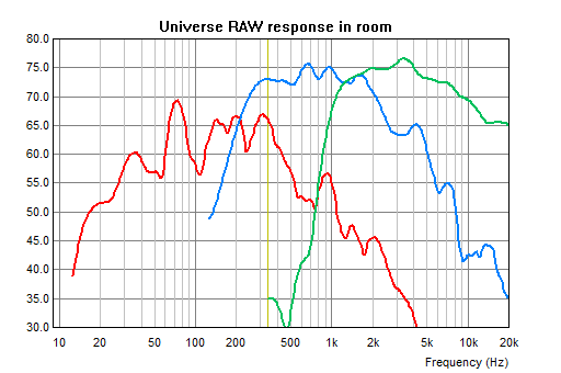

Monacor DT300 + Monacor WG300
Can be seen on Troels website
Price < 40$ ? Easy to find in in Europe.
Very good value. A good treble. Can go as low as 1500Hz.
My measurement on axis.
Uploaded with ImageShack.us

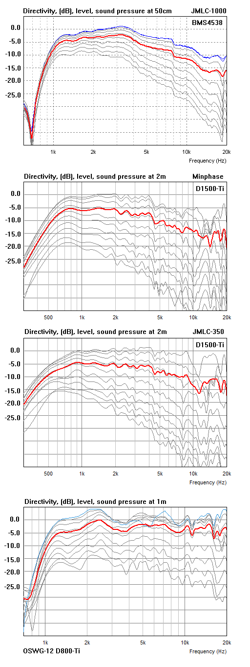

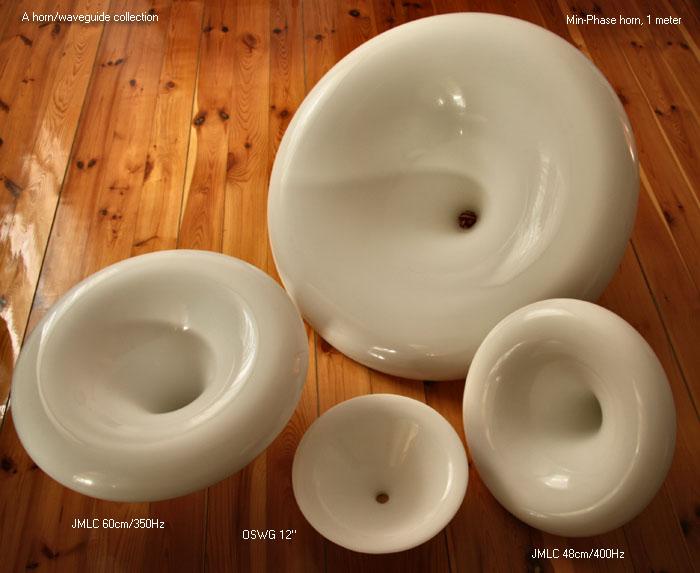

Jean-Michel Le Cleac'h's horn flair (terracotta horn on the "update section near the bottom of the page):
http://www.arduman.com/aa/Sayfalar/lecleach/lecleach.htm

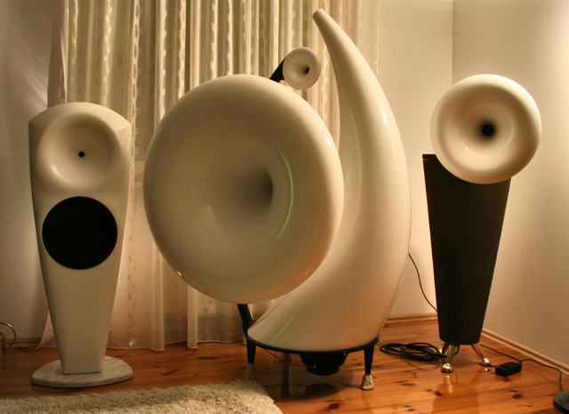

Azurahorn (various sizes):
Azurahorn -Le Cleac'h Acoustic Horns - Products
Vintage JBL and Yamaha drivers.
