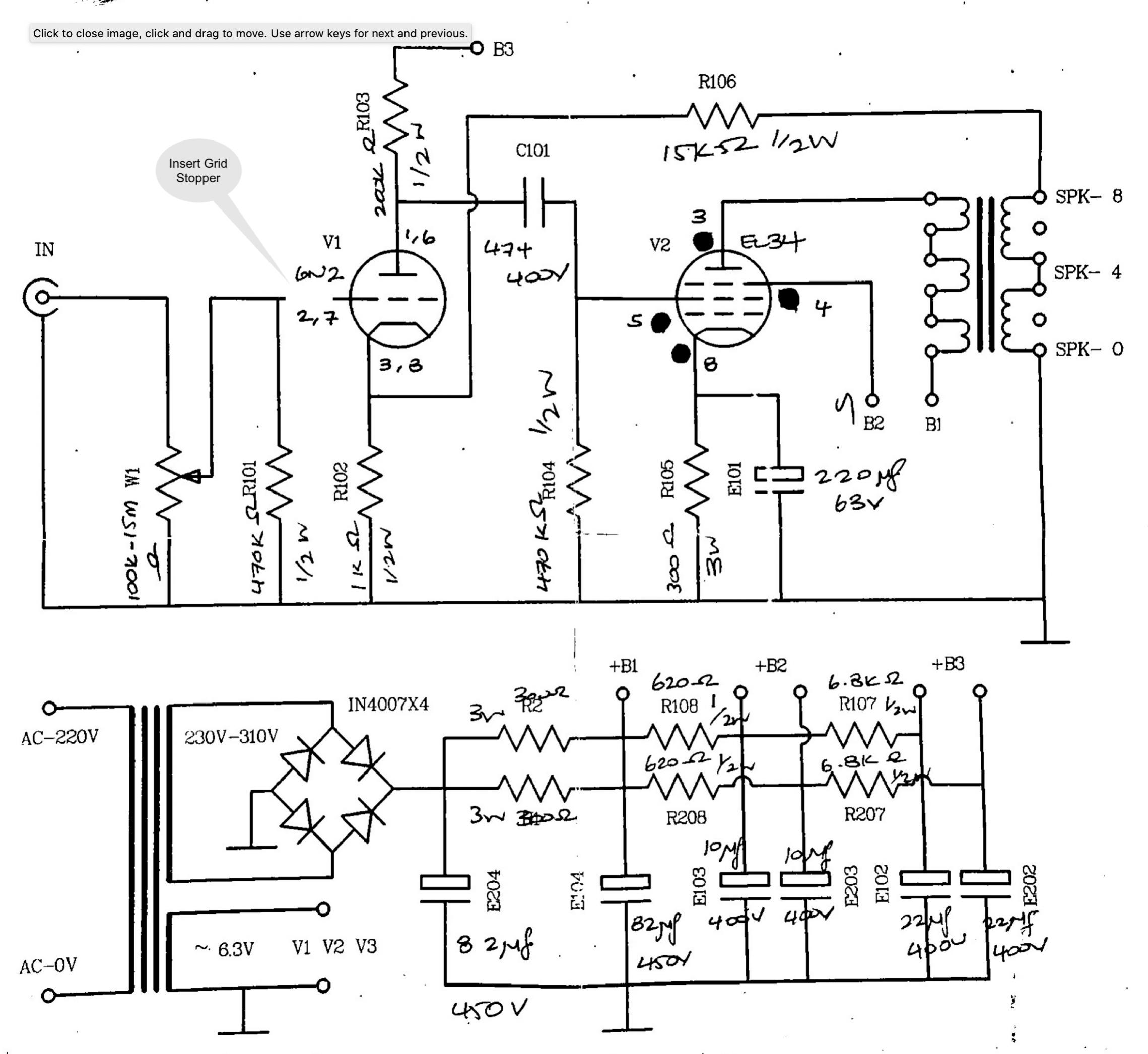

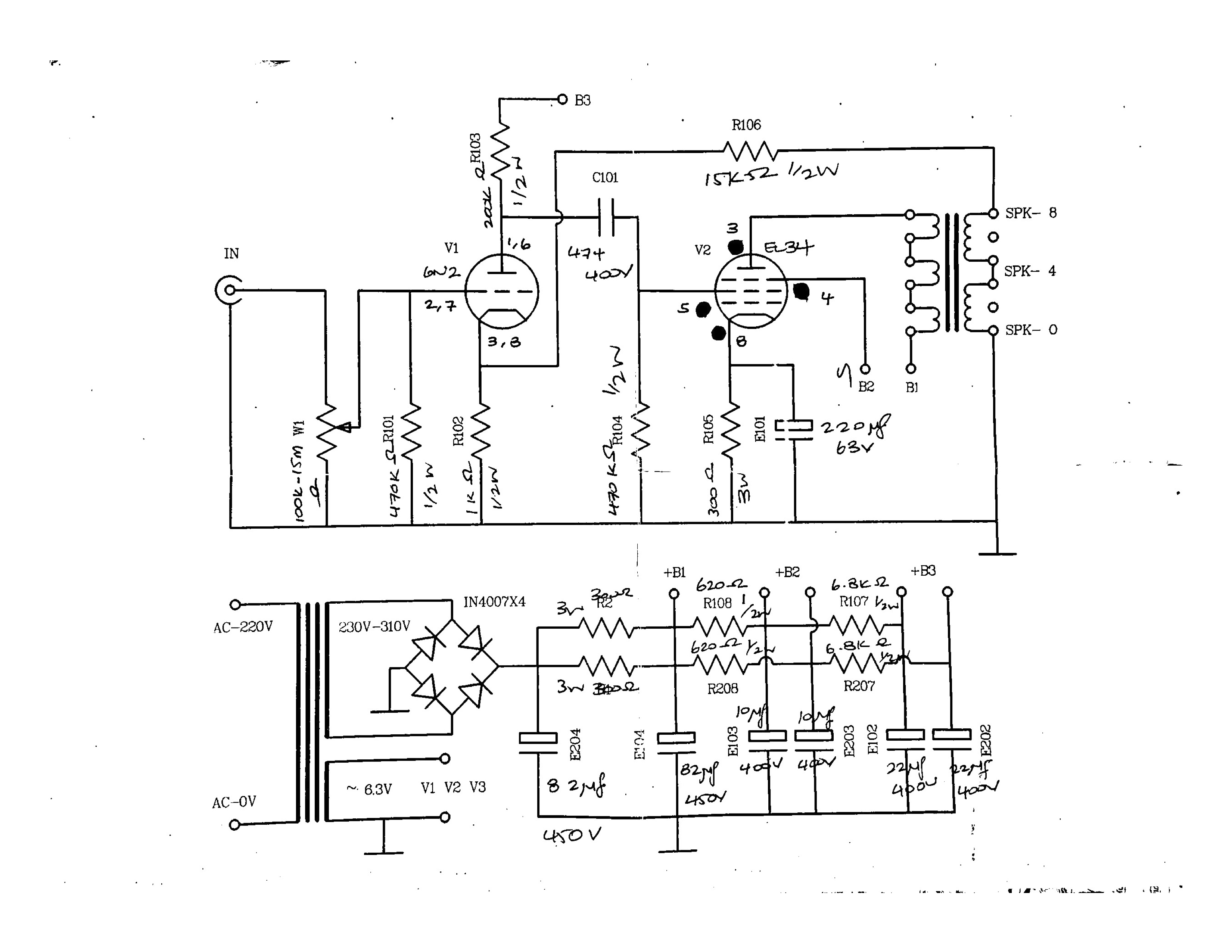

Forgive me for the rather simple question, but can anyone point out the grid stopper resistor on this schematic? I'm trying to extend my tube sockets from a PCB to fit an enclosure and the advice I was given was to solder the grid stoppers directly to the socket. I attached the schematic and the reference document I was looking at.

There aren't any on that circuit, but if you're going to extend valve sockets they should probably be added.
The first schematic is a Guitar amp, not a Hi Fi amp.

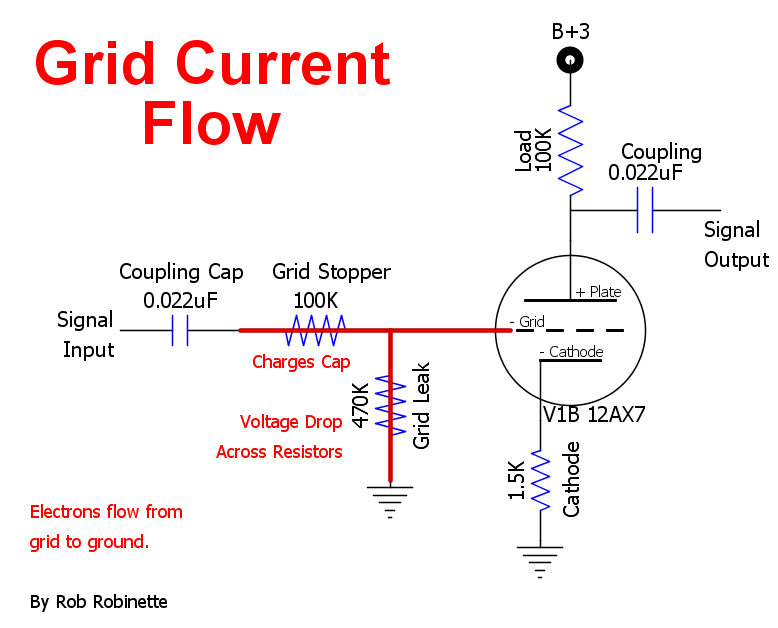

And that 100k resistor is Not a grid stopper resistor.
A true grid stopper is always connected directly to the grid, with Nothing else connected directly to the grid.
A typical grid stopper of 1k on a 12AX7 would connect directly to the grid; and the other end of the grid stopper resistor would connect to both the grid leak resistor and also to the coupling cap.
The second schematic does not have any grid stopper resistors. If you disconnect the wire from the grids, and connect a resistor between that wire and the grid, that is a grid stopper. The end of the grid stopper resistor needs to be connected right up at the socket tab that is the grid tab.
Using a long wire to connect from the grid stopper resistor to the grid will defeat the purpose of a grid stopper.
I hope that explains it.

Thank you for all the replies! I figured even though I am building a HiFi amp and not a guitar amp the theory would be relatively the same. Would a 100k resistor be suitable?
Yes, if you're OK with high cutoff frequency of 8 kHz - they do it in overdiven guitar amps for a reasons completely unrelated to HiFi ones.Would a 100k resistor be suitable?
Something like 1k would be more appropriate.
Perfect, I read through that article and it suggests something low like 1K for the preamp stage and suggests something like a 5.6K for the power tubes.
I am using a 12AX7 for the preamp stage and two EL34's for the power stages. Does that look acceptable?

I read that the 12AX7 can take anything up to 68K at which point the high frequency response is becoming curtailed.
1k is probably an acceptable figure. If the amp suffers high frequency oscillation, you can increase the value.
