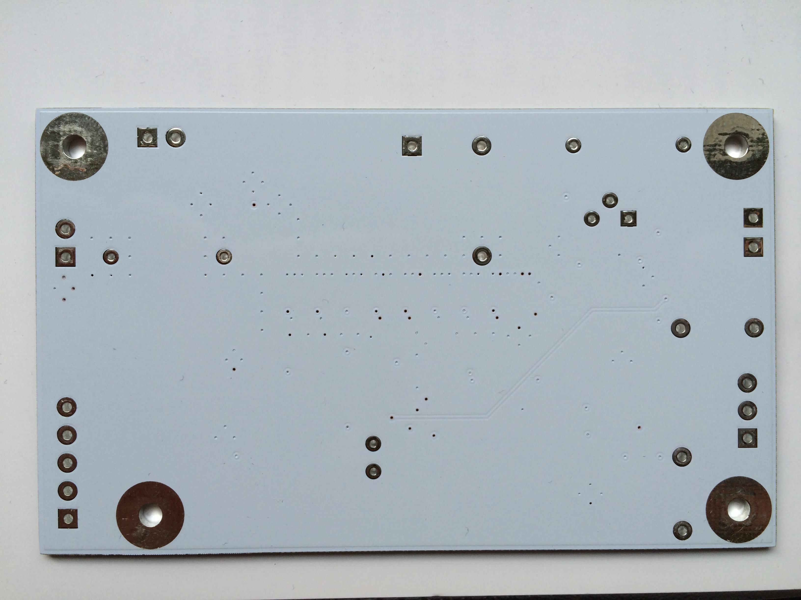

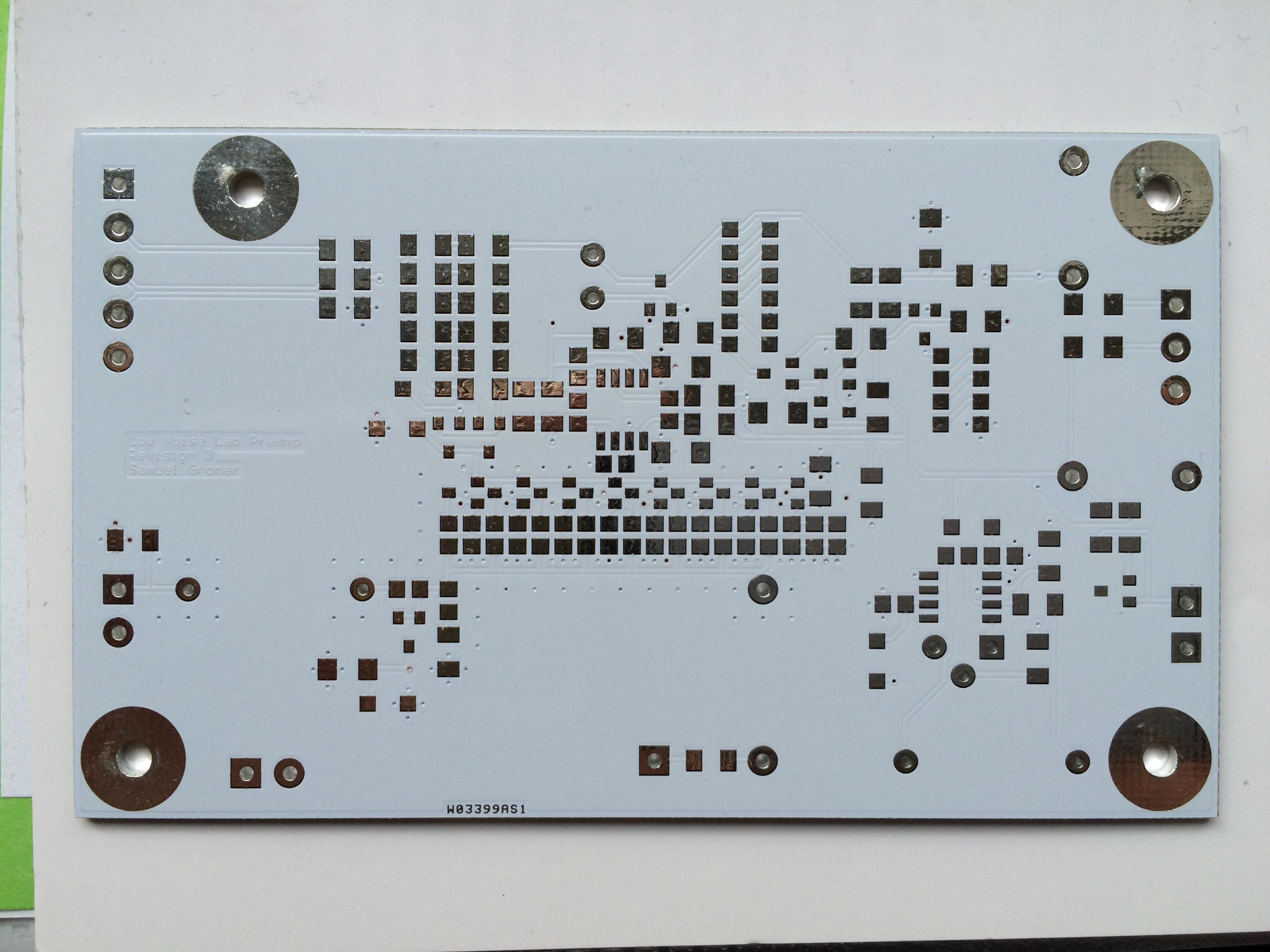

I have a couple of boards left, I had them made by pcbways.com (in fancy white), but so far did not come around to build one.... I attached some pictures, the general impression of the boards is good, some minor glitches on the surface finishing around the mounting holes, but nothing on the solder pads themselves.
Since I never built one, of course I cannot garantuee that the boards were fabricated 100% correct. If you bear the shipping costs, you can have one for free, and I have a betatester for the batch of boards as well as some motivation to get mine done, OK?

Hi Hallodeletue
That would be great! I was wondering what was meant by"an overlay print is not included in the Gerber files" - I now see there's no silkscreen. Not a problem.
I've had good experience with PCBWay recently, although they are currently building my first 4-layer board with them which will be the most significant test so far.
I will PM you my address in London and let me know the cost of postage.
