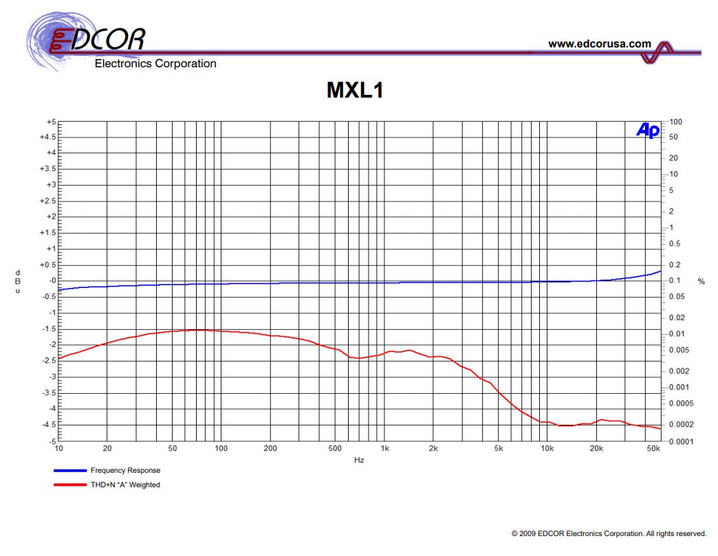

I'm getting a parts list together for a headphone amp that I'm working on and would like to incorporate an audio source ground loop isolator using a couple of matching transformers. The circuit is simple enough but I'm seeing several different impedance recommendations. Generally 600 and 10k ohm. They have some reasonable wide frequency response models over at Edcor in several impedances. Any of you done this? Can anyone recommend a proper impedance for use with a tube amp? I'm using a 6DJ8 on the input and I don't know what input impedance it likes to see (or how to calculate it for that matter.) It'll take months for them to get here so if I find out I ordered the wrong transformers, I'm probably gonna break down and cry... I'm also hoping that this will solve a little problem I've run into. My phone has no headphone jack. I have gotten two of those USB-C to headphone dongles with the integrated DACs in them and they positively REFUSE to turn on unless actual headphones are plugged into them. No aux input works, either on my headphone amp or any other commercial equipment that I've tried. I'm assuming that the DACs in those things are looking for an inductive load before turning on to protect themselves or something. I'm just not sure. Anybody have experience with that?
If you're trying to drive it with a standard 6DJ8 gain stage you'll want the highest impedance you can get. 10k as a minimum. To drive lower impedances you would want to thinking about using a more schmancy driving circuit, like a white cathode follower or SRPP.

The 6DJ8 input stage isn't what's important, but rather the source driving the transformer.I'm using a 6DJ8 on the input and I don't know what input impedance it likes to see (or how to calculate it for that matter.)

I've used the Jensen JT-11P-1 with good results. The datasheet has an explanation of everything needed to get good results.
I don't know anything about Edcor's input transformers. Do they have good datasheets?

Edcor seems to make a decent product from what little I know on the subject of transformers. I've been happy with their output and power transformers and they significantly undercut Hammond. Hammond gets a lot of press and they make great quality stuff but it seems to me that they're maybe a tad..hmm.."proud" of it.
The problematic audio source is my bench PC. It does have a functional earth pin. As a test, I also clipped everything to a 10-foot grounding rod with a test lead. No difference whatsoever. I just figured that I'd try an isolator more as an insurance policy of sorts rather than a "must have" feature just in case I plug in a problematic device in the future. It'll be on my night stand in operation, so no PC. If it dinks up the sound then I won't use it. They make their stuff to order though and it takes 2-3 months to arrive (part of why it's cheap) so I didn't want to just take a shot in the dark as to specifications.
Edcor USA WSM Series - Multiple available impedances
Wattage 0.5W
Input Maximum Voltage 10Vrms
Turns Ratio Depends on model.
Primary (input) Impedance Depends on model.
Secondary (output) Impedance Depends on model.
Frequency Response 20~20K Hz., <1dBu
THD+Noise <0.05% @ 1K Hz.
Insertion Loss 0.5 dB
