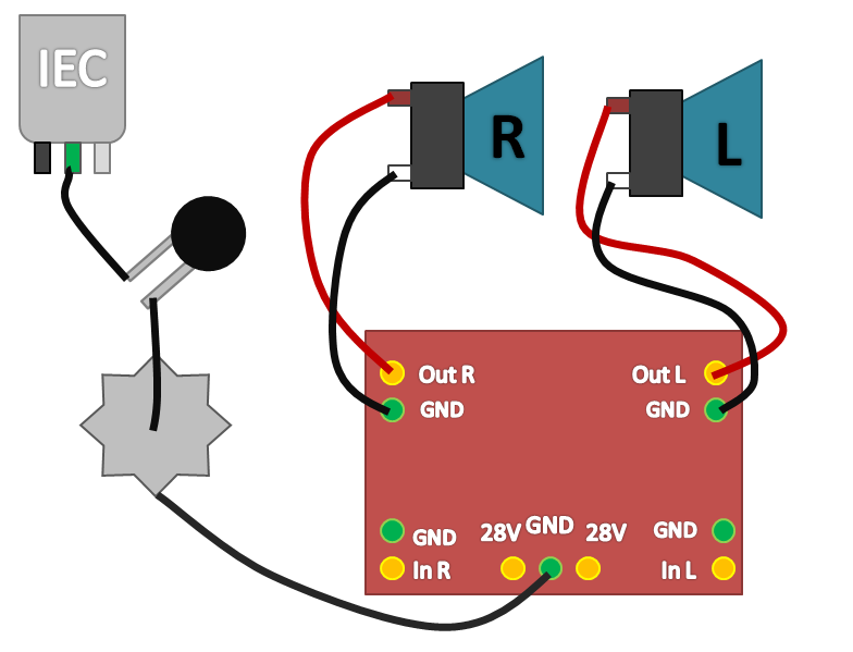

By star ground, do yo mean something like the picture I have attached. And then put a thermistor in line with the IEC prong and this star? (And what should this do?)

Yes, the thermistor goes between the star and the ground lug of the IEC.
If your heat sinks or any other metal parts are exposed at all they should be connected DIRECTLY to the IEC ground lug. This is a just in case safety thing. Should something come loose and the hot mains line touches an exposed part the fuse will blow rather than allow the part to remain hot for you to complete the circuit with your body. It doesn't matter whether the chip is isolated or not.

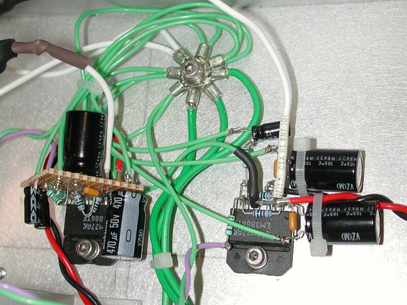

A ground star is better than a piece of sheet metal with various connections. You may find that you want to line your case for EMI protection, in which case that would connect directly to the safety ground.

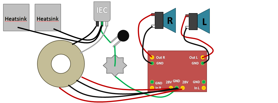

I have attached what I've understood so far. The Output will be going to banana jacks. I will attached a cable from those banana jacks to the banana jacks on the speaker housing. The signal will then run through a 2-way passive crossover, and it will finally get to the speakers themselves.

Heatsinks are going to be outside of the case, so therefore they need to be grounded.
I revised that drawing. Perhaps you could give it a look. I'm still unsure as to where the signal Input grounds go...
You can move the transformer "center tap" to the star, otherwise it looks fine. Does the board include a rectifier (or 4 diodes)? If not that changes your connections somewhat. Note that if your transformer has dual secondaries are both red and black the center tap will be one red and one black.
Assuming that you are using RCA jacks, the center poles are the signal, the shell connections go to the input ground.
Oi! That was my bad on the RCA plugs. Forgive me please.
It does have dual secondaries. I just made the two black to show that they are both going to ground.
The board does have 4 holes for a bridge rectifier.
I shouldn't move the heatsinks to the star should I? Directly to the safety?
