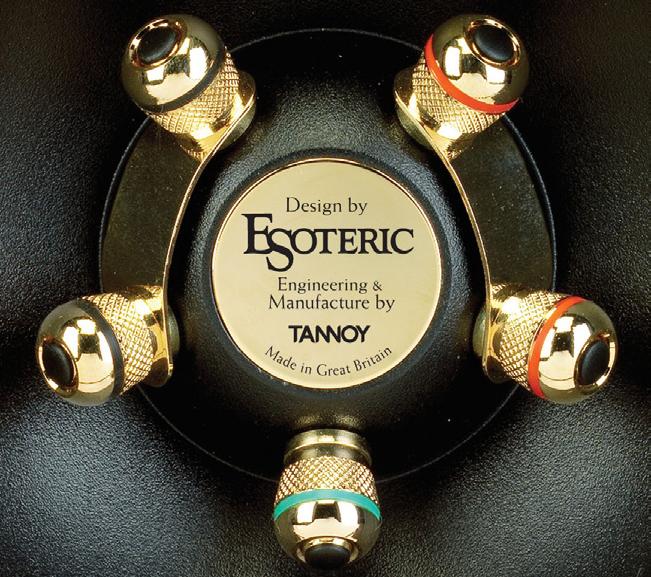

Having reading a number of recommendations regarding the use of “Star” Grounding in the wiring of loudspeaker crossovers, ostensibly to lower noise in the loudspeaker circuit, it appears to me that the use of grounding in the high-level signal path may be comparable to that used elsewhere in the audio circuit (in application, if not in importance). So fa I have been playing around with using a ground plane in the external (passive) crossover enclosure, although I haven’t been able to draw any conclusions so far.
Today, while reading J.A.’s review in Stereophile of the Esoteric MG20 Loudspeaker, I notice that the design employs 5 binding posts. According to the reviewer: “…one pair each for the tweeter and the woofers, and a fifth that grounds the amplifier’s output to the drive-unit chassis…doing so with conventional amplifiers is said to reduce the noise floor by shielding the voice coils from RFI.”.
I'm intrigued and intend to experiment more with this,wondering if the idea of grounding & shielding can/should be extended to include the use of shielded speaker cables and/or running a seperate ground lead from the amp through the (external, in my case) crossover to the loudspeakers...
Anyone else here experimented with this, or have knowledge to share about this topic?

It is because that speaker is built by Tannoy and Tannoys have
a five post terminal block to allow this feature. You do not need
an extra post or speaker cable wire to ground the drivers chassis.
Simply connect the drivers to the negative input.

Tannoy use a separate ground terminal on their own "Prestige" series loudspeakers, as well as the Esoteric MG series speakers, which they make for Teac.
"The Prestige line employ a unique fifth speaker terminal in addition to a bi-wire pair...With the driver chassis grounded via the 5th terminal, and by using appropriate speaker cable, this proven technology ...electrically earths the driver chassis to dramatically reduce radio frequency interference circulating in the hi-fi system. Eliminating this RF ‘noise’ brings substantial improvements in mid-range clarity and further enhances the soundstage imaging."
They imply using either shielded cable or a separate ground wire. I'm not sure how well this works, but for a commercial design they do use good parts(hardwired crossovers, Hovland & Clarity Caps, van den Hul wiring, etc.) and build to a very high standard.

Ground "heaven" for speakers is the storage caps at the power amp. Or in practice the negative terminal of the amp. This as another post suggests bi-wire.
Don't use ground planes on passive X-overs, just causes problems. Besides they don't shield magnetic coupling anyway which is more important here.
To reduce cross coupling and feed thru between drivers circuitry, watch the orientation or better yet spacing between inductors is key.

"About cable "ground":
http://www.AudioAsylum.com/audio/cables/messages/503.html
The point here is that you really can't look at a loudspeaker crossover "ground" as something special and separate from the hot leg, and as if it were to be treated separately.
In fact, by trying to 'star ground' a loudspeaker crossover, you might end up separating the two current carrying polarities (the 'ground', and the 'hot' runs) locally, and thus, increase the inductance, which will actually cause MORE/HIGHER error voltages to occur at the drivers, etc.

2nd, unless the 'shield' of a speaker cable is part of the current carrying circuit, it will distort and adversely affect the EM fields present in the rest of the speaker cable, e.g., throwing a shield over a two conductor speaker cable that is only connected at one end or neither, will cause more problems than any it might be helping to solve.
RE inherently shielded speaker cables, see:
http://www.geocities.com/jonrisch/s3.htm
These cables use the shield of a coaxial cable to carry the current, so they do not cause the problems I speak of.
3rd, running a separate ground wire directly from the amp to the crossover would create a second ground return path (assuming you did not sever the original ground lead current path) which would NOT be paired with the hot lead and thus could not help lower the inductance, and it would also be likely to cause sonic problems from the imbalanced EM fields and lack of inductive cancellation that would normally occur with paired send-return wiring. If you disconnected the original ground, then you would have a separated pair of wires, the original hot wire, and the new "out-in-left-field" ground wire, thus raising total inductance quite a bit, and again, raising the error voltages at the loudspeaker crossover and drivers. Jon Risch "
