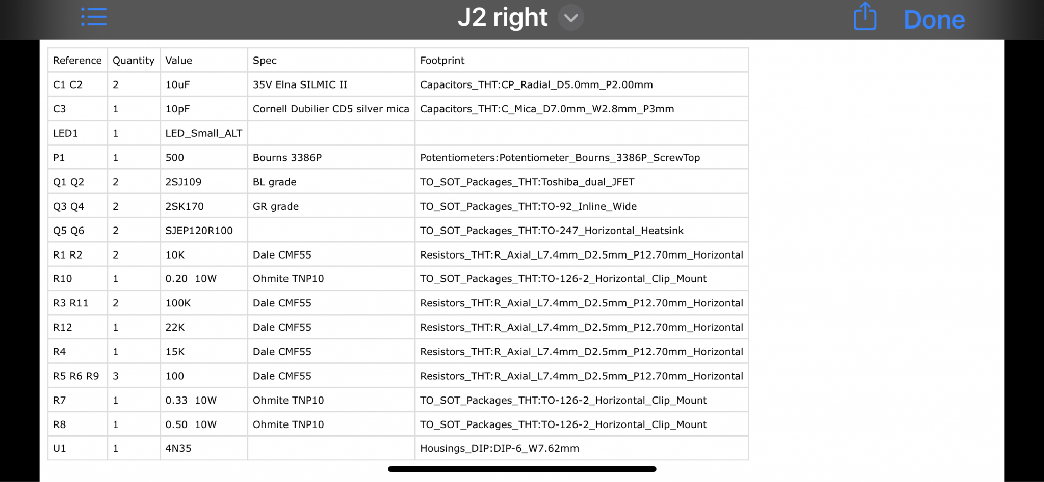

Anyone know if these were called for in Jeff’s long board rendition of the J2?
I’ve had a few pair of his boards along with curve traced Semisouth for a while…thought I ordered all the parts to populate.
I got distracted building a couple of ZM’s Babelfished J2 for a while.
I thought this was his BOM…
