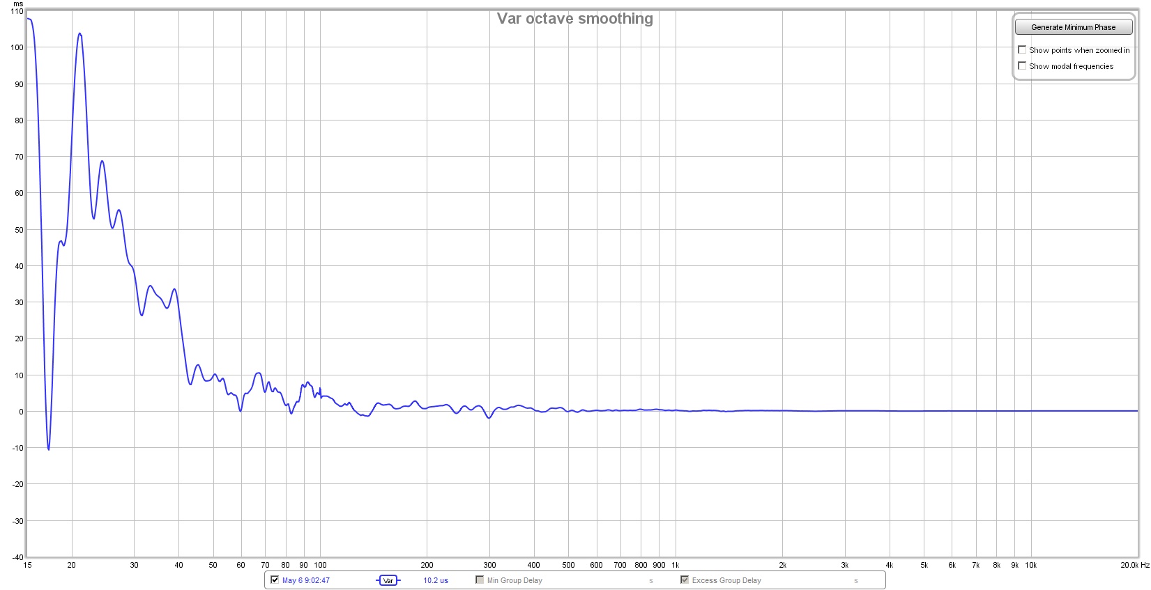

In an effort to tighten up the sound in the bass region, ive been trying to correlate what I hear to what I measure.
Ive been doing image searches seeing what other peoples measured Group Delays are. Then it occurred to me, in what manner are they measuring this? Nearfield? Farfield? What? Certainly the answer to this question has a bearing on what measured results are bad or good.
Here is what I am getting at my listening position (variable smoothing).
If what I read and see on the web is being understood by me, it looks like I am good >42hz. Fair in the 30-40hz region, and not so great <30hz.

Turn on 1/3rd octave smoothing to remove the ripples from small freq response fluctuations. The graph you have is quite good. It is tough to do much better unless you go with an open baffle dipole bass unit. My measurements of group delay in a sealed box match the predictions and for my RS225 in a 24 liter sealed, I get about 8ms at 40Hz with a mild high pass filter and 5.4ms with no high pass filter and 2.5ms at 100Hz. The more higher order EQ and filters you use, the more GD you get. It is tough to get it much lower in the 30Hz region, and really, that region is dominated by room reflections which are in the hundreds of ms so you won't notice it. It is important to keep it as low as possible at the 40Hz-50Hz region as that is where the kickdrum is centered. The timing and rhythm of much rock and jazz is governed by the kickdrum and the 41Hz of the bass guitar.

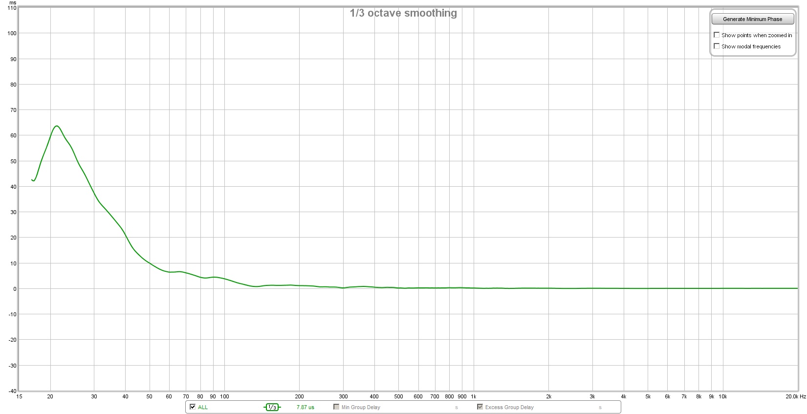

Your GD of 22ms at 40Hz is typical of a bass reflex system. If you want cleaner bass so kick drums and bass guitar are tight, I recommend going with sealed box. Simple sealed box and a decent driver with decent xmax and low distortion motor. That should get you down to the circa 8ms like I have at 40Hz. Use Linkwitz transform if your box driver combo doesn't naturally do f3 of 40Hz.

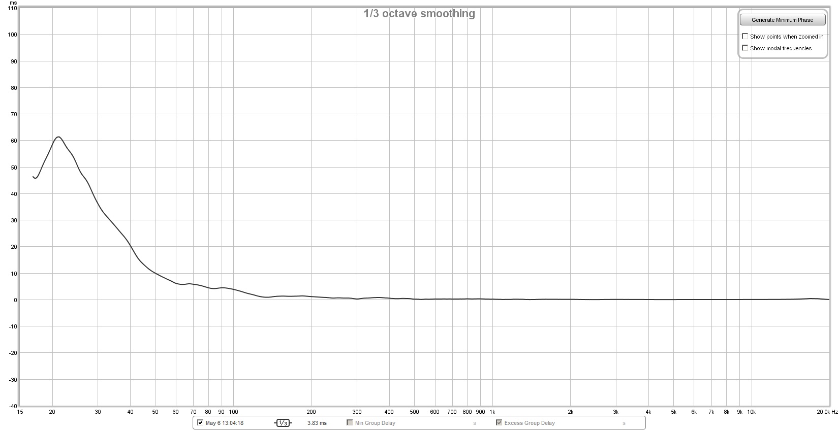

![sub stuffed.jpg sub stuffed.jpg](https://www.diyaudio.com/community/data/attachments/442/442372-a35575243d4196570137fceff5b06299.jpg)
Just for grins, I stuffed the sub port (red). It did help, but not a whole lot at 40hz.

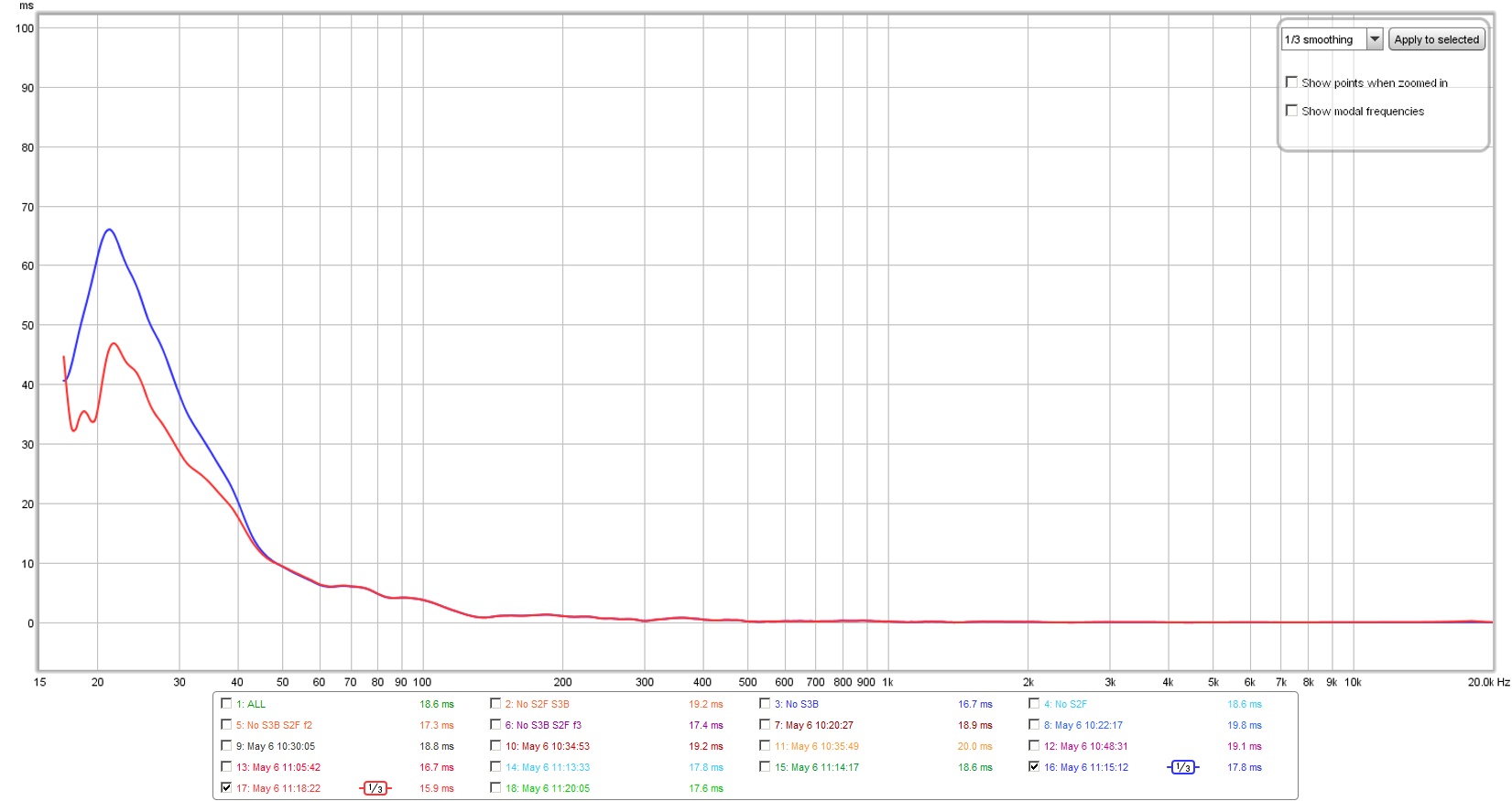

![GD 05 06 new.jpg GD 05 06 new.jpg](https://www.diyaudio.com/community/data/attachments/442/442719-d53723ed6db3dec031ab800872f96ca0.jpg)
Lets go back to this. Which part needs the most work you think? The 20ms at 40hz I am guessing?
Yes, and I am guessing that given you are using ported bass reflex, the majority of the GD is caused by the sub's response at 40Hz (or rather the curvature of the response).

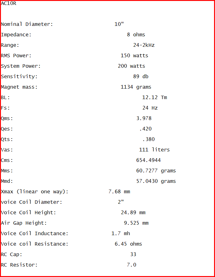

All the subs use this woofer. Sub 1 uses two of them.
![ac10r.GIF ac10r.GIF](https://www.diyaudio.com/community/data/attachments/442/442762-62bc4b4859ff7378f285ff4604726df6.jpg)
Sub 1 is a 5.8 cu ft box with a 4.25" diameter port extended to yield a 22hz tuning.
Subs 2&3 are in sealed 1.1 cu ft enclosures, stuffed optimally to yield about a 1.4 cu ft see size.
