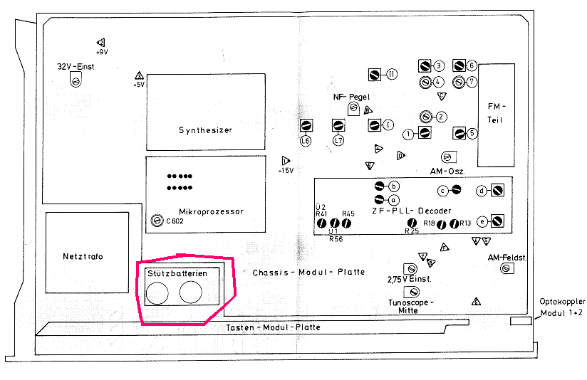

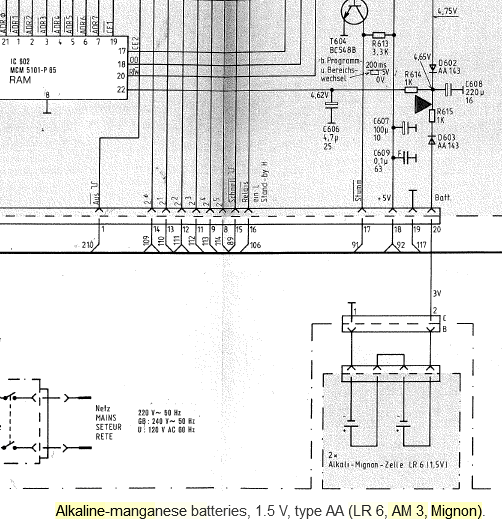

There is an off-drawing wire "batt". Let's see the WHOLE plan.
Grundig T 5000 AM/FM Stereo Tuner Manual | HiFi Engine
Page 8, that wire runs to "2X alkali mignon zelle". My German is poor but I smell an Alkaline battery, and a G-search finds the same phrase as "1.5V AA". TV Remote batteries! That should not be too hard to find in there. And if you never replaced them, they sure are past their freshness date by now. They may even be the Stützbatterie on the chassis layout. Next to the power transformer.

I've replaced the batteries, and have traced the voltage through to pin 22 on MCM5101P-65 chip, so I don't think the back up battery voltage is the issue - I think. This voltage is there when no power is applied to the unit from the mains.

When I type MCM5101P-65 in duckduckgo, it claims it's a random access memory rather than a real-time clock. In fact your schematic fragment says the same. Maybe it's used for remembering station presets, but not for keeping time.

He was looking at a chip which is a RAM, not the clock chip.

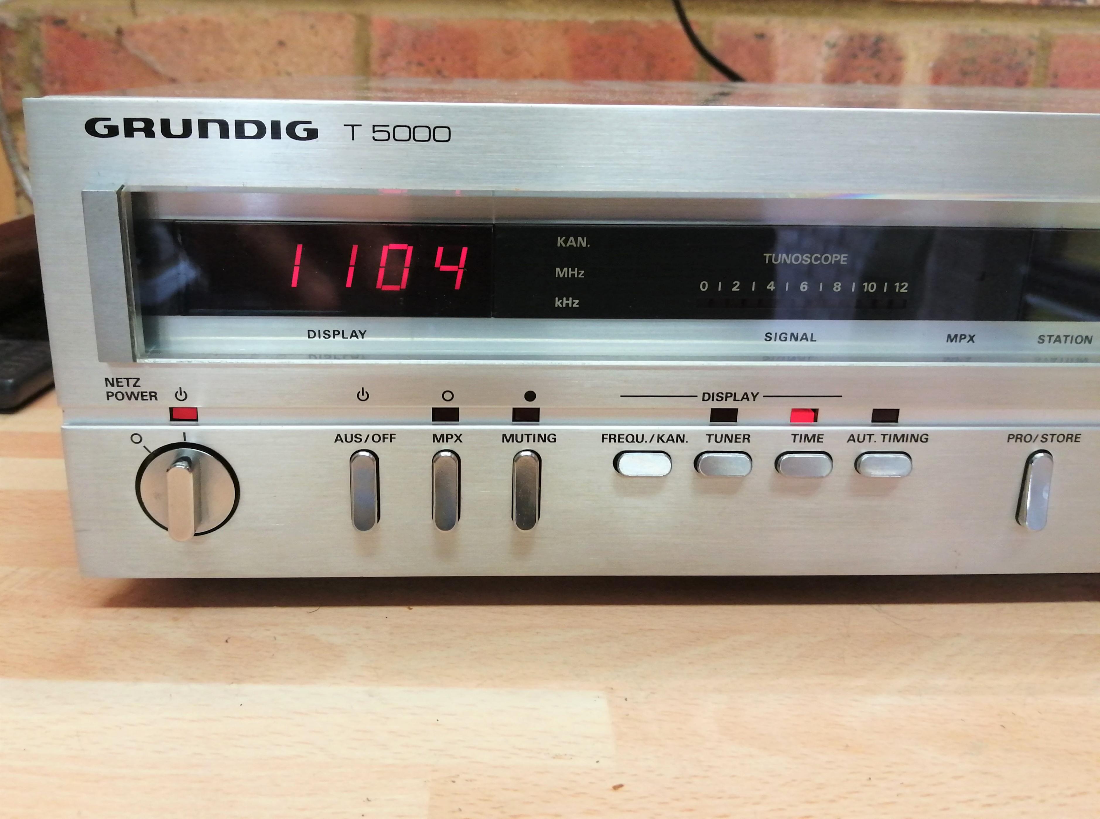

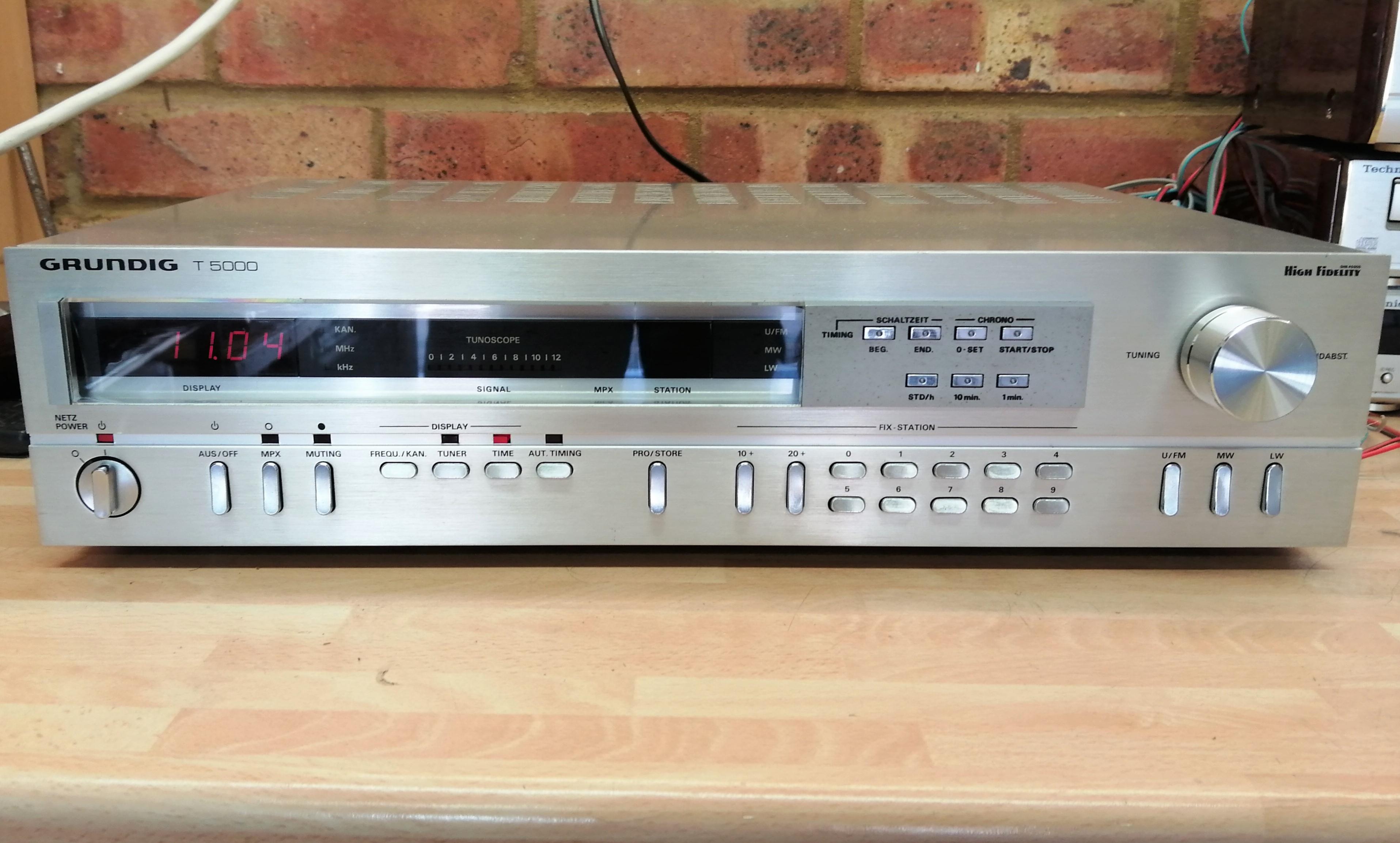

Please see attached pictures below.
I think I might have worked out (without a user manual) how it should work.
Looks like the battery backup (two AA batteries) "might be" just for storing the presets in MCM5101P-65, which someone has said is just a memory chip. So these would be maintained under power cut conditions.
On the left of the front panel there's a switch marked "Netz Power", and to the right of it one marked "Aus Off". I've just been using the Netz Power button, but I think this should be left on all the time, and the Aus Off button just used for turning it off (putting in standby mode)? Without a user manual I can't prove this, but it seems to make sense. If this is correct you would lose the time setting if you get a power cut, or you turn off the Netz Power button.
So maybe this tuner is working as it should be after all.

usually "netz " power means mains power..........
with a dmm in ohm mode - connected to the mains plug- you can measure
the res of the transformer primary , switch on and off "netz power"........
aus/off should be " standby "

Asides from all the discussion about On and Off stuff.......
Killing the AC by the main power switch is going to kill the 50/60 Hz signal to the clock circuitry, so naturally the clock won't be able to keep proper time, and likely reset.

"Netz" can be many things. But we are not catching fish. It is surely "power network". In fact bottom of page 8 is our Rosetta Stone: Netz, MAINS, SETEUR (Fr: sector of a net), RETE (It: net).
Also: "POWER CONSUMATION{sic} Standby 15W, Operating 30W" says a LOT of it stays on when "off".
I do not see this "time keeping area." Is it hidden inside the CPU?
Note that it is not counting 50/60Hz. The only AC off the transformer goes to the display. The CPU of course has a crystal as accurate as a Seiko watch. But the CPU take more power even idle-clocking than a watch, so it has to have Netz power all the time.
