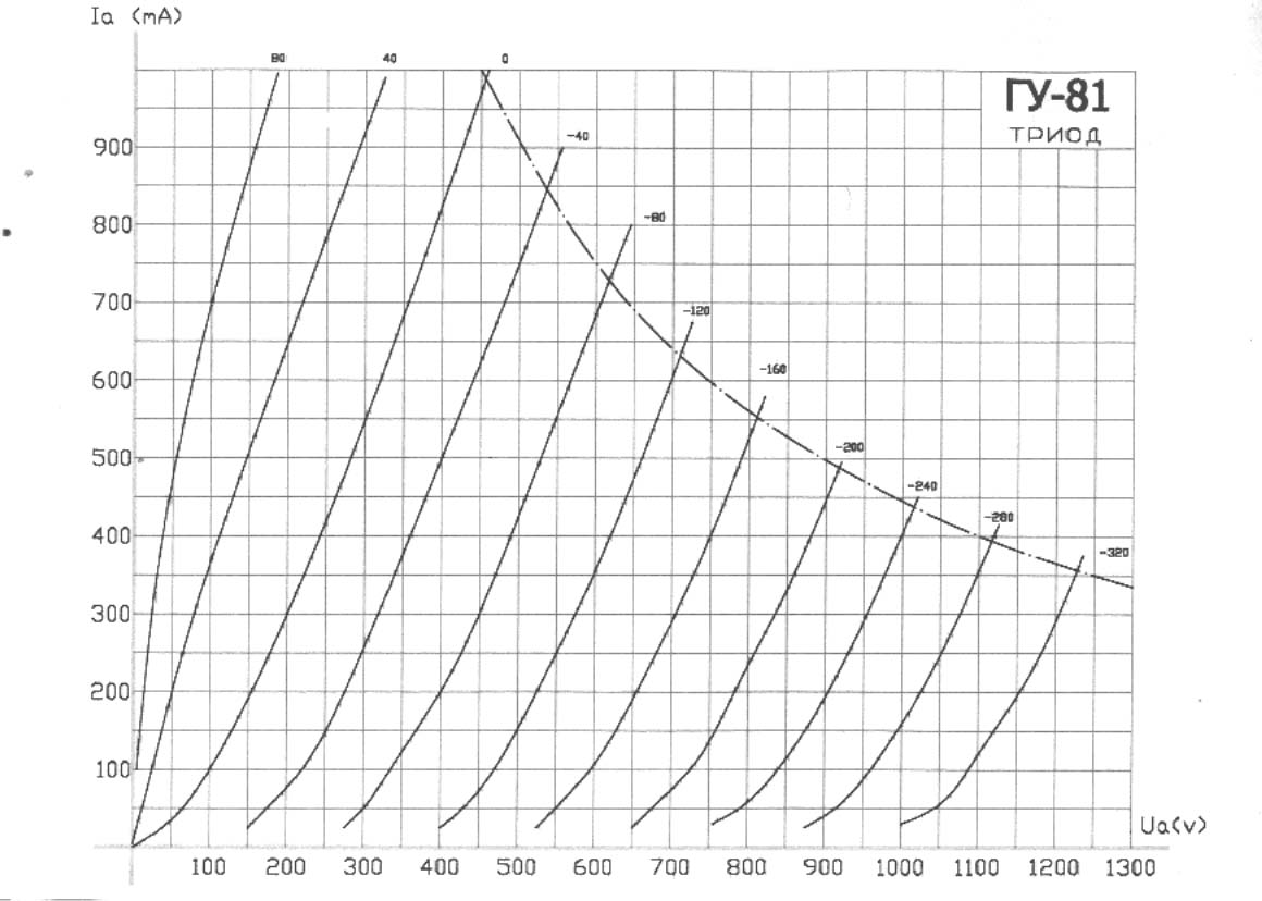

From these curves:
μ = dVa / dVg1 = 130 / 40 = 3.25
gm = dIa / dVg1 = 300 / 40 = 7.5 mA/V
Rp = μ / gm = 3.25 / 7.5 = 433 Ohm
As a cathode follower the output impedance would still be 1 / gm = 1 / 0.0075 = 133 Ohm.

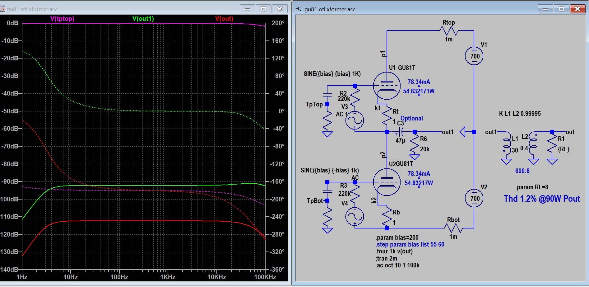

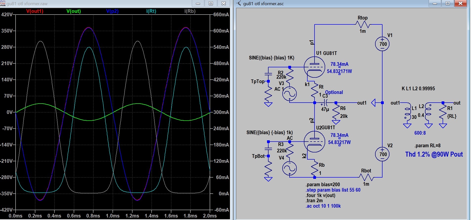

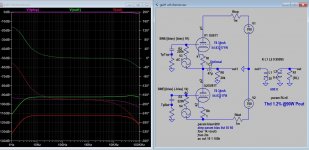

The dissipation of the two triode connected GU-81's is 110 Watt. How can that give an output power of 90 Watt?
Can C3 be an electrolytic capacitor? Doesn't its positive terminal swing more negative than its negative terminal half of the time with signal?
110 Watts is Class A portion, the rest is B portion, peaking at 600mA or 400W some go to output, the rest is dissipated as heat. See attached for more info.
The output where C3 is connected should be < 100mV offset, even at full output. It may be a problem if the top bank is fused off and C3 connected to -ve rail. But there is how every otl (include solid state) will use to block DC.
90 Watt output power from two triodes dissipating 55 Watt each would mean an efficiency of 82 %. As far as I know, that is impossible.
This is Class AB amp, does not not need same dissipation as Class A, it only needs enough idle current to overcome cross over distortion. E.g.Tim Mellow OTL is Class AB, only dissipate (150*0.15) 22.5W, the output is 25W.
You sound like you're talking about a pure Class A amp.
OK, thanks. My fault.
What would happen if the two GU-81 are not completely matched? Would the offset at the positive terminal of C3 stil be 100 mV positive with respect to ground?
No, the offset would be more than 100mV, +or- depend on Mu or now the gain/loss of stages. It can be manually corrected by readjusted the bias until it's <100mV. Or can be auto-corrected when the entired amp has DC servo system built in (e.g again Tim' OTL) which sense the output terminal (looking for 0V or so). Having said that it does not mean that the mismatch issue is completely solved. One of the tube will start to clip earlier for example or offset detected when there is output power delivered to the load. That may be solved by negative feedback to correct gain of the stage.

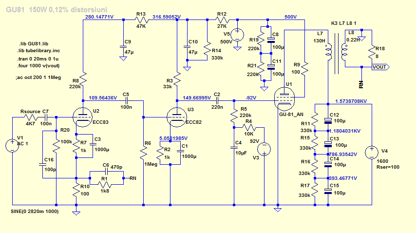

Very interesting, I'm thinking totem pole is possibly the way to go. Looking at he curves I took a quick guess at an operating point within my limits. Even a single gu81 in class A appears to hit my power output target. 👍 Now onto the totem pole arrangement there's an opt transformer (which I do like for isolation and safety) 600ohm to 8 ohm opt, am I correct? I wonder if this would have an acceptable frequency response? Looking at totem pole the power out is great, correct me if I'm wrong but 1ch could make 100w+ and consume 750w
DC offset through the opt transformer. Am I right to think that in totem pole it will be tiny based on 100mv (this would make the opt fairly small )
In that configuration, you could capacitor couple the trafo and then not worry about offset or drift. You can even bridge two amplifiers.
If you‘re not opposed to using sand, you could implement a bias servo. It wouldn’t be handling the audio signal, just nulling out any offset.
Ireally like the idea of no DC in an opt transformer as it opens up lots of options. But +-700v gives the PSU a big potential between rails. I'm thinking psu layout safety. Going back to my thread starter I'm going to lean hard on building a single tube class A amp as it's clear I'll get over 20w. Having DC out of the opt is high on my list. Parafeed? or up run It as a pentode in ul and use big iron? I'd be hoping for very little distortion under 20w as honestly everything really relies on the first few watts.
Me too also scare of voltage over 500V. But not everyone agree why one should stick to +-700V. It can deliver more than 30W with +-300 rail, or a total 600V. With SE amp you need about the same, I think about 500V on g2. Remember if you want more power with this tube drive it into A2, that should double the output power. Attached is Class A, can mod to A2, but I don't agreed everything in the snapshot (not mine): 150W?,in pentode mode.Ireally like the idea of no DC in an opt transformer as it opens up lots of options. But +-700v gives the PSU a big potential between rails. I'm thinking psu layout safety. Going back to my thread starter I'm going to lean hard on building a single tube class A amp as it's clear I'll get over 20w. Having DC out of the opt is high on my list. Parafeed? or up run It as a pentode in ul and use big iron? I'd be hoping for very little distortion under 20w as honestly everything really relies on the first few watts.
You can do para feed so you can use PP type OT, need to use suitable choke to drive the OT with sufficient current more if into A2.
The (im)possibility of an electrolytic capacitor as C3 in the schematic in post #7 keeps nagging my brain.
For AC current to flow at the output, there must be voltage swing, or? If so, than the voltage at the positive terminal of C3 has to swing up and down, or? Since one side of the output terminals is grounded, the swinging will take place around ground potential, or? If all this is true, than the positive terminal of C3 swings both positive and negative with respect to ground, or?
If the above is true, how come that an electrolityc capacitor can be used as C3? I thought that the positive terminal of an electrolytic capacitor should always be positive with respect to the negative terminal, also under signal conditions.
So what am I missing. Am I wrong about the workings of the schematic? Or about what an electrolytic capacitor can withstand? Or am I wrong about both?
