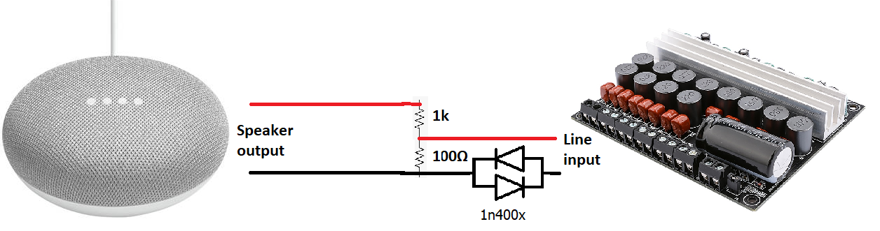

Leadbelly and PRR, I should have given more details. Apologies.
So I cut the wire going to the speaker, and then put a resistive divider across it which uses values of 3k and 33k. This reduces the max output of the Google Home mini to around line level. I got this information from this YouTube video: I DEFIED GOOGLE 😱 Hacked an Audio Port onto Google Home Mini (Mod Kit Available) - YouTube
The output cable which is going to the amplifier is across the 3k. Just rewatching his video, he uses a 300ohm and a 3K. I wonder is this why I have trouble? I wanted to use high value resistors to ensure they wheren't generating too muich heat...
Another difference between my version and what is done in the video is that I have not reconnected the speaker.

I want to give you all the information I can so we can try and find a solution, but I'm not really sure what you're looking for...
I just did a quick mspaint of the resistive divider. Can you tell me what else you need?
https://i.ibb.co/rmTdpt4/Untitled.png

Is it literally just the 2 unshielded wires to terminal blocks? No enclosure? No jacks and plugs? No other connections to other inputs? Power supply grounding?

@Leadbelly:
Literally just the connections above with one terminal block. Nothing else connected.
I haven't detailed the power supply now that you mention it.
The home mini is on it's own 5V power supply which is powered from the mains and the amplifier is powered from a meanwell 24v PSU. I know the 0v rail between these two could differ and it would be probably better to derive a 5v DC supply from the MeanWell supply for the Google Home Mini, but it seems to work fine except for when the Mini goes to sleep.

Just something like this:
It sometimes helps if there is a grounding issue, sometimes not. Either way, the diodes are very inexpensive so I usually give it a go.
The issue may just be that the leads you are using from the Mini to the amp are picking up all the radio garbage, which is then being amplified.
Shielded cables between devices are a good start.
