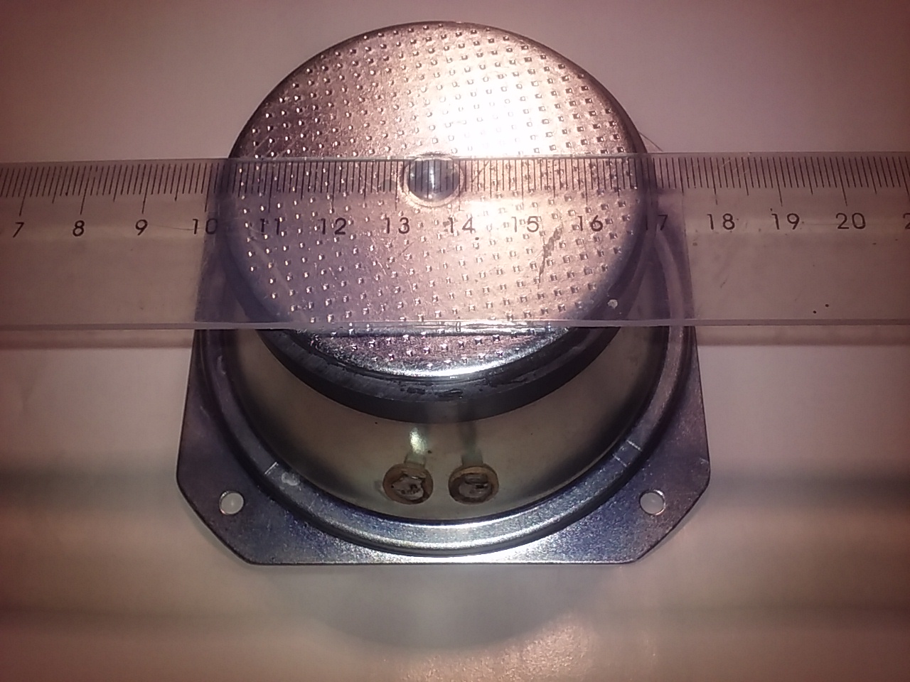

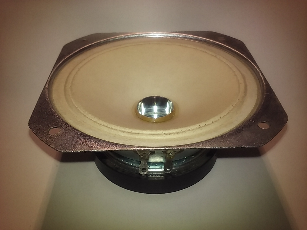

Those are cone Tweeter sized magnets, 63 mm; tiny to begin with and even worse if supposed to help reproduce a Bass Guitar.
You can easily fit 73mm and even 86 mm magnets in a 4" frame, leaps and bounds more magnetic "power" available, not sure why they chose the tiny ones.
But always your best option is to install external speaker jacks and drive "real" speakers with it.

As of considering magnet size small, specially in a full range Guitar speaker or even more, a Bass Guitar one (even if intended for desktop practice), my comment came because I use a 73mm magnet in my own *Tweeters*, go figure.
Admittedly a beefy one, a 4" cone unit, intended for biamped Bass, Acoustic Guitar, Keyboard or mini PA systems.
