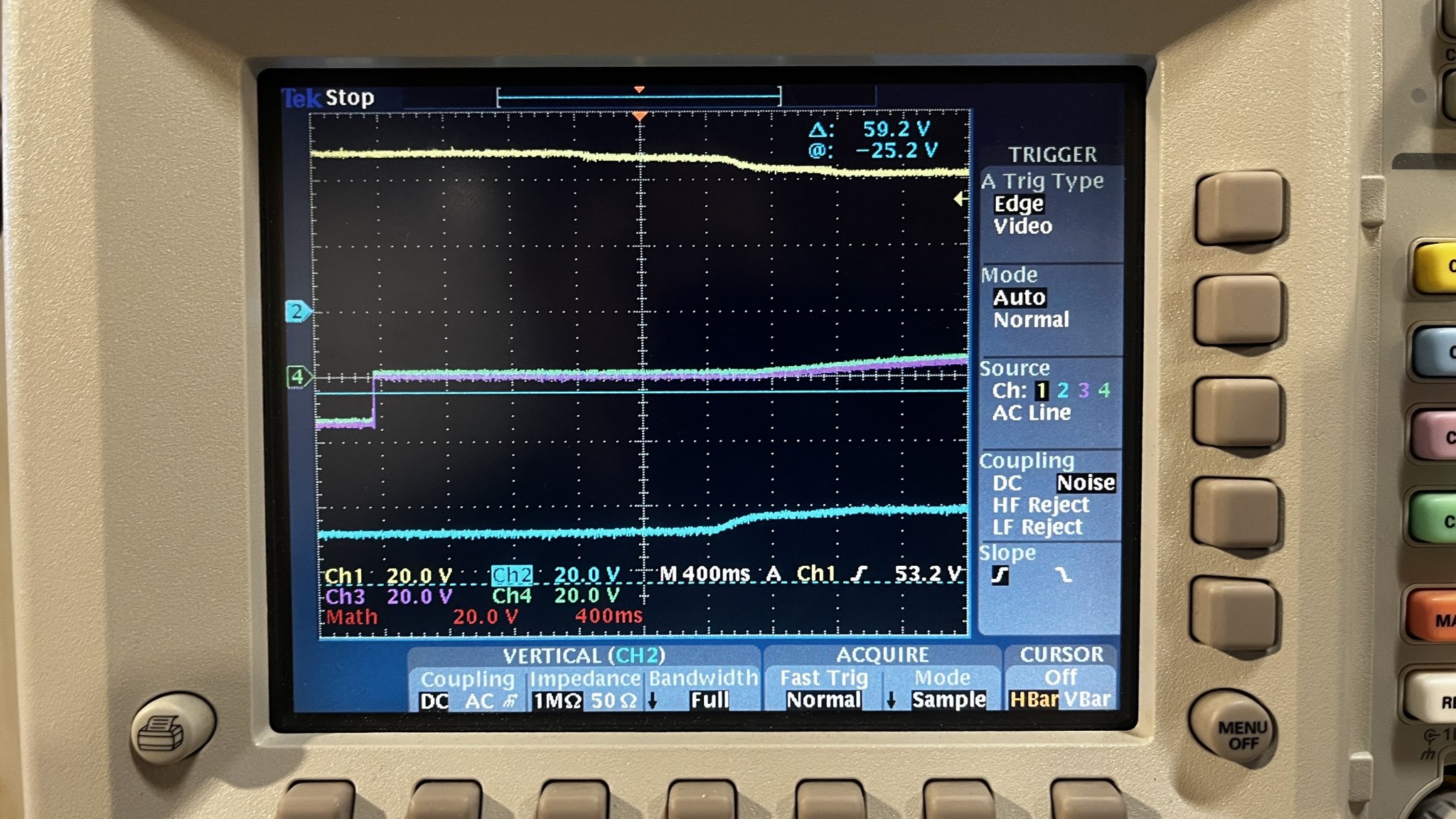

Hi everyone, I recently picked up a Hafler 9180 that is sending HV DC to the right output during startup; amp is in great physical shape otherwise. I'm hoping to get some opinions on my debugging before throwing new parts at it since this is my first experience with a soft start.
From what I can tell, the voltage is coming from something turning on too early, shown by the first dip in the yellow trace at node 1 in the schematic versus the one big voltage drop in the purple trace at node 3 when the soft start comparator trips and turns everything on. Interestingly, the drain of the Q22 PMOS that turns on the input stage drifts down toward the - rail when the amp is turned off as does the cascode stage shown in the blue trace, while the drain stays close to 0 V; these both stay close to 0 in the left channel. I'm thinking this may point to an issue in Q7 or 8, but they seem to be testing okay, so my next thought was there might be too much channel resistance in Q22. Pretty much every component I have probed so far, including passives, tests the same as the working left channel. This amp doesn't have the substrate bias passives since it has the discrete components not the dual JFETs. The diodes between Q14 and 15 seem to be holding the bases ~3.8 V apart, which is a bit higher than the left channel. Adjusting the bias from ~260 mA to the recommended 230 mA for both channels didn't noticeably change anything.

That said, I'm having trouble making sense of the scope traces. Any chance the scope ground is tied the the amp chassis? Do the traces change if you connect scope ground to speaker ground binding post?
If I understand your description:
ch. 1 (yellow) is node 1 in your attached schematic, base of Q9 ?
ch. 2 (blue) is node 2, base of Q14 ?
ch. 3 (purple) is node 3, base Q10 ?
ch. 4 (green) is node 4, source of Q22?
Would you confirm or correct? Would you note where 0V is positioned for each trace? What is time/div of sweep?

The scope ground was connected to the right output terminal ground for those traces, I can double check but I believe it was just a small offset when connected to chassis ground, no noticeable difference in the behavior.
The traces/nodes you mentioned are indeed how I had them hooked up, I had to start numbering the nodes to keep track of what I had looked at. In that picture, all of the traces have 0 V at the center division with 20 V/div, and the time there is 400 ms/div. The amp is turned on at the sharp rise in the yellow trace and switched off again when it starts the linear descent, so that negative voltage on the source of Q22 persists through the startup.
Additionally, node 5 at the base of Q15 does the same thing as node 2 during startup, only offset below by a few volts. If I let the supply caps completely discharge before switching on the amp, the negative voltage at Q22 is reduced and the output will only swing up to about 20 V or so, but with any voltage remaining on the caps it will swing basically to the rail.

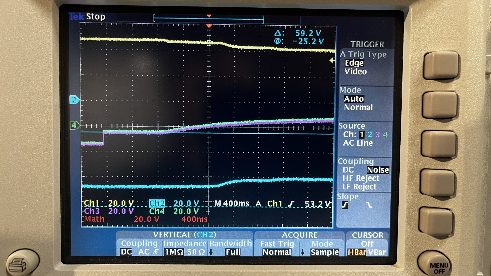

I've been playing around with shorting those pins and removing the jumper to see what happens. I'm noticing that on the left channel, point B on the schematic shows that -6 to -8 V offset at 1 div and turns on too early corresponding to the first dip in node 1 in the first image, versus the right channel staying at 0 V and turning on at the right time in the second image. The green trace is at B and the purple is on the other side of CR7.
Measuring DC voltages while the comparator is shorted, the only thing I can find is that Q22 source and drain are at ~-1.5 and 1.5 V respectively on the left channel, whereas the right has a bigger drop at -6 and 3.5 V respectively. I checked R42,43, CR7, and C20 and they all test within margin, and from what I can tell the same current is flowing through R8 and 9 on both channels.
