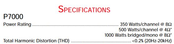

Why the distortion numbers are that high for that amp ?

If you are referring to this <0.2% THD, I wouldn't worry too much.
This was probably done at full power into load at 20kHz.
At 1kHz, the THD is much lower.
