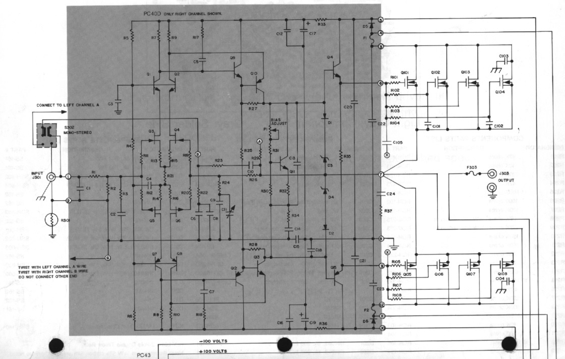

I have had a Hafler XL-600 amplifier in my system for about a year now. I bought it off of Craigslist from a local seller who was the original owner of this amp. It is super clean and is about as close to new as you can expect from a 20+ year old amplifier. The only thing it really needed once I got it home aside from cleaning the fan blades off was to adjust the output stage bias. However, being an avid DIY’er I can never leave well enough alone.

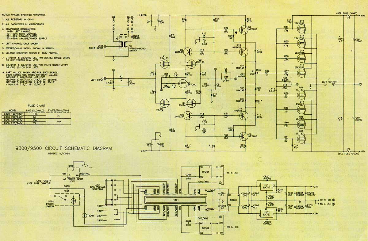

I know that the later generation 9300/9500 amplifiers were very well regarded and highly reviewed back in the 90’s. Not that the XL series was any slouch, but they didn’t seem to have the same reputation as the later gen 9300/9500 amps. I started wondering what the differences were between the older XL series versus the newer non-balanced input 9300/9500 Hafler amplifiers. After examining the schematics [which are attached] for the XL-600 and the newer 9300/9500 it looks as though the main change was a simplification of the predriver circuit. The later amps gained generic 3 pin 24V regulators to the DC rails and the elimination of several parts including the cascode transistors (did I identify that correctly?). This offered “regulated” DC rails in the later 9300/9500 amps.
After thinking about it for a while it seems it would be reasonably simple to construct a PC 40 replacement board based on the later 9300/9500 predriver and marry it to the XL-280 or XL-600’s output stage. In fact I’m sure it could be used for the DH200/220 output stage as well although hI have not investigated it. From the schematics it appears that the output stage between the earlier XL series and later 9300/9500 generations of Haflers are identical except for the fact the DH and XL amplifiers used the more rugged metal can TO-3 devices, which I much prefer. I know that the XL series input differential SK163/SJ74 JFET’s have been obsolete for a long time, but the original JFET’s could be carefully removed from the working original PC 40 boards and installed into a new board. Not to mention that there are still a few sources for matched 2SK170BL/2SJ74BL devices albeit at a premium.
Aside from the JFET’s the other components in the 9300/9500 predriver all look to be easily sourced and cheap. I was thinking that a simple zener + emitter follower regulator could be integrated onto each board so each board would have its own dedicated +/- regulator. The zener + emitter follower regulator would also have a much lower noise floor than the standard 3 pin variety used in the 9300/9500.
I know based on other threads here that others have modified and changed the front end of the old Hafler amps over the years, but I haven’t seen anyone that has done this type of upgrade. Musical Concepts offers their PA-4 kit, but at a very hefty price. I think that these updated PC-40's could be built at a cost of < $100 even with having to go and pay a premium for the input JFET’s. Without the cost of the JFET’s I would think these could be built very cheaply at < $50.

One thing that I do not like is the reports I have seen of overheating on the 9300/9500 boards around the output mosfets and trace failures as a result. This seems like some marginal engineering was at work here. Due to this fact I would be quite leery of buying one without being able to inspect the main board.
Just wondering what others thoughts are on this possible upgrade for the PC 40? Would it be worthwhile? If it is a worthwhile upgrade would anyone be interested in some bare boards if a small batch were to be built and sold at cost?

Transnova requires two transformer secondaries.
Good point!
Options,
1) A new 25 VA toroidal is $20 from Mouser.
2) A higher voltage rated transistor (i.e. 2SC5171) could be used in the zener emitter follower to drop the 100V rail down to 24V. The CB voltage drop would be around 75V so a resistor of around 5W would be needed in that location which would eat up some board space. Plus decent heatsinks would be needed on the transistors.
In the end, option 1 would be the better solution even though it is more expensive. Isn't that the way it always goes, the more expensive solution is the better one!

I am not looking to copy all aspects of the Transnova, only the front end. Trying to recreate the whole circuit would be too costly. I was just going to stick with the XL-600's original single secondary x-former with dual mono rectifier & filter capacitor setup on the output stage.

Yes that is the one. Same PC40 front end as the XL280 and 4 pairs of Hitachi outputs per channel with 25 volt higher rails. Basically it was what evolved out of the DH500.
