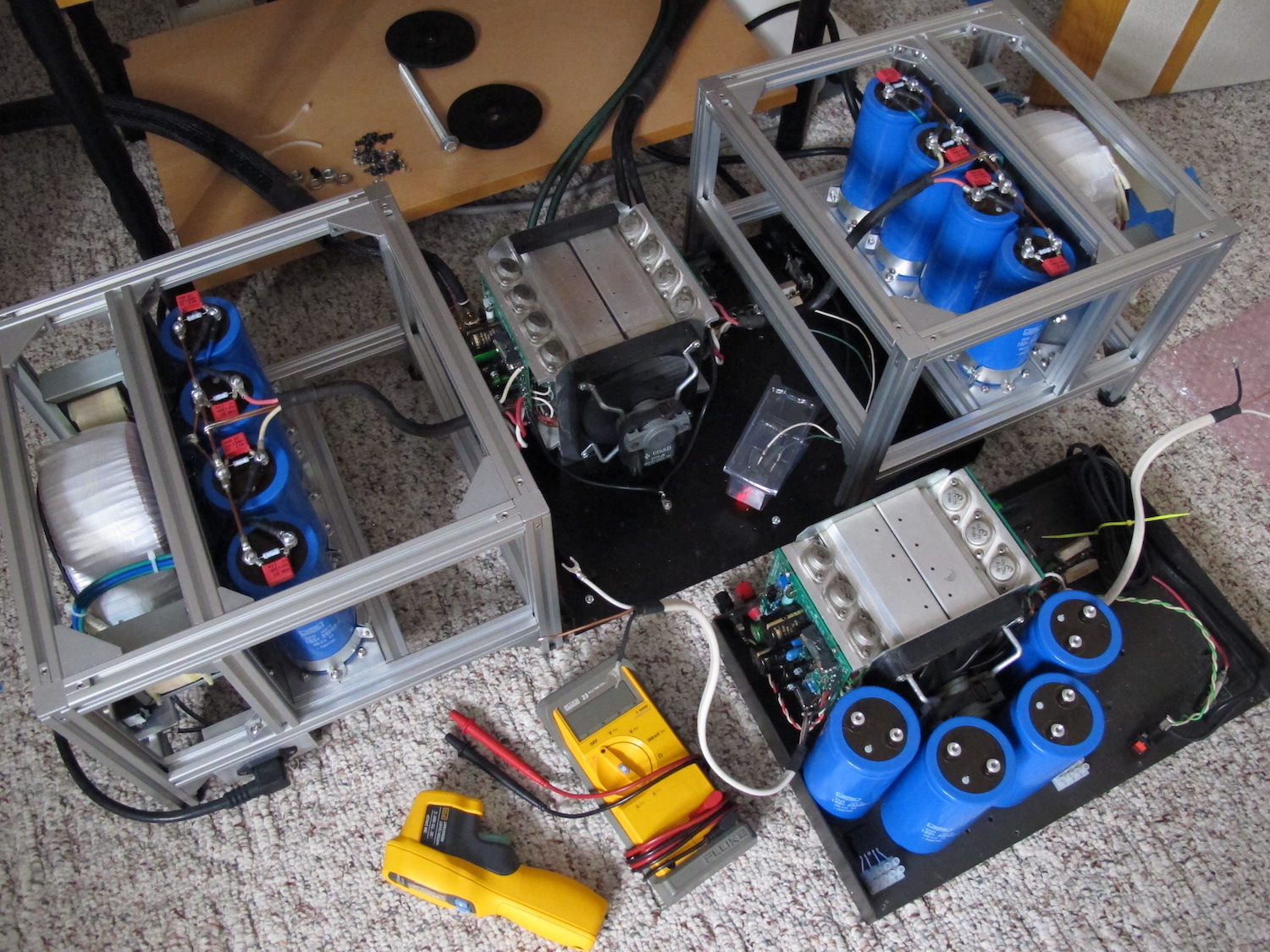

Quite frankly, I was disappointed after purchase of my XL-600, in stock form. I have many Hafler amps, all 11 are modified, I currently own 3 DH500s, in various builds, doing direct comparisons to various circuit implementations, working to establish a clear hierarchy of changes and benefits of each.

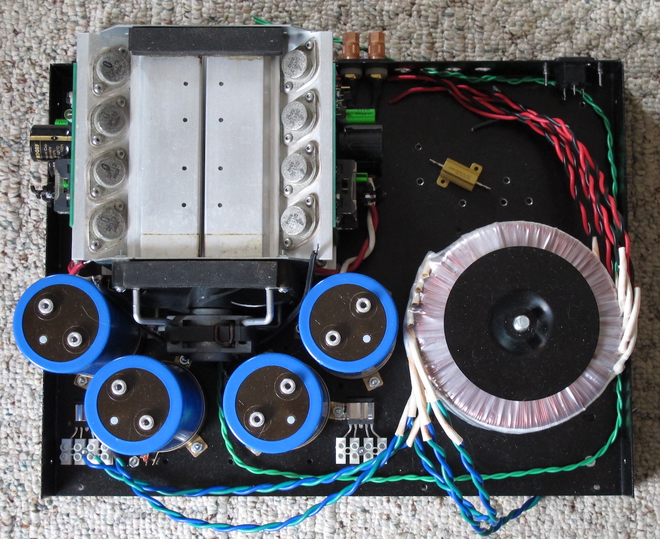

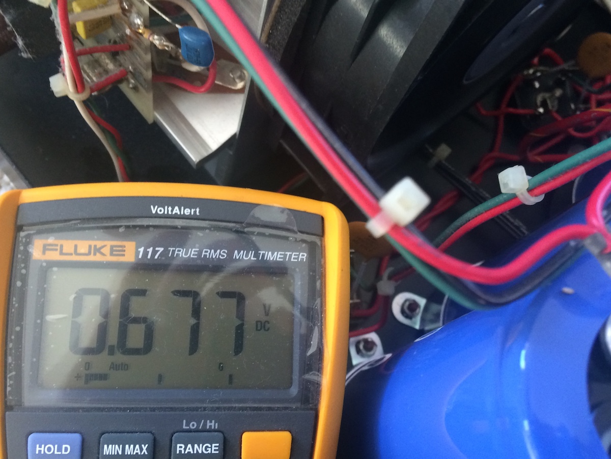

I can speak directly to this... I have extensive experience with stock and modified XL-600/XL280s. The biggest "problems" is that there are no DC off-set adjustments on the stock PC40 driver boards... and the front end FETs are not available, a very big deal. I would check the DC offset before connecting to .any. speakers, that you care about. To me, the stock PC40 are 'useless', bordering dangerous.

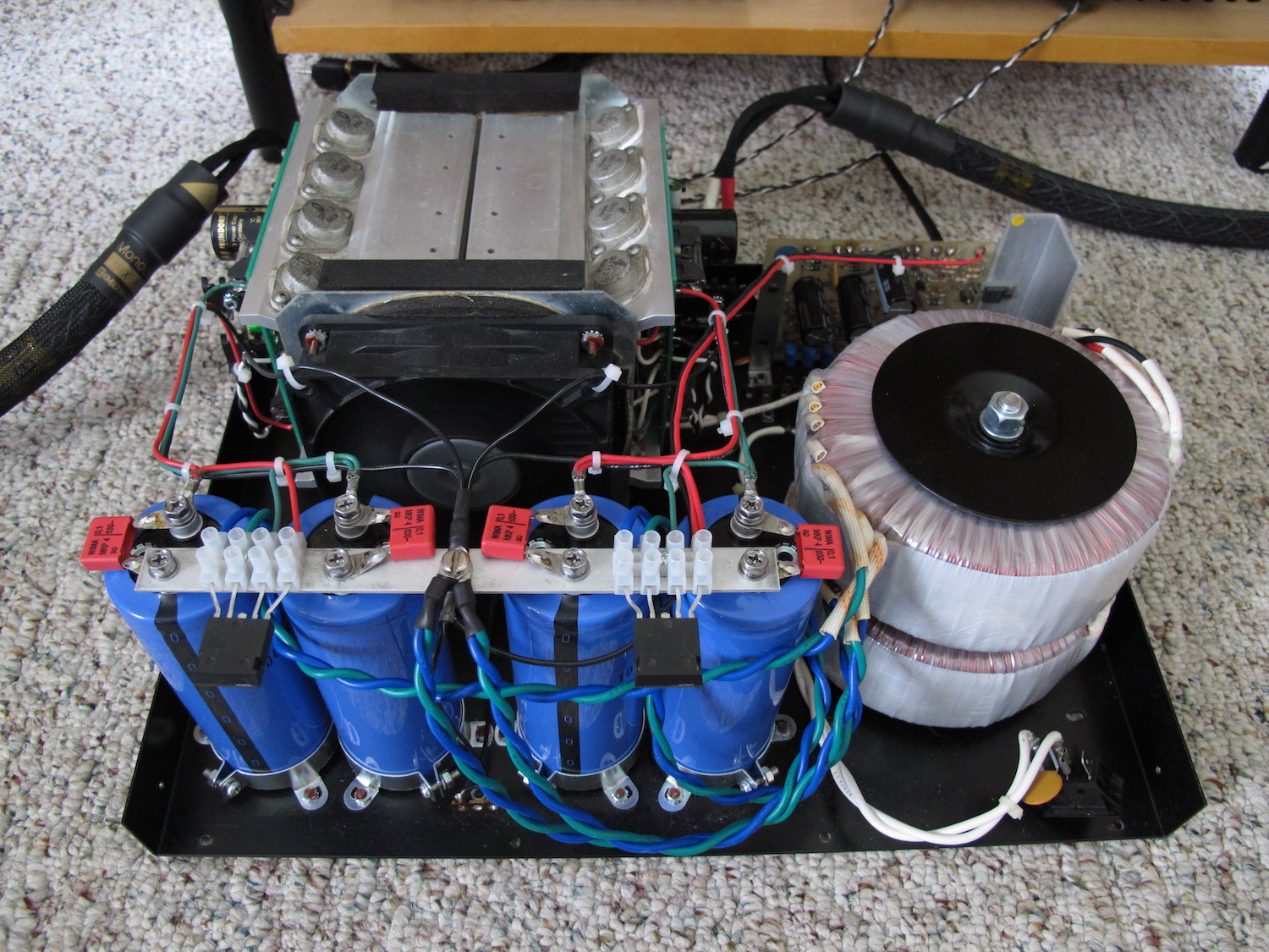

The single (all be it) fairly big power (~600 va) transformer, like the DH500 is it's Achilles heal, has proven to be a very big limitation, image 2. They are *not big enough*, for such big amps, constrict the sound. The next is WIMPY / very small gauge stock wiring, in-line fuses and protection relay adds to that (a whole other topic and thread) For note: the 4 P/S filter caps, make for easy dual power transformers and dual bridge rectifiers... The aluminum ground buss (image 2), leaves little to be desired, need to be changed.

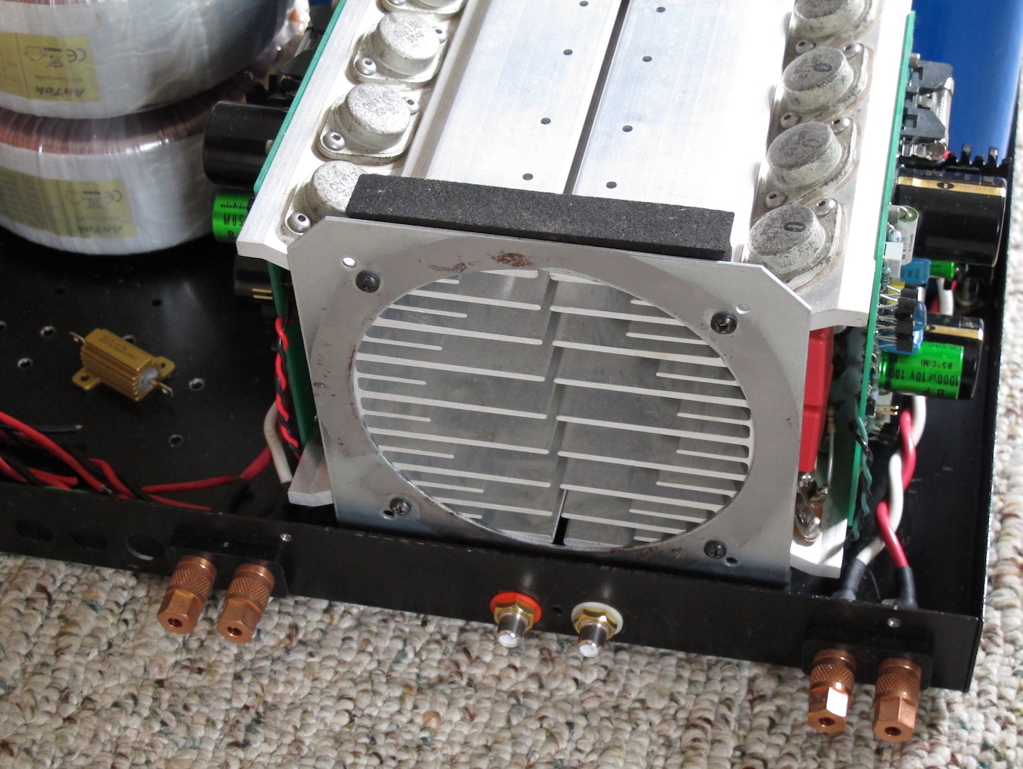

The Musical Concepts PAxxx driver boards, pretty much transform the amp, a "bigger" / dual P/S renders the benefits further. I have been on the fence about selling my Magnepan MG3.5Rs ~ until hearing a reworked XL600 power them... never heard my Maggies sound like this in prior 10 years of owning them.
I always wanted to put Cardas hardware on my amp, but hierarchically, the budget, was better served with (went towards) dual HEX-FREDS, toroids, the list goes on. In the 3 / 4th iteration... this was done while the entire chassis pan was bare... Still trying to reason my wiring in image 3...
Lastly, testing both 500/600 chassis with these massive CLC supplies [blows my mind] the amp(s) keep responding to every single 'improvement' that I have made. After testing, I am "converting" these amps module back to stockish, inside of the box builds.
I cannot say enough great things about the Musical Concepts PAxxx driver boards. That said I will eventually try one of Bob Cordells amp design... but for now (for that matter, the past 40 years) MC offerings are a known quantity. I have compared them to "big name" SS and vacuum tube designs, they are truly remarkable. *Rowland, Levinson and Spectral - (TC) ARC, (OTL) Futterman and Atma-Sphere = all lofty comparisons.
**I am not suggesting any / or all of these $$$ changes are of interest or practical... I simply relating direct experiences, while am in a test phase, in building "my own" amps from scratch, using the "Hafler power modules" / heatsink and out puts, to test power supply implementations.
