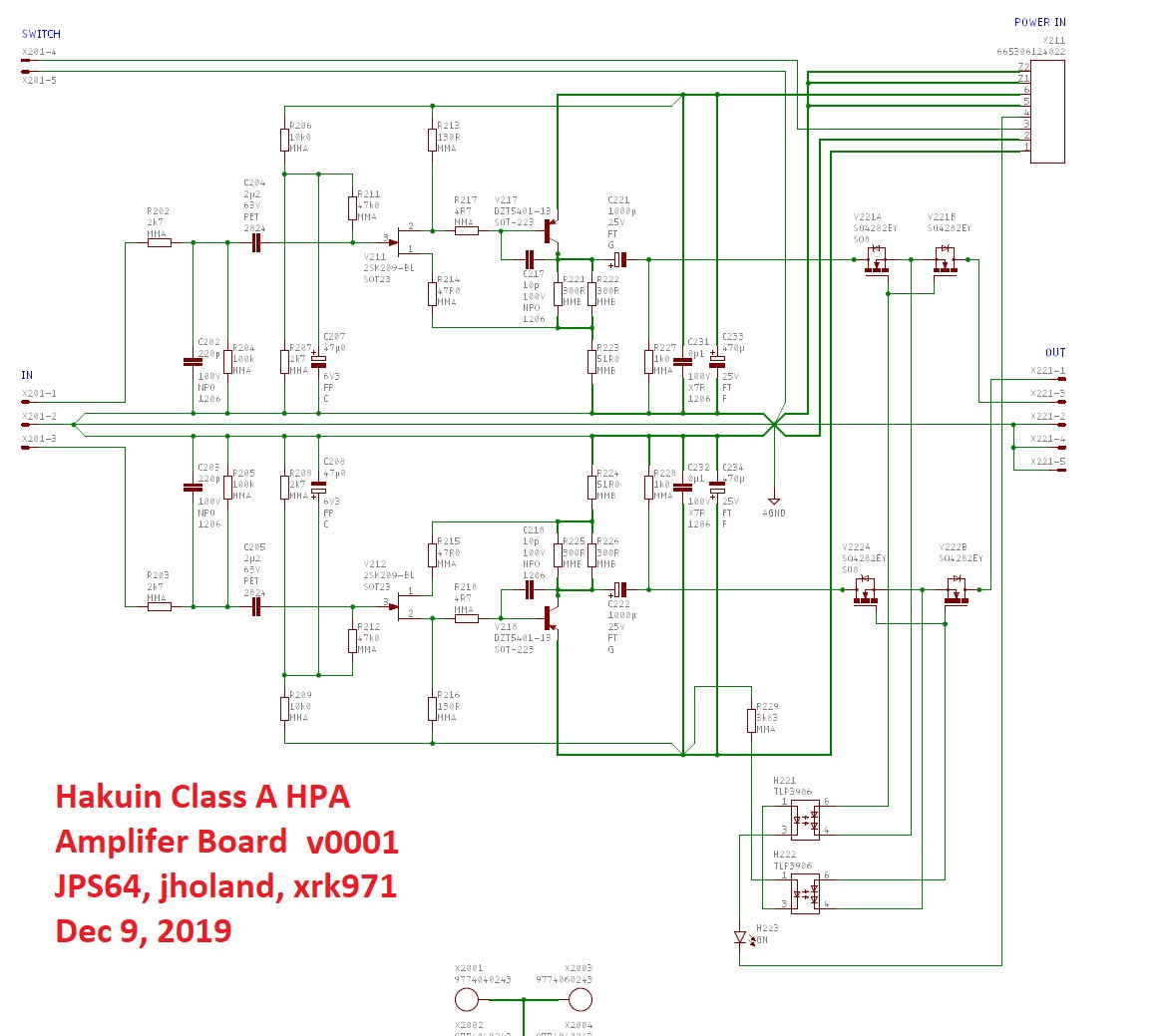

Here is the LTSpice schematic:
The predicted harmonic profile is dominant 2nd order, with a small amount of third order distortion, and not much else. Driving 250 ohm headphones, this amp will produce a very musical, immediate presence, and with superb resolution and dynamics. I have tested it out with a BF862 and 2SA1837. Both un-obtanium, so now redoing it with easy to find parts. The overall THD will be a bit less than the previous JFET-MOSFET version.
With the help of JPS64, who put into a compact PCB, the schematic looks like this, now with some RFI filtering and in stereo:

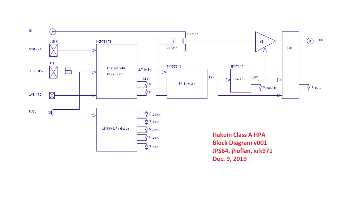

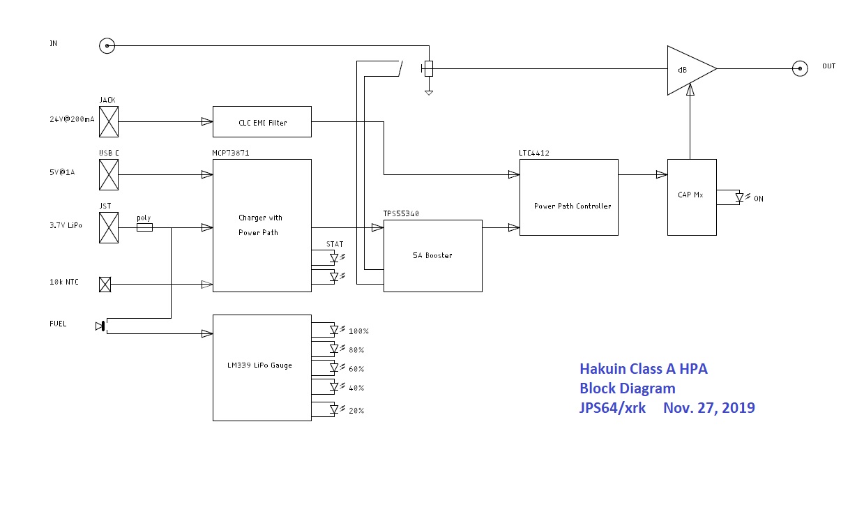

This will still be a pocket amp, but this time, we are making our own power system with LiPo batteries, a battery management system, DC-DC boost converter, SSR for power on/off, capacitance multiplier for soft ramp up to avoid pops and reduce noise, and a battery gauge meter with LEDs. Here is the block diagram (Edit - updated 11/27/19):

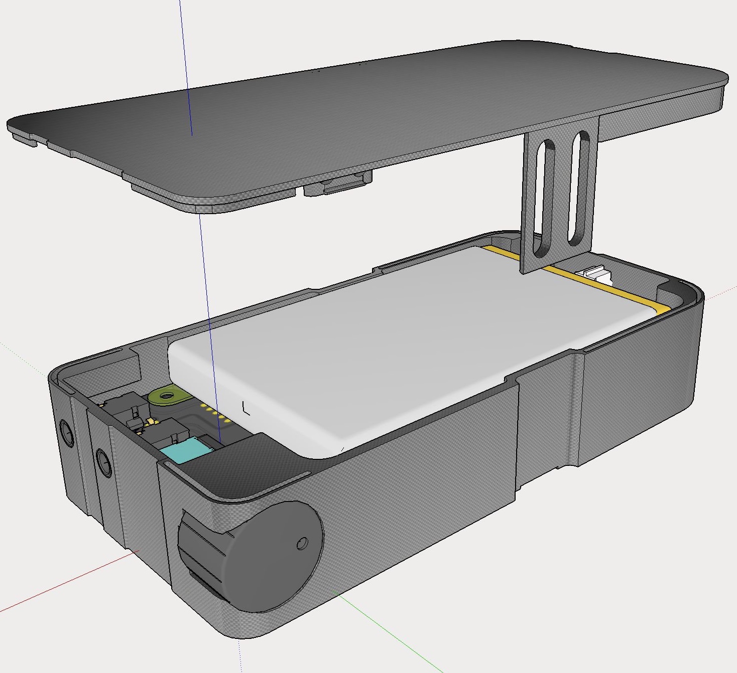

If we make a continuous carbon fiber filament 3D printed case using MarkForged Onyx nylon, we can have a case that is stronger than aluminum.
The material may have better thermal transfer too for the bottom heatsink.

After some discussions with the team, we are going to change some items in the power supply section. Probably go with a TPS7A4xxx 4uV rms LDO instead of a cap Mx to clean up the power supply and preserve battery life. Also switch to a SSR for swithching on/off the output to prevent turn-on thump. No need for DC protection given that it is AC coupled output. Jhofland has been helping us with the finer points of the electrical design. This will be a very nice headphone amp with many state-of-the-art features.
An update for folks following this thread. Jhofland and JPS64 have been working very hard to come up with a user friendly and battery life extending design.
The design of the power system is a long and complicated process. We are weighing pros and cons with different DC-DC boost methods, switching LiPo vs linear charge controllers, and SSR MOSFETs for a main power on/off “soft switch”. It’s going to be a nice well engineered unit though.

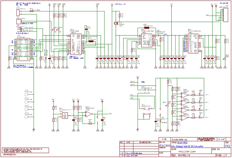

We have the updated design now with several enhancements: a MOSFET based solid state soft power switch triggered by the mechanical switch on the volume knob. This prevents arcing and wear associated with a mechanical switch. We eliminated the cap multiplier as a means to prevent turn on thump (it was too wasteful of power) and we now have a pair of opto-isolator controlled SSR's at the output of the amp. These will not close until a sufficient delay has elapsed to prevent turn on thump (3-5 seconds). This type of back-to-back low RDson MOSFETs have been shown to not contribute anything to the audio signal. An ultralow noise (4uV) TPS7A4xxx LDO is now being used to provide clean power to the audio amp at a nice constant voltage to prevent change in sonic signature with battery power. A switching LiPo battery management system/charger is also being used along with a DC-DC boost to provide the 19v to the LDO. Here is the revised block diagram:
Here is the revised audio amp section - you can see the opto-controlled SSR's for the output:
Here is the (blurred) schematic of the power supply section just to give an idea of the complexity of the power suppy section:

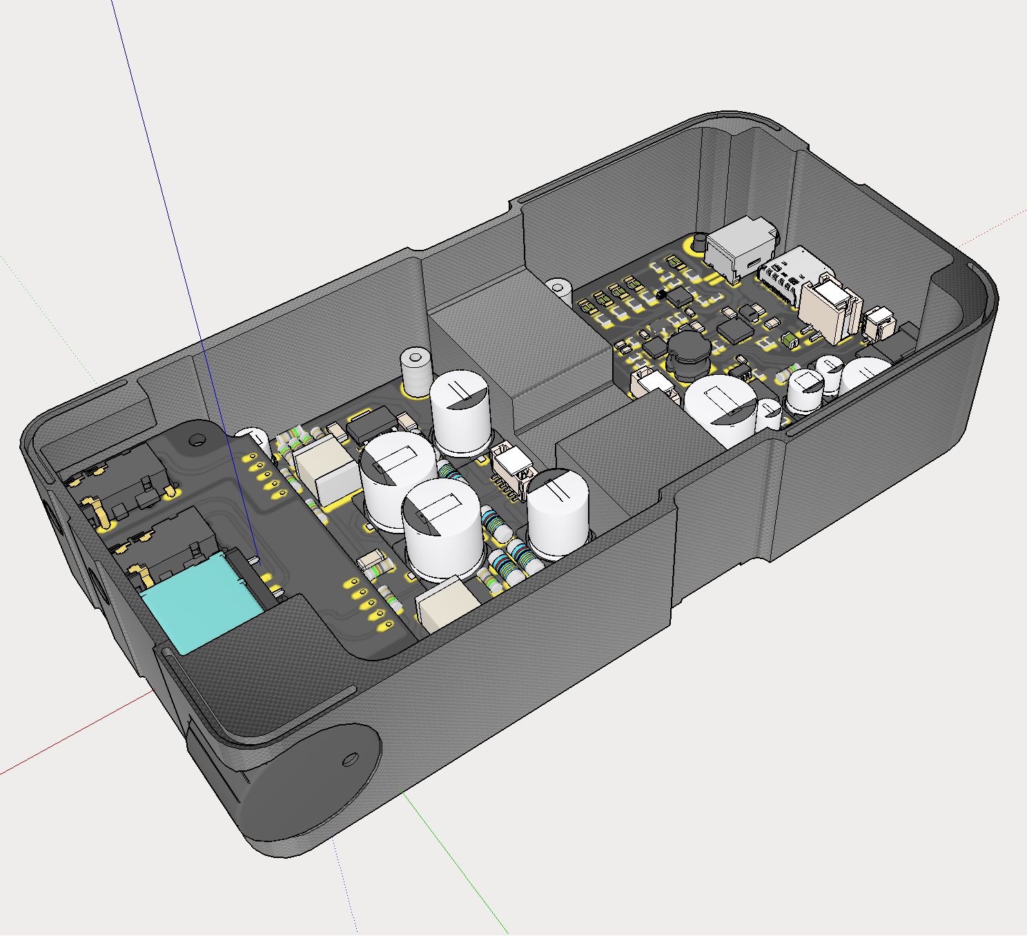

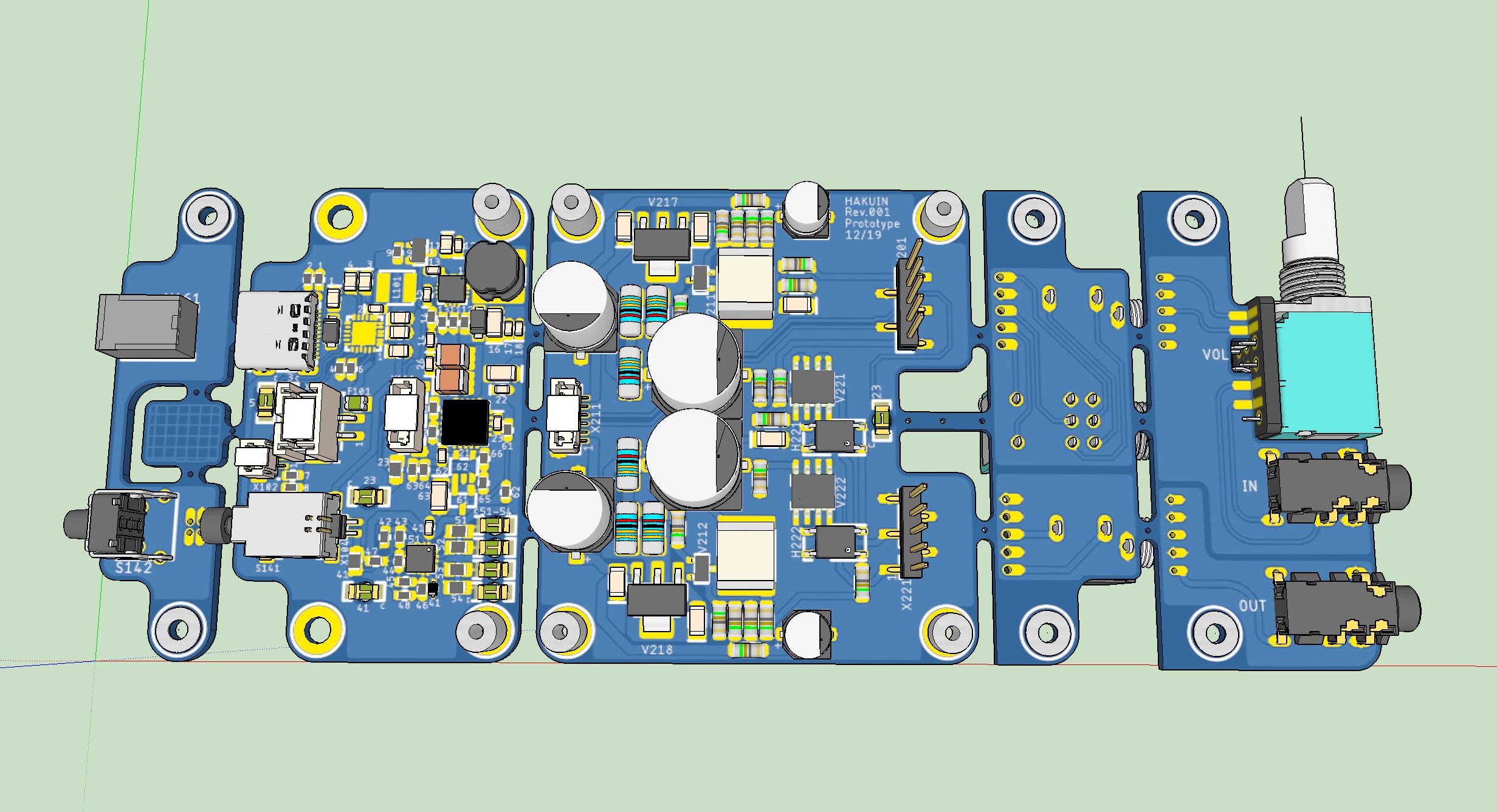

Here is a 3d render of the assembled PCB:

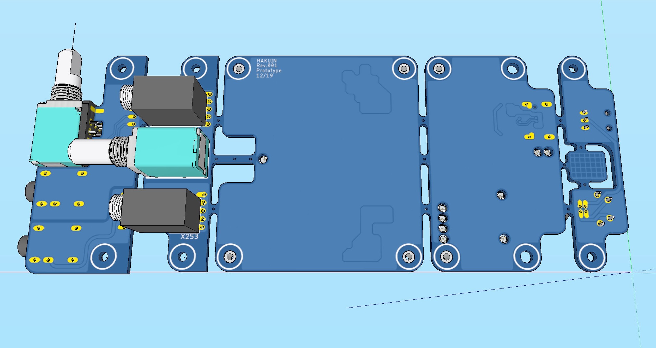

Here is a render of the bottom side:

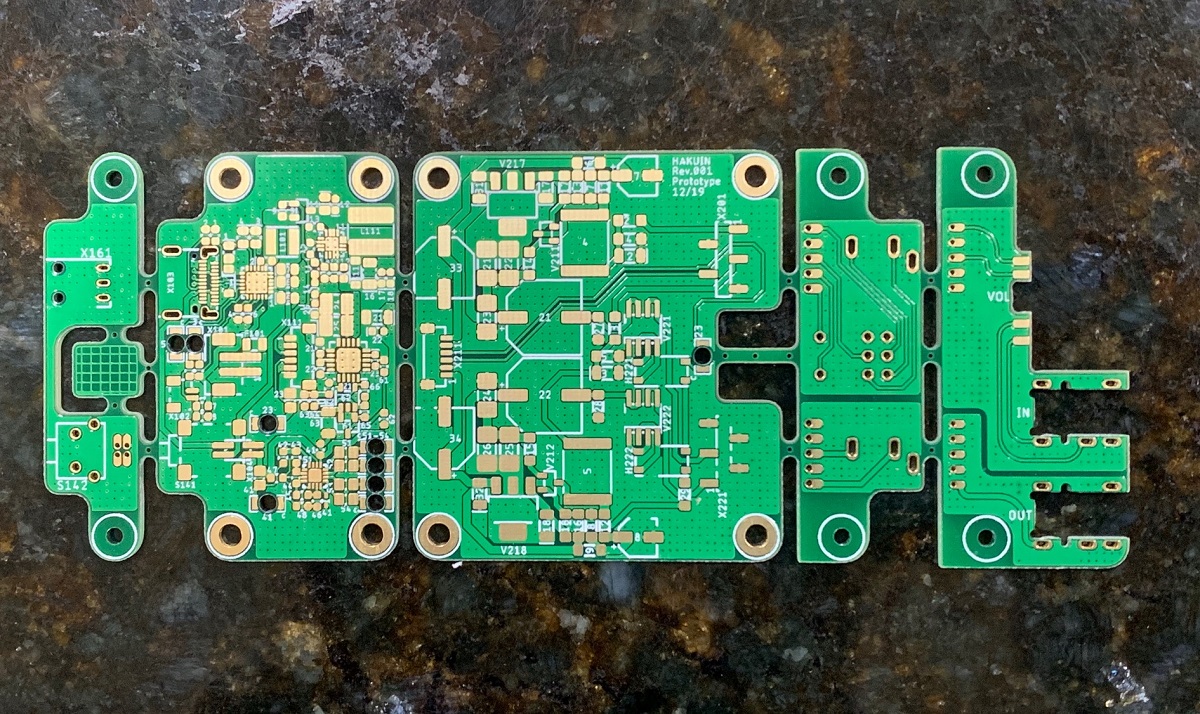

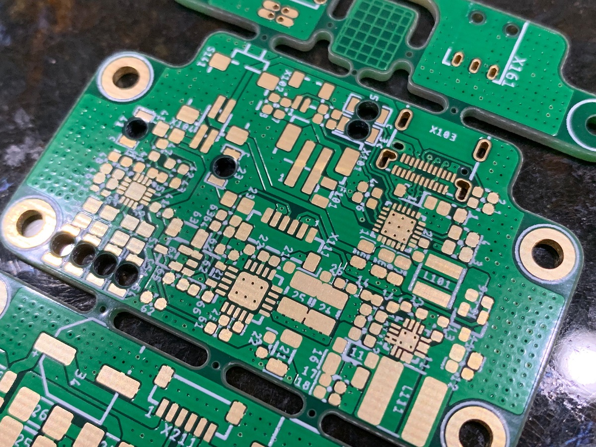

The prototype PCBs for the Hakuin arrived today. They turned out real nice. This will be a fun build! (maybe one time).
Power management system and DC-DC step up plus regulator:
Thes look great - thank you, JPS64!
