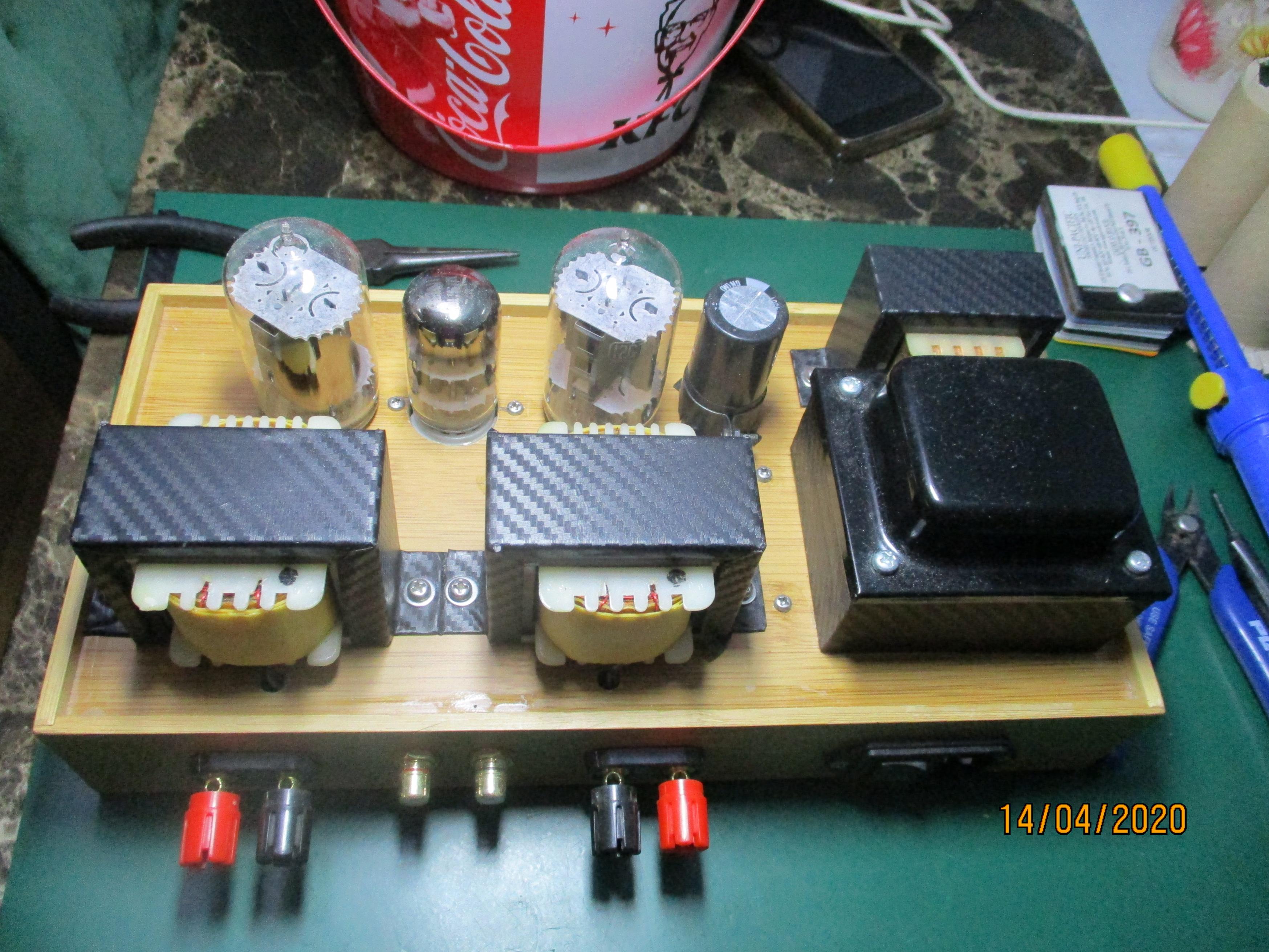

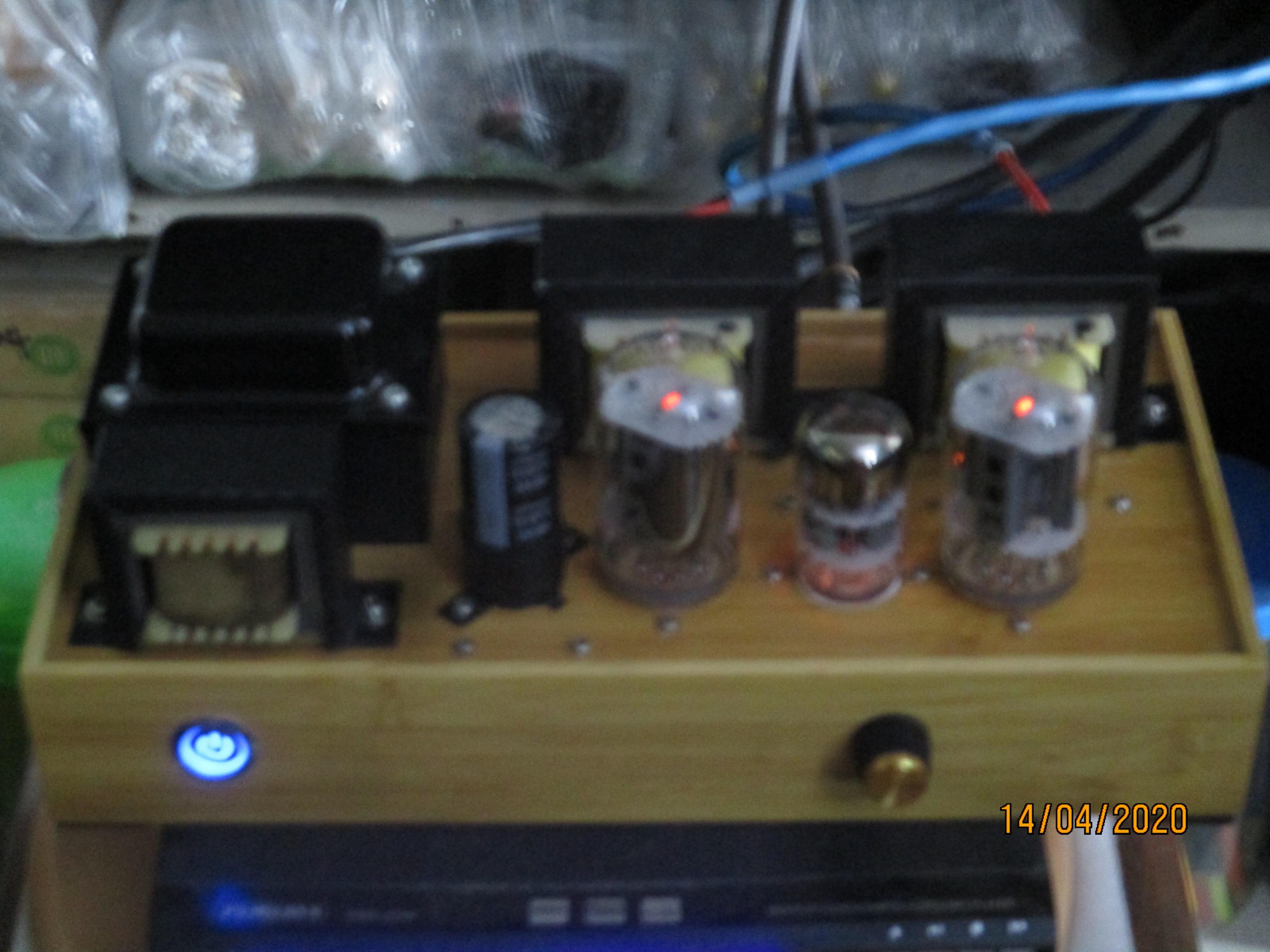

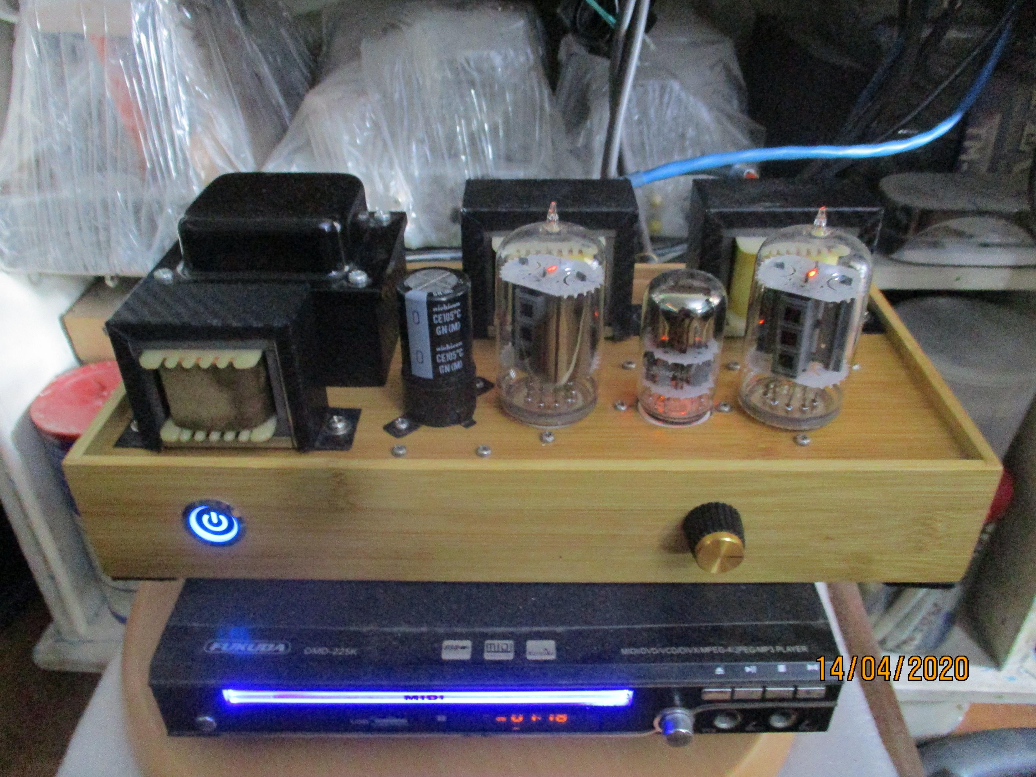

TonyTecson,
Nice looking amplifier.
I like your organic "chassis"
Is that mahogany, or what?

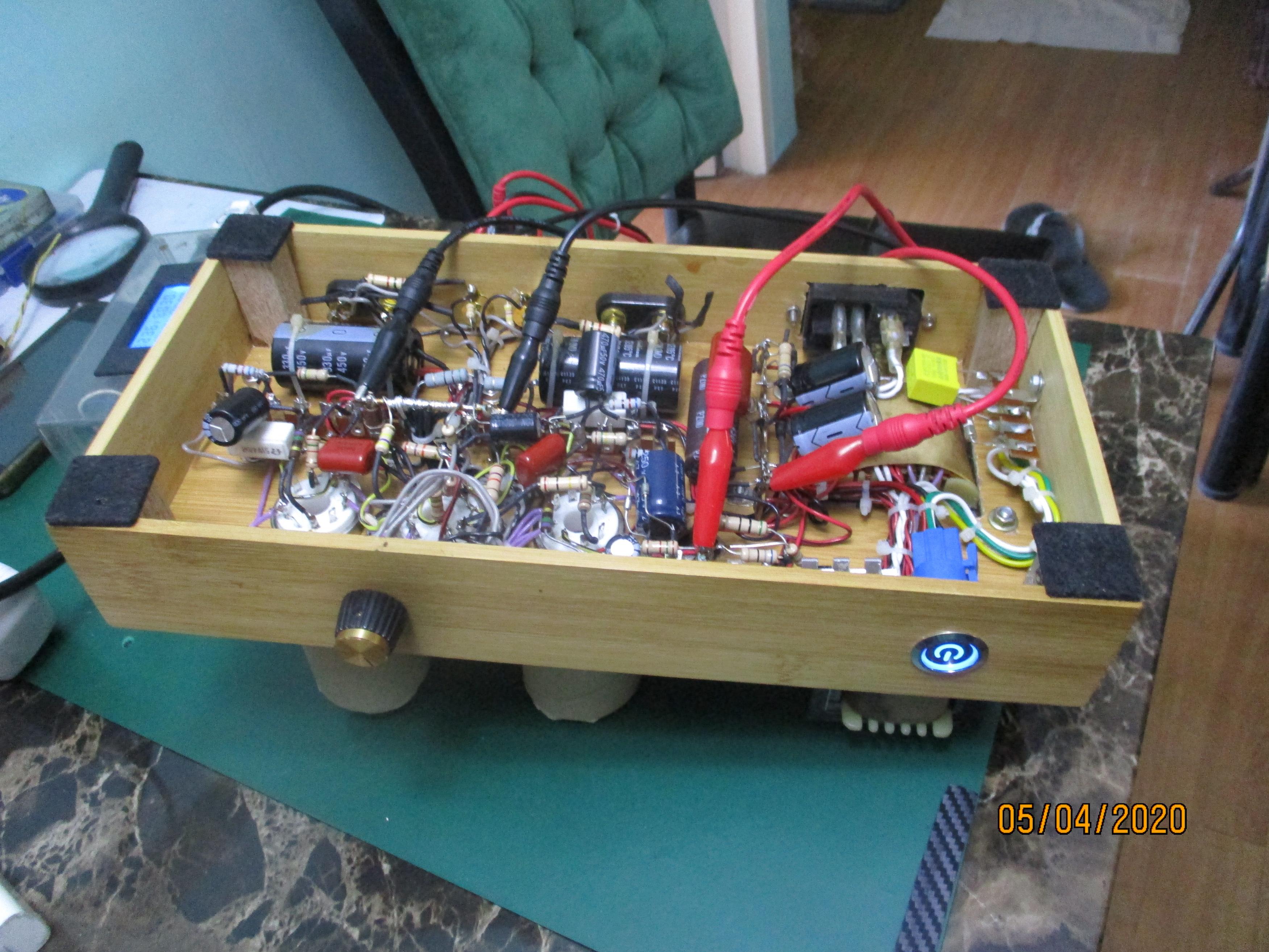

bamboo simulated wood made from lawanit, sides are bamboo..
i got them from the home improvement section from a big mall...
i missed the US bases, that is where we get high quality equipment and even surplus electronics.....M6 grade steels for making traffos, both EI's and toroids....
