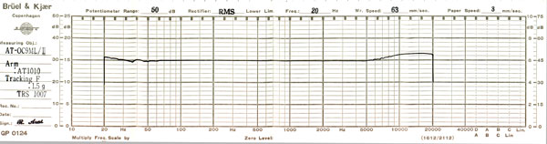

according the review from Germans magazine "Stereoplay" - go to the attached PDF - I note an enhancing in the frequency response of around 6db/octave between 10KHz and 20KHz.
What values are necessary for the load (resistor, maybe even an actually unusual capacitor) for getting a flat response.

Additional it is not clearly to say, whether it is an advantage or disadvantage, if the upper frequency range rises up with a slope of 6db/octave.
If the tweeter from the used loudspeaker has the same character (like Scan Speak's D2008 e. g.), this is a disadvantage because both effects add up and if the tweeter has the opposite character (e. g. like various cone tweeters and full range transducers), then it is an advantage because both effects more or less cancel each other out (I know this effects from Audio Technica's OC-9 users - go to
VENDU Audio-Technica AT-OC9 MLII
and to the attachment and
https://www.audio-creativ.de/wordpress/wp-content/uploads/Audio-Technica_Tonabnehmer_2015.pdf)
Therefore again the question:
What values are necessary for the load to get a flat frequency response in the diagram from the attachment in post #1 ?
Anywhere was a website with listing the load values for a wide range of MM/MC cartridges. Who know the URL ?
