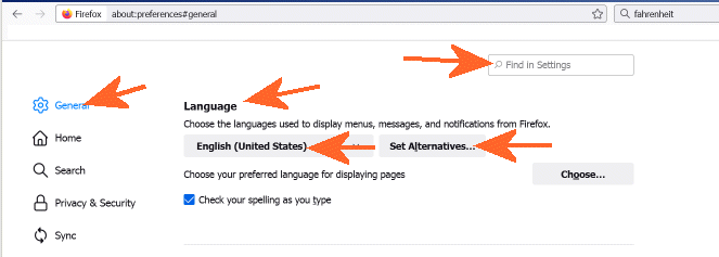

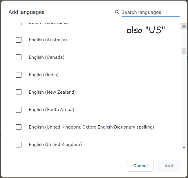

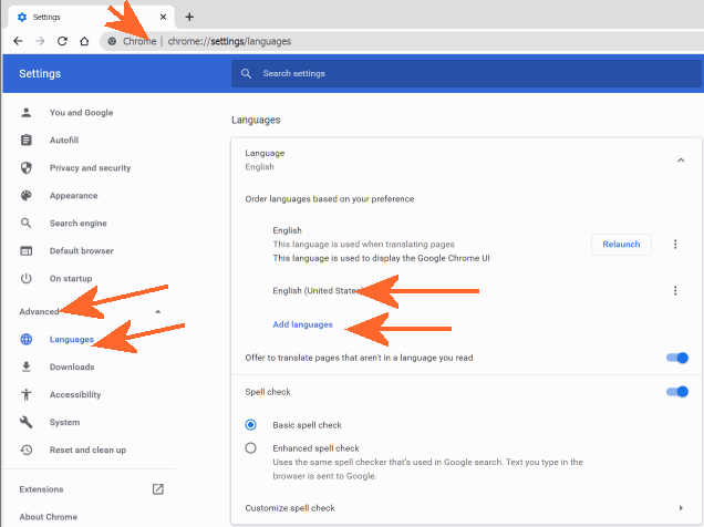

minimises (annoying american spell checker)
That's in your browser. Possibly you can change it. You can on desktop Firefox and Chrome. Chrome has seven flavours (sic) of English aside from the obligatory "US".

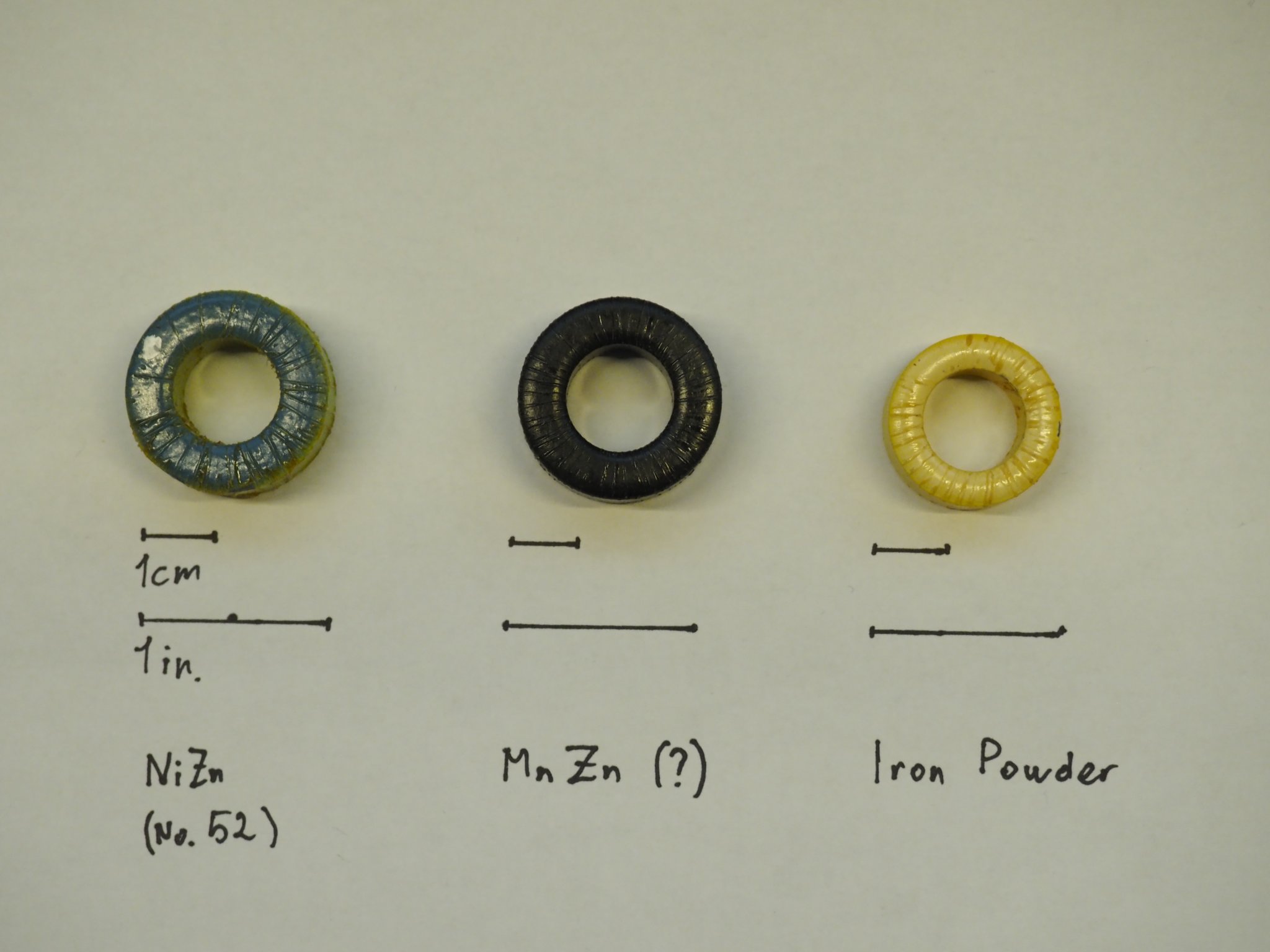

So, i've rounded up the different appropriately sized toroids i had laying around as well as my guesstimation of the core material based on the color coding (which seems to kinda be a thing? albeit not very well documented)
They are filthy on account of them being salvaged out of old PSUs and other hot enviroments. Any suggestions as to which would fit best would be appreciated!

If your MnZn is actually made of that material, it is the one to go for.
To make sure it is, test its resistivity by probing it with an ohmmeter and two sharp spikes as test probes: you need to push them hard enough to pierce the lacquer layer and make contact with the actual ferrite material.
You should read something, typically in the kohm or tens of K range, maybe hundreds of K.
If it is in the megohm range or infinity, it is not good: in fact, the lower the better. µr and the resistivity are closely related.
You should devise a way to measure the inductance/Al, because without hard engineering data, it is difficult to properly design something, and you need to know the minimum required number of turns for your target LF cutoff frequency
