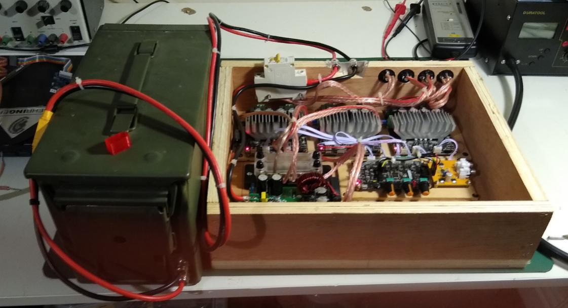

I'm on a slow pace, multi year hobby project to make a combination of 3-way speakers without analog crossovers, and class D amps with DSP to power them and do the crossovers / filtering.
I started out ordering a 3x200W T-amp board:
Sure Electronics AA-AB35281 3x200W Class D Audio Amplifier Board - T-Amp
And a lowcost DSP:
Dayton Audio DSPB-K DSP Kernel Board and DSPB-KE Kernel DSP Expansion 2-In 3-Out
For what it's worth, I'm powering them with relatively expensive SMPS board:
SMPS600RS | Connex Electronic
But I found out this amp board is pretty noisy, and when connecting the DSP board the noise is increased significantly...
IMHO, these parts *might* be usable for a boombox, but not for a home hifi setup.
To be fair, I've been warned on this forum about using these parts, so I'll add this to my "learning experience" list 🙂
So now I'm looking into getting better quality parts, and I keep reading good stuff about 3E Audio boards (on diyaudio.com for example).
Has anybody here ever put together an amp using 3E's DSP and amp boards?

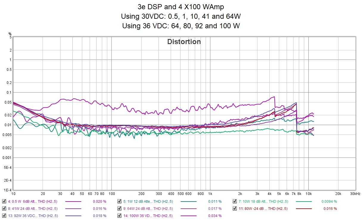

I have the 3e DSP and their 4 X 100 amp. If you're using their DSP then I would certainly recommend using their amps. The DSP and amps are designed for each other: the DSP has line drivers to boost the 1701's DACs max 0.9V max output. The amps are designed to match the DSP's output and both can use differential signals. In my case all the DSP/Amp interconnecting cables were supplied so it was plug and go.
One limiting factor of any 1701 based system when using the analog inputs are the 1701 ADCs: they're spec'd at THD+N of −83 dB. That's a deal breaker for some, but at this price point for DSP capability and 4 channels of amplification it's acceptable to me. I attached a graph of THD tests I ran on the 3e DSP and 4 X 100 amp. I used the analog inputs and a DSP program which just routes the inputs straight to the DACs. I started the tests using 30 VDC, but the amp distortion quickly rises above 65 W. So the tests above 65 W were done at 36 VDC and only driving 2 channels instead of 4 (my Meanwell power supply is rated for 350 W). The one outlier in the graph is the 100W/channel measurement. I used 4 ohm loads for all tests.
Sorry for being late to the party but I have built an integrated around the 3e Audio DSP and TPA3255. The build is documented on my blog and you find the first part of it here: https://emumannen.blogspot.com/2021/04/the-ultimate-integrate-part-1.html
It all started with me initially using the DSP as an active XO in my 3-Way Retro Build documented here: https://emumannen.blogspot.com/2020/10/the-3-way-neo-part-5.html
Here is a link to all posts about the integrated (using tags): https://emumannen.blogspot.com/search/label/UmateIgrate
And here is another to all posts about the 3-Way Retro build (also using tags): https://emumannen.blogspot.com/search/label/3WR
Just follow the link to "Older Posts" to get to all of them.
I am super happy with the results even given the limitations of the ADAU1701.
