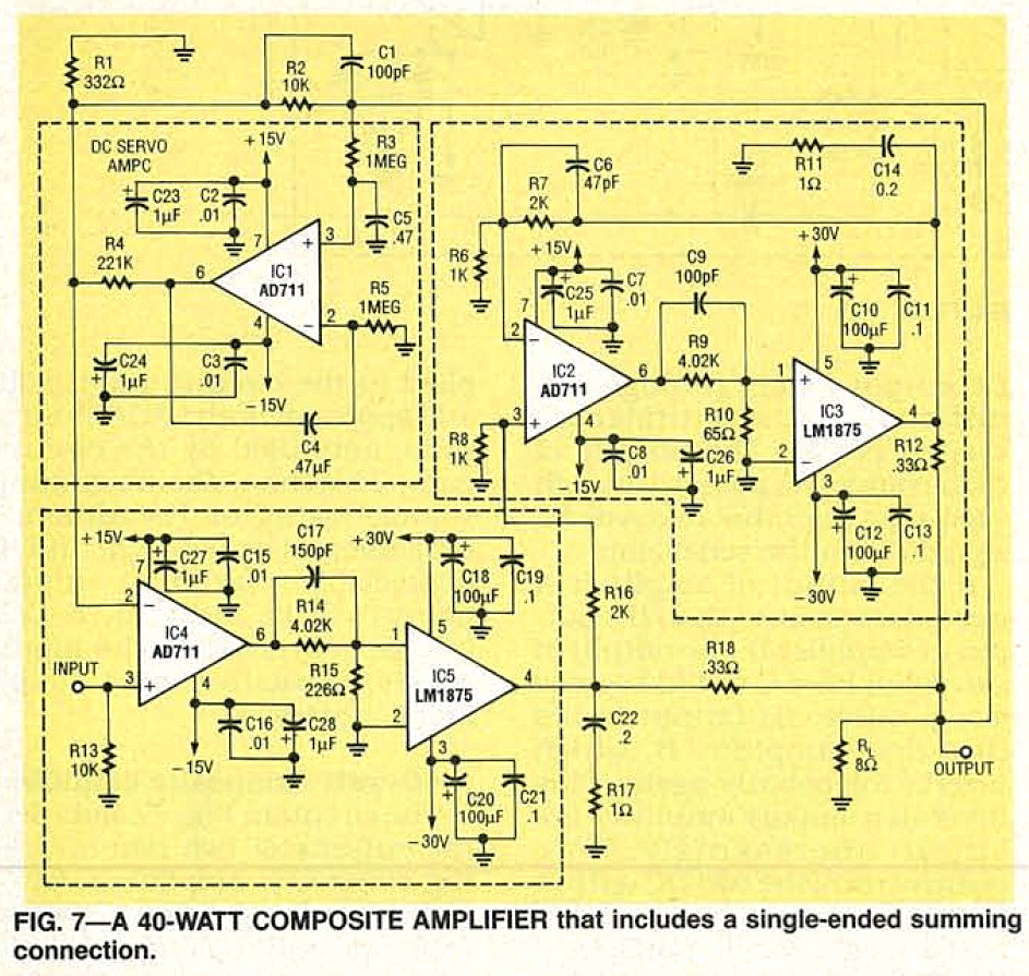

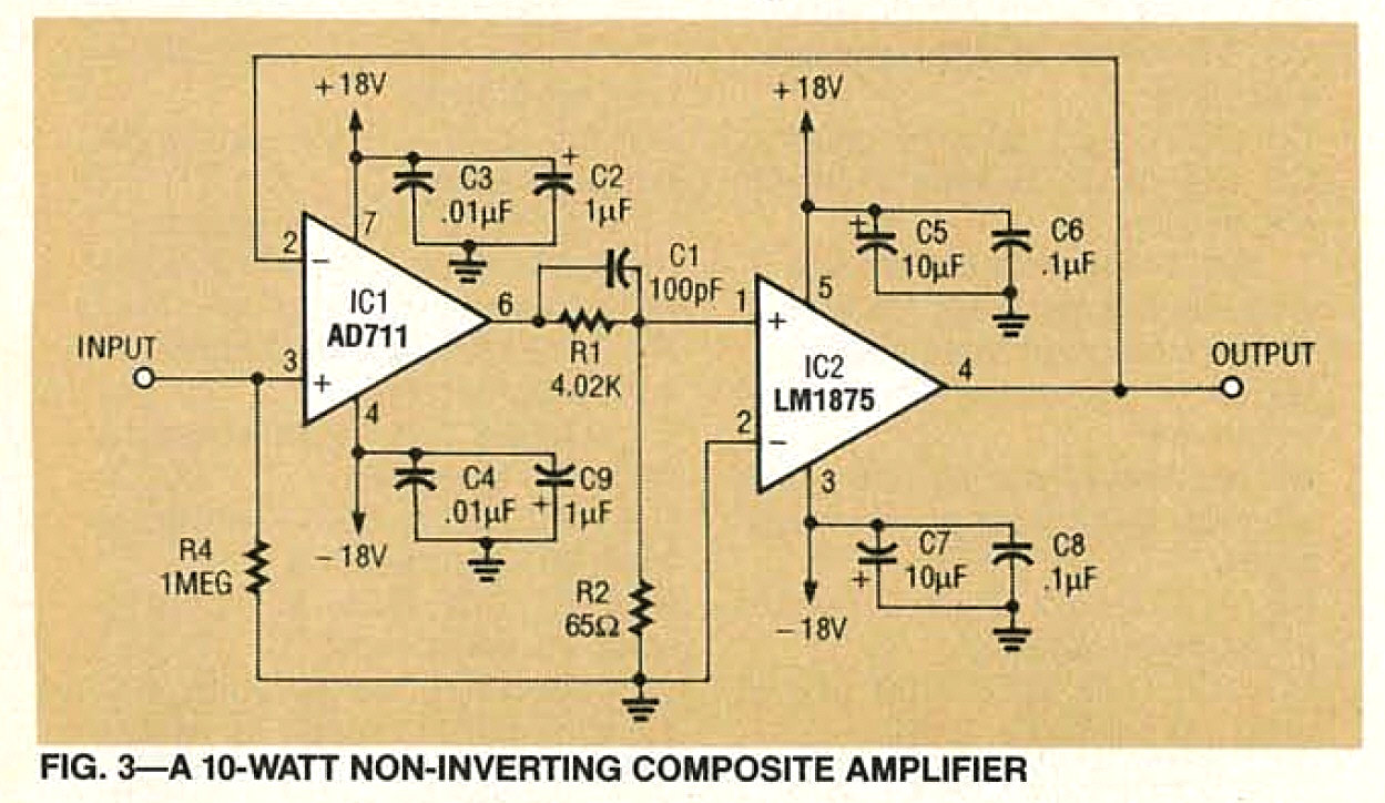

Has anyone used power op-amp as an amplifier? Yes, three engineers from Analog Devices did, with several variations, using the LM1875 power op-amp chip. They published their circuits and measurements in the hobbyist magazine "Electronics Now", November 1992. Here are a few images.
_
_
Using a second op amp provides more loop gain than the LM1875 itself can provide, and therefore the distortion SHOULD be less. In addition, you have now broken the thermal feedback path from the output transistors to the input diff pair, which is the reason that low frequency distortion rises in chip amps (and doesn’t with discretes). With early generation chip amps (like the car radio ones, and all of the LM380 derivatives), designers didn’t even try to address the low frequency thermal feedback and it was positively *awful*.

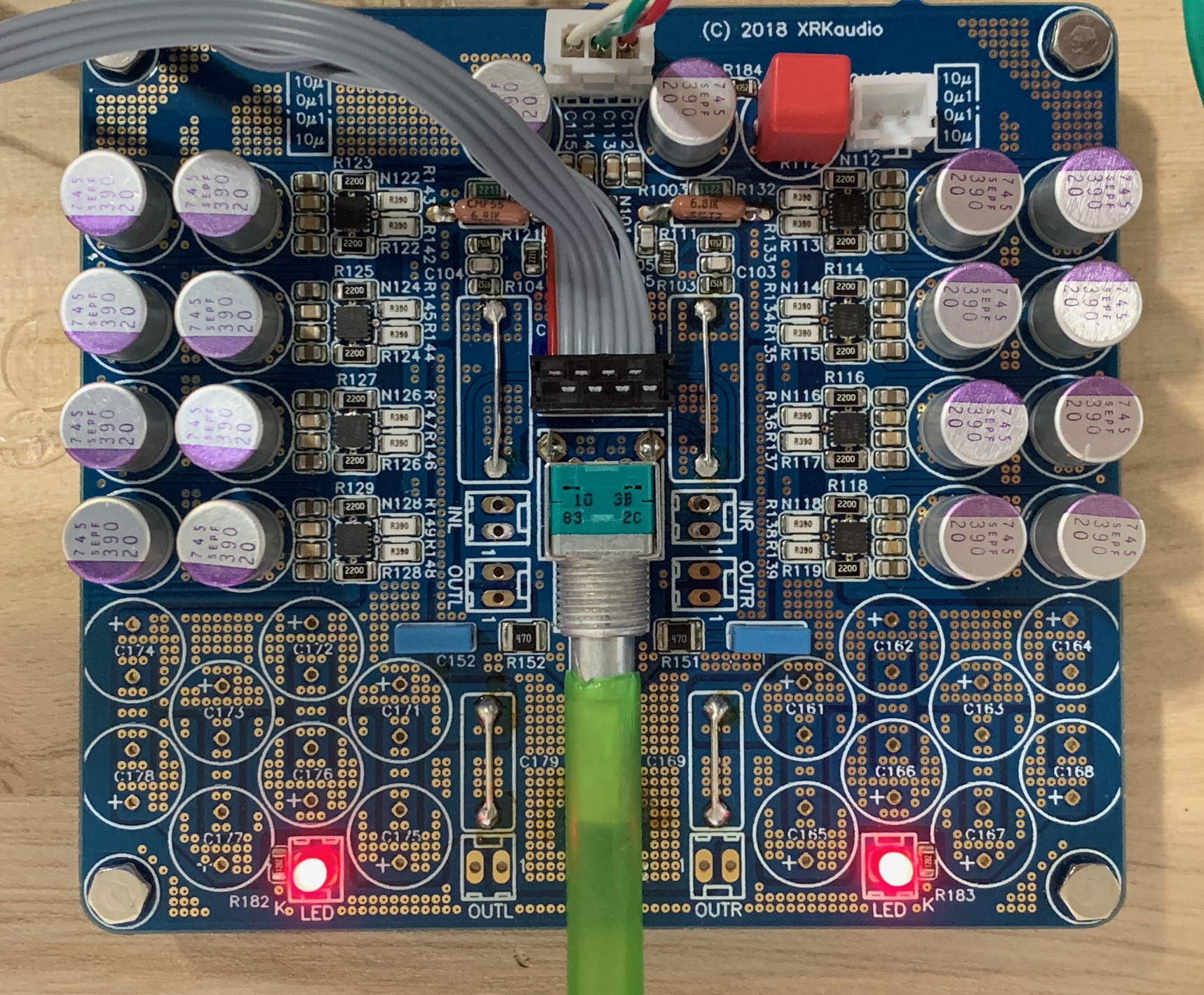

I have also paralleled 8 OPA1622’s for a headphone amp that can drive 12w into 8ohms:
