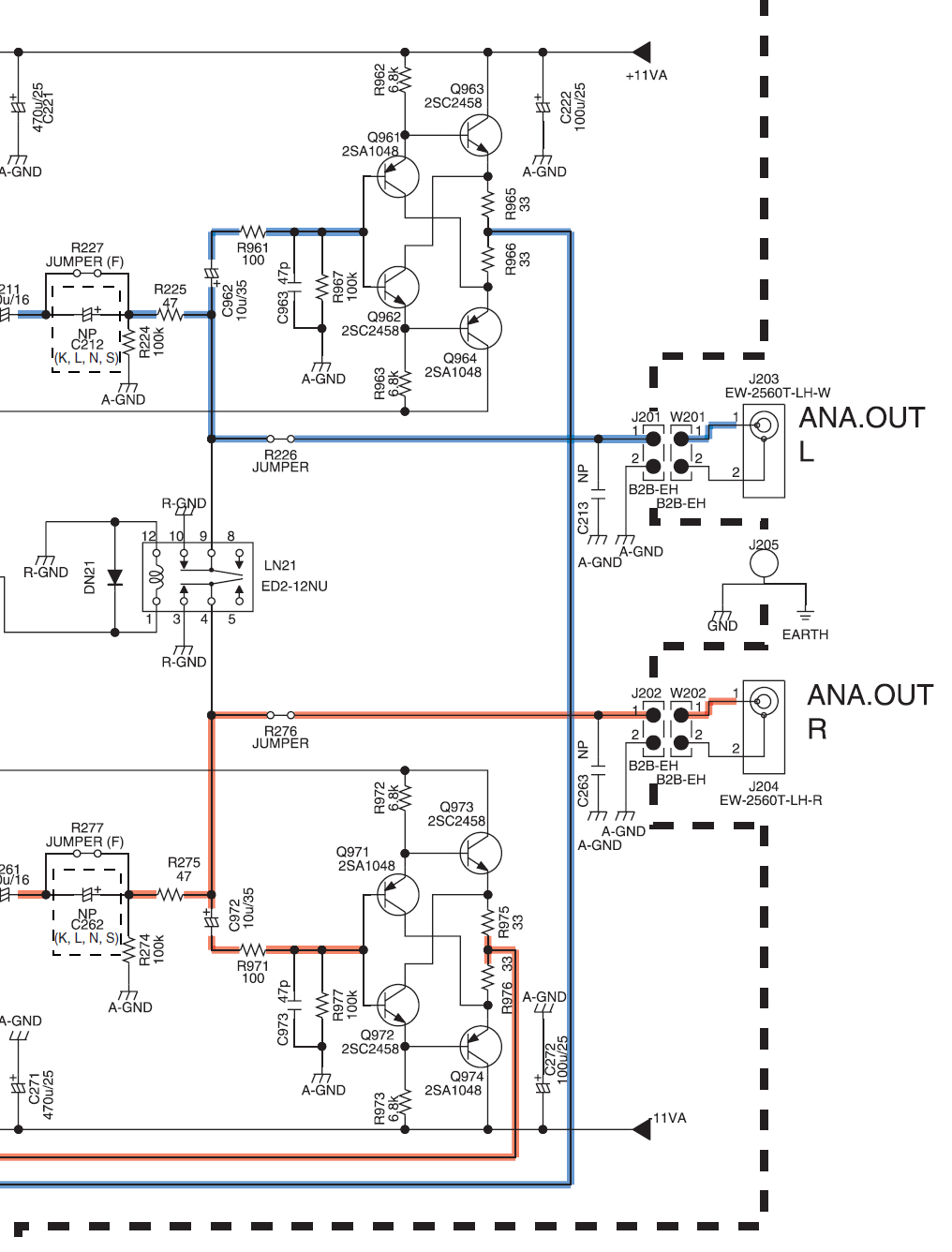

I've been looking for a service manual for the Marantz SA14S1 so I can figure out the output impedance(I've got a picky tube pre-amp which doesn't like anything over 200ohms single ended).

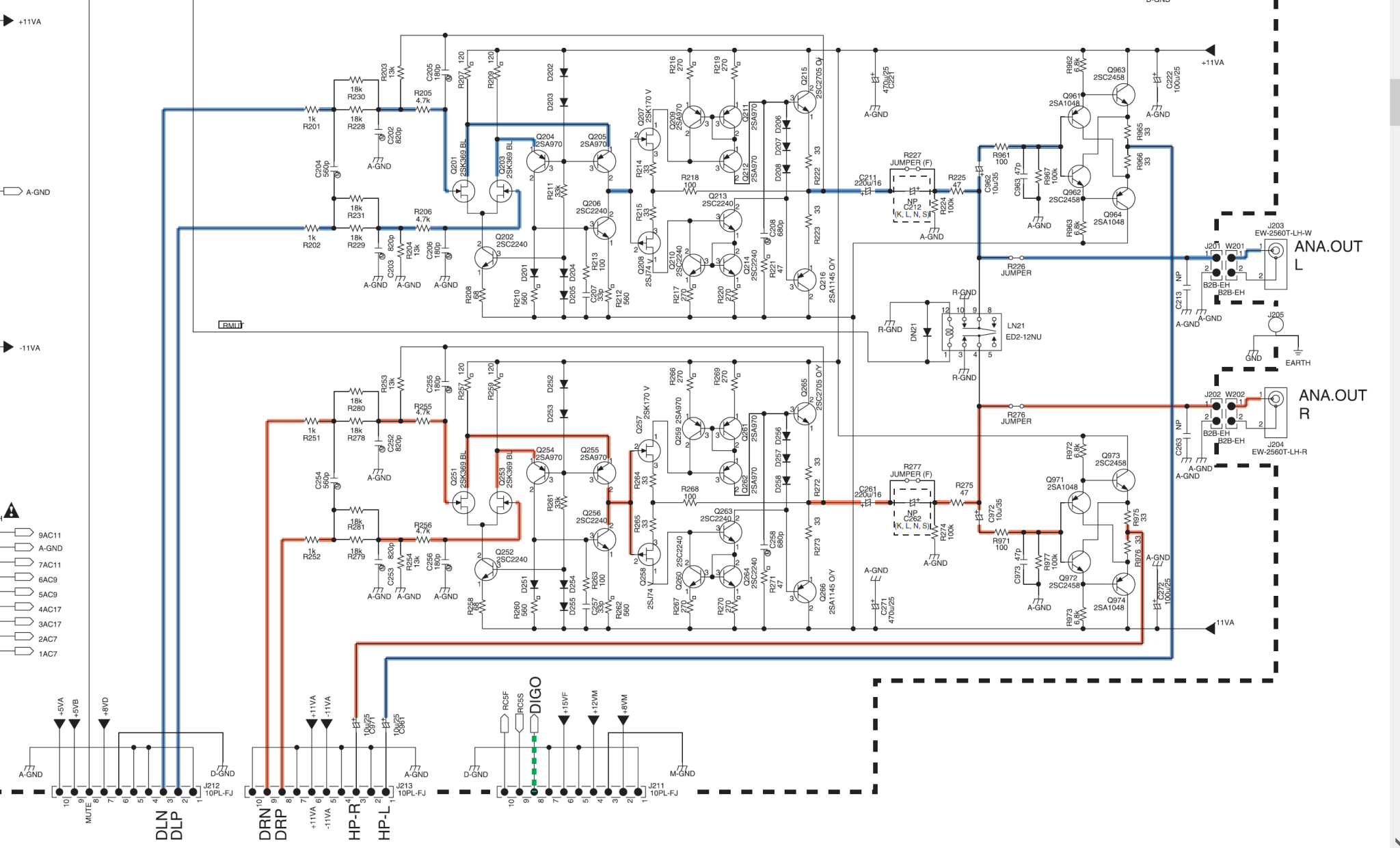

I found a manual for the SA15S1 but I can't confirm if it's the same design or not. I'm not sure if I'm reading it correctly but it looks like the output impedance is going to be 100ohm for the single ended outputs?

Yep! You were exactly right and I was reading it backwards! It's actually the line output for the CD Player. 47ohms output impedance seems quite low compared to others I've seen but at least it means there won't be any attenuation with the weirdly low input impedance on my tube pre-amp.So I was right about the headphone output.
The output impedance of the preamp is 47 Ω. It's set by R225 and R275.

47 Ω is pretty common. The resistor is added to make sure the preamp doesn't start to oscillate with a capacitive load such as a long interconnect cable.

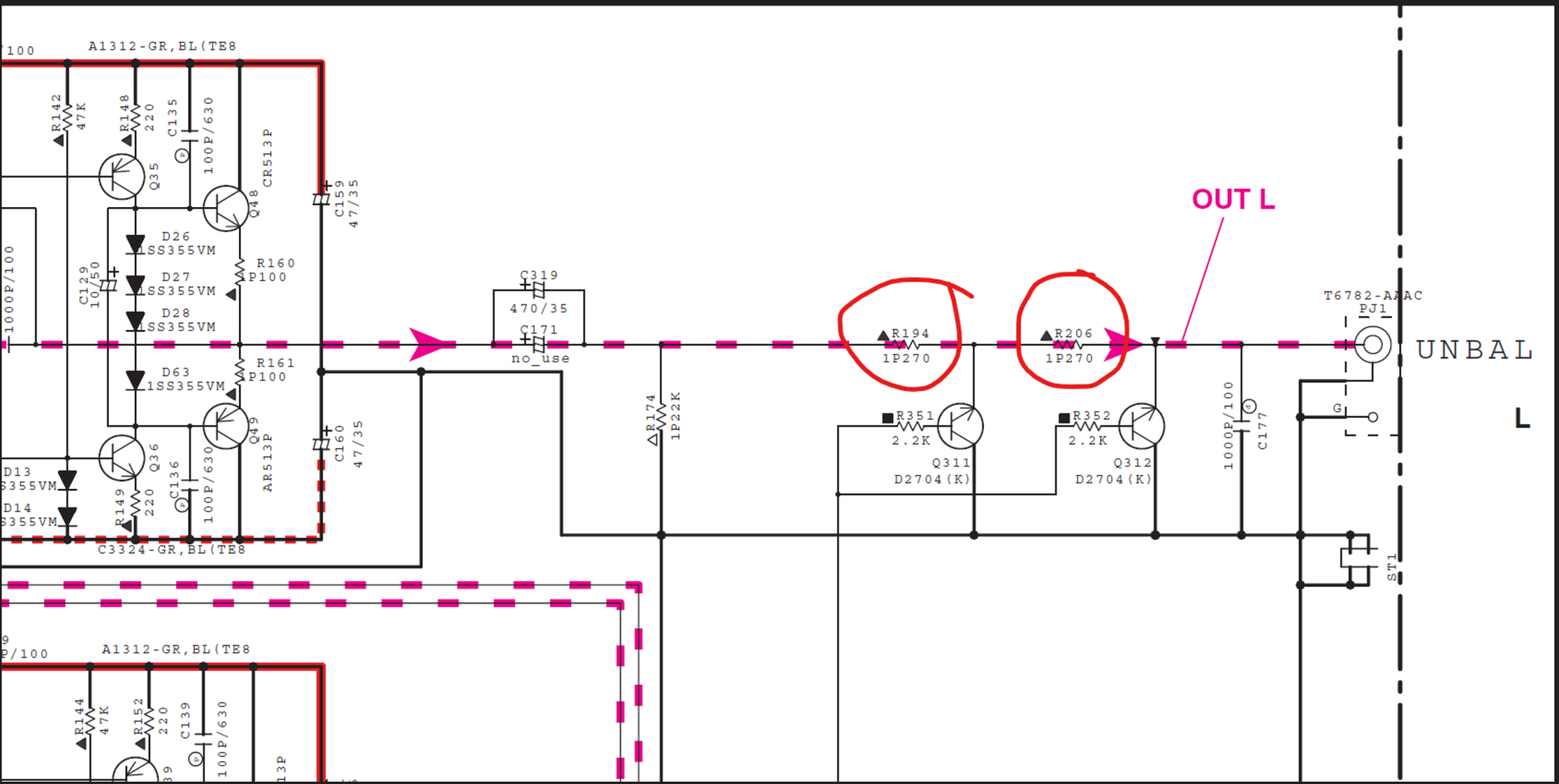

Alright, 47ohm is the lowest I've seen from a CD Player or DAC but I've only seen that spec on maybe a dozen different units. I've normally seen 100/200ohms being the most common. The 540ohm on my Yamaha CD-S2100 is the highest I've run into so far.47 Ω is pretty common. The resistor is added to make sure the preamp doesn't start to oscillate with a capacitive load such as a long interconnect cable.

Can you tell whether changing the resistor in the Yamaha output below to a lower value could negatively affect the performance? Or would I be okay with substituting a lower value so that I could have a lower output impedance? I don't have the full circuit diagram for this one.
I don't know. That's a question best directed at Yamaha.
I suppose I could simulate the preamp and look at how its stability changes with capacitive load, but then again so could you... 😉

Considering they wouldn't even provide me with the output impedance when I asked I somehow doubt they'll consult with changes in the design!I don't know. That's a question best directed at Yamaha.
