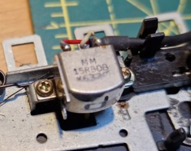

I'm trying to fix my late 1980s B&O tape deck which was stored in my attic for over 20 years. I've replaced all the belts and the mechanical side works fine. But, there is no sound coming from the left channel. Initially I thought it might be a capacitor issue so I tested them all in circuit and found a couple of bad ones. I replaced them but still no joy.
I then checked the tape head. I connected a multimeter across each channel and found the right channel reading about 280 ohms but the left channel was open. For each channel I then connected the meter to an output and ground and played a tape. Both channels produced about the same millivolts, zero to about 5. I am now confused why there is an output from both channels.

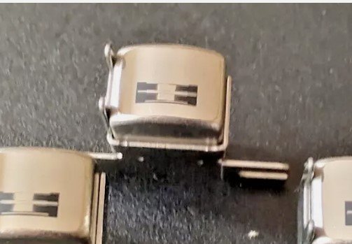

If I decide to buy a new head from eBay, are they all the same size and it's just the mounting that is different? Or, are the actual dimensions of the head different in which case I'll need to get the old vernier callipers out? I've had a look at a few adverts and none mention size. I thought I'd buy something like this,
"High Quality Replacement Hi-fi Stereo Cassette Tape Head (Metal Tape Compatible)"
The original head is Sendust N6 Z 20 as used in a Nakamichi BX-100.

Just to bump this, if I change the head what do I need to look out for apart from the physical connections?
@newvirus2008 where applicable, I've checked all that; capacitors, solder connections, left and right pre amp channels work. I assume the head has gone as its was stored for 20 years in an attic and subject to hot, cold and damp conditions.
There are two main bracket types with one much lower on the head. Make sure you get the correct one.
Are you 100% sure one channel is open. It is an incredibly rare scenario for that to happen and the windings are sealed in the head with hard epoxy. They should be immune to damp and so on. Flux on the pins can insulate them from the meter probes. Make absolutely sure it is open.
@Mooly Not sure what else to check.
The left and right deck pre amps now work as proven by swapping around the connections. I've reflowed the solder on the head connections and it made no difference. The left channel of the head still reads open when tested with a meter. The right shows about 280 ohms so I guess I'm doing the check correctly. I tested the head in 2 locations. First at the head connections and then, in case there is a build up insulating the probes, at the 9 way connector end that plugs into the board, after unplugging it I should say. Both ways give the same readings.
I'm thinking of buying a replacement head to prove my theory. At about £14 it's a relatively cheap way of doing it. If the problem still exists, back to head scratching.
Well that is pretty conclusive I must say. Very rare but if its open its open 🙂
All you can do is replace it.

See if you can find NOS Akai or Panasonic SSD (Super Sendust) heads, ferrite heads do not give as good a higher frequency response.
Akai glass heads were famous for their quality.
Panasonic was OEM to many cassette deck makers, Nakamichi volumes were low, the name just adds to the asking price.
Panasonic logo on those was 3 arrows pointing out at 120 degrees from the same centre, there must be photos on the net.
Just check mounting, as Mooly says above, and verify that the impedance is similar.
