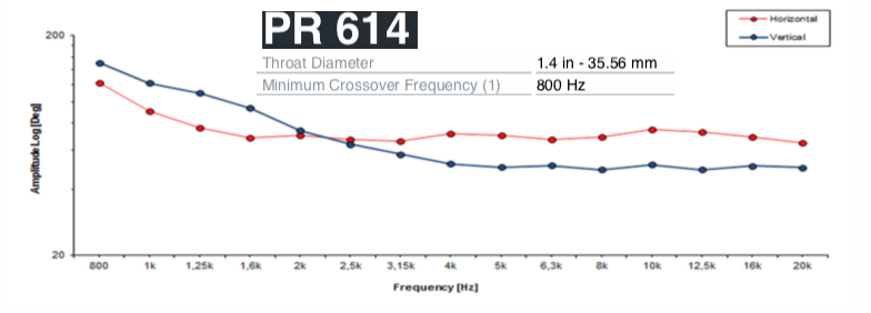

The PR 614 horizontal and vertical coverage flip below 2.5kHz, and it's horizontal coverage has expanded from 60 to ~140 degrees at 800Hz, at 500 Hz it would be well over 180 degrees unless on a large flat baffle.
Yes, the horn does have impressively constant Hor. directivity. Averaging ~ 70 degrees out to 6kHz when crossed at 800Hz?The manufacturer's recommendation of a 800Hz minimum crossover frequency is enough indication that sound quality will suffer below.
Can't make out the numbers on this plot, though. http://oem.ciare.com/ik_files/catalogo/img/450_horizontal_web.jpg
But given my midwoofer's H3 and IM distortion numbers https://josephcrowe.com/blogs/news/altec-416-8b-in-100l-sealed ,
wouldn't it be better to use a horn https://audiohorn.net/next-gen-bi-radial-horn/and 2" exit driver https://jblpro.com/en-US/product_documents/2450-pdf that could cross at 500Hz?
A horizontal coverage that has expanded from 60 degrees above 2.5kHz to ~140 degrees at 800Hz is not "impressively constant" if one is considering a lower crossover.Yes, the horn does have impressively constant Hor. directivity. Averaging ~ 70 degrees out to 6kHz when crossed at 800Hz?
