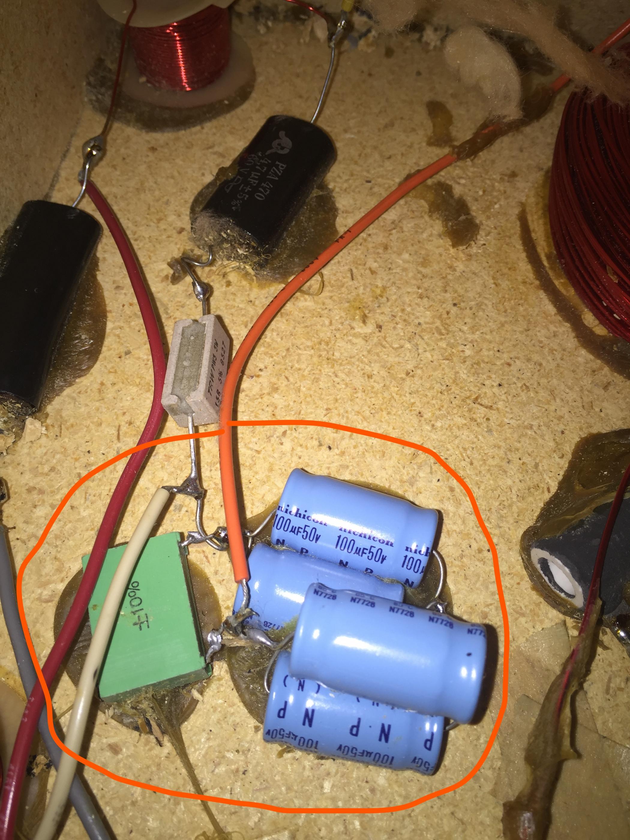

Have these Caps been bypassed in this picture ??
This is a picture of the capacitors (circled) for the midrange on some speakers I`m going to freshen up.
I`m going to replace those 4 Nichicon`s with a single higher rated cap. The originals are about 34 years old.
What I`d like to know is, is it worth putting in a more expensive cap with tighter tolerances ?
I ask because the original caps are soldered to the 'Green Box' shown in the picture which says +- 10% ?

Yes, it looks like those four 50v 100uf electrolytic capacitors have been combined in a series-parallel combination to create a single 100v 100uF capacitor. That green box looks like a poly stacked film capacitor and looks like it is bypassing it. No way to be sure without multiple angles.

Yes, that's how it's connected, 2 parallel in series with an identical pair. The purpose is to double the voltage rating of the capacitors. Not a good decision sound wise but good for handling high(er) power and safety - the electrolytic capacitors can explode if fed too high voltage.
Thank you gentleman.
So before I order new caps/cap would it be worth it to put a nicer cap in, like a Clarity or Solen rated somewhere between 250V-400v ?
Should I eliminate that Green film cap altogether then ?

Replacing the 4 serial/parallel caps with one of the same capacity as one of the 4 will improve the sound quality by a great margin. The quality of film caps are generally higher than the electrolytic ones, even if they are older. It will not change much in SQ and since the film caps don't age like the e. caps, I'd keep it. It's likely there to increase the value of the Cs anyway and needed for the filter setup.

Yes, a single 100µF one with a higher voltage rating will bring more clarity and resolution.
But, being uneducated in this stuff I need to ask; Can I can put a better film cap in with tighter tolerances than the +- 10% one that`s in there now ? and will I hear an improvement ?
You can replace it but I doubt you'll hear a difference. The capacity is almost completely given by the electrolytic ones anyway, so if you want to have tighter tolerances, you'll have to start there.
100uF is a value more easily found in electrolytics, otherwise it is quite large. Maybe this is in the woofer circuit, and maybe this setup isn't causing a problem. Nichicon are not a bad brand.

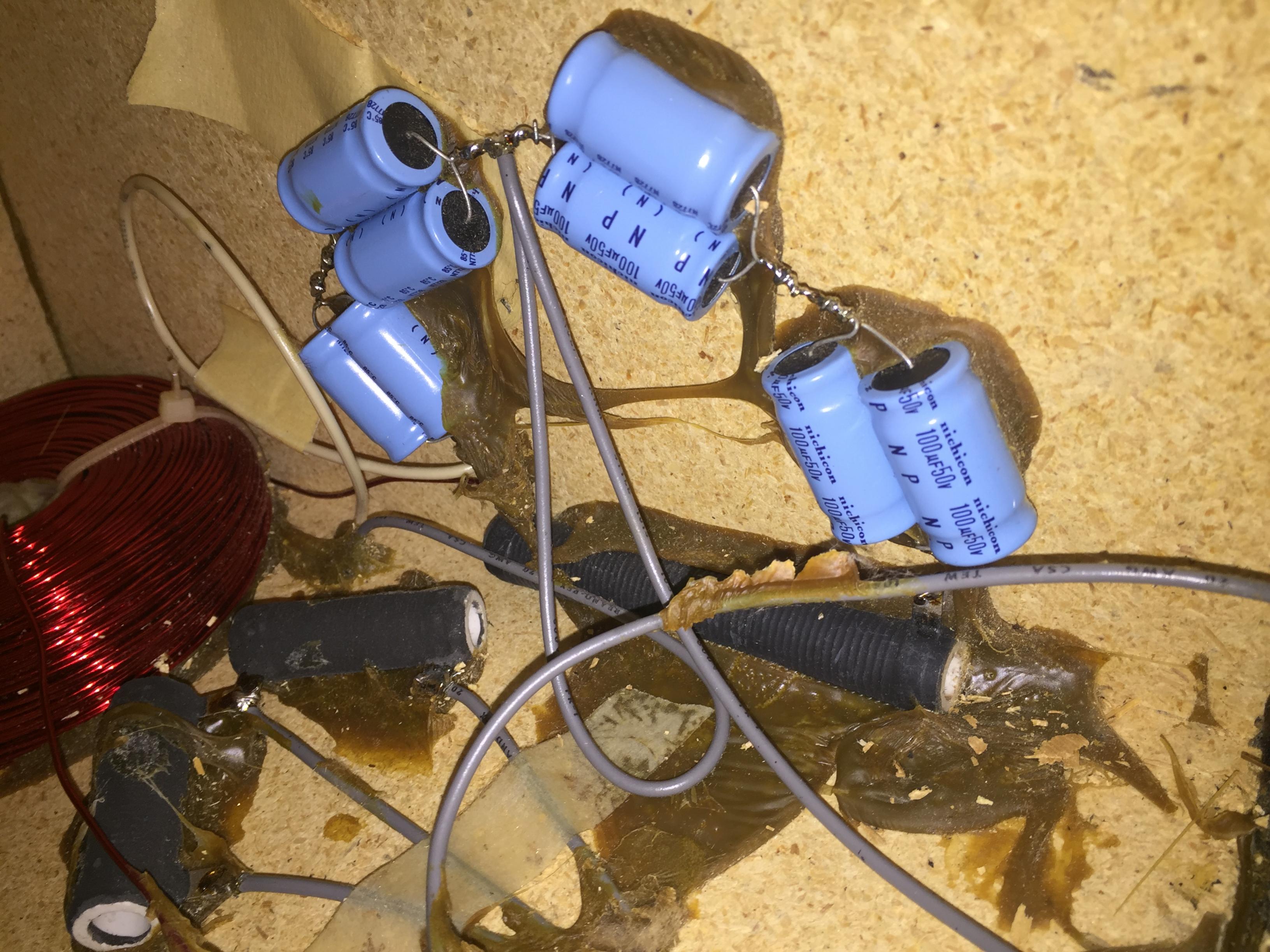

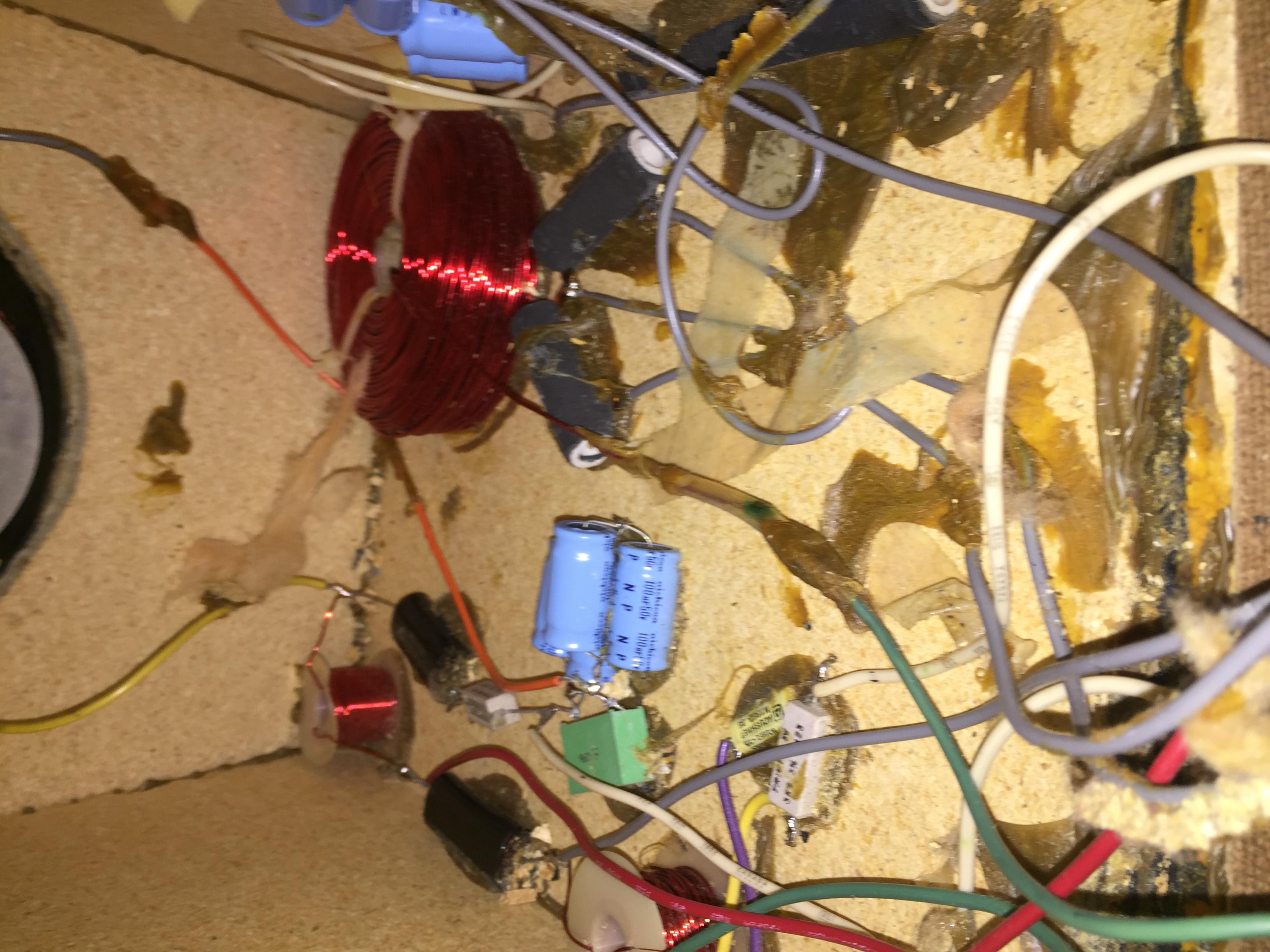

Hi, this is the mid section for certain. Here`s a picture of the caps for the subwoofer section. The caps are glued to the side wall of the cabinet.
I can`t get the second picture orientated correctly :( You can see the mid range caps which would be the floor.

Remember: This series-parallel onnection of four equal capacitors not only keeps the capacity of a single one, but also it's ESR. So, where should any sonic difference result from?
OTOH, I doubt it's use as well. Why do we need a voltage rating of 100 Vac in a - proposedly - home speaker? This would equal 2500 watts @ 4 ohms or 1250 watts @ 8 ohms?!?
Best regards!
Seems like they are attempting some of the same construction some boutique film caps use.
The reason Mundorf Supremes are so large is their series construction.
The parallel/series electrolytics probably helps reduce ESR, but may add inductance.
I would absolutely replace every single cap there. Replace the electrolytic banks with Mlytics, and the single SCR caps with anything decent.
However, it may be worth while measuring the electorlytic banks first, to ensure you don't severely change ESR.

Thanks Eric...I`ll need you to dumb it down for me if you will...sorry but I`m not very knowledgeable as to what some of those are that you mention.
Like what is a "single SCR cap" ? and what is ESR ?
So far, from what I`ve gleaned from various forums, I was thinking of using 2-Mundorf Ecap`s 100uf 100v to replace the 8 Nichicons going to the subwoofer.
And, either a Solen PB-MKP-FC 100uf 400v for the midrange or a Clarity CMR or CSA on the upper end (to me).
Or an Audyn that had been suggested for not a lot of money instead.
Thoughts ??
