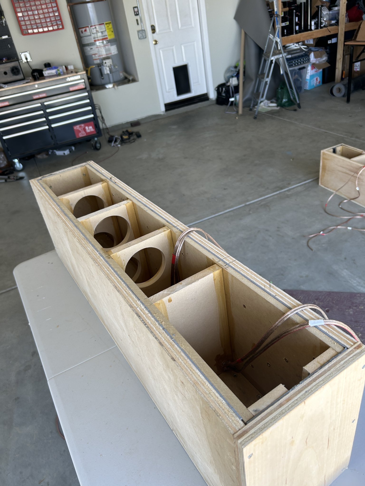

I use mass loaded vinyl in between 3/4" plywood and 1/2" MDF. I build the plywood, lay in the vinyl then put the MDF in and glue it. I have put screws through the MDF into the plywood and I have also left it free standing. Not sure which is better.
I have definitely succeeded in making really heavy speakers.........I think it also helps with resonances.

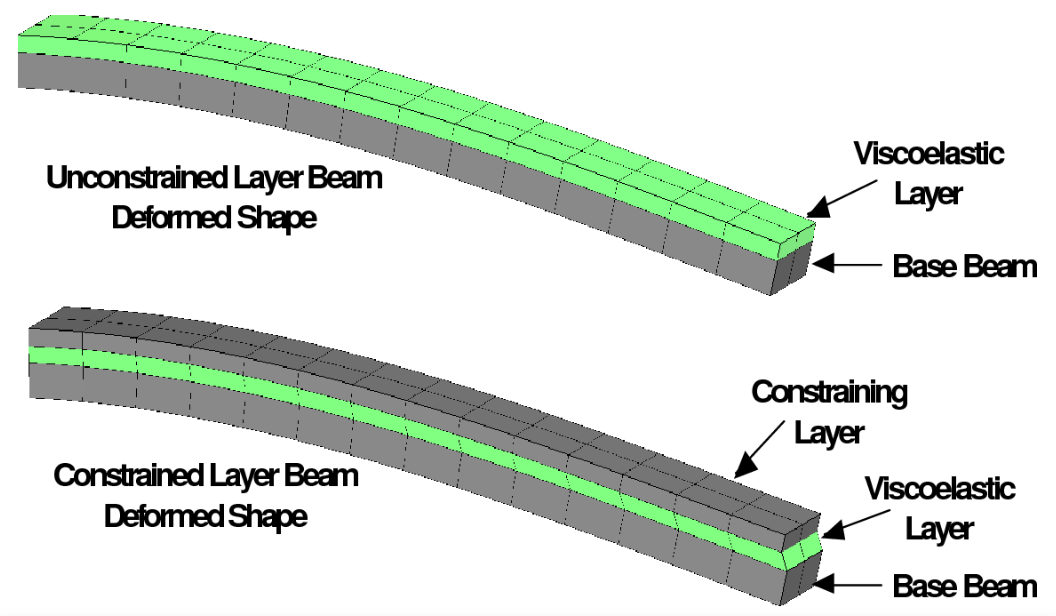

I suppose you have studied at least basics of CLD but in case someone is not familiar here is some quickies:
it works so that there is two outer panels and viscoelastic material in between. When the panels deform, the surfaces to viscoelastic material get to different lengths and shear losses in the viscoelastic material should dampen it. See the image:
Image from https://www.semanticscholar.org/pap...-Pai/89c1c8f4bf248a1b1de2d0a23157b2f253c755da
The viscoelastic material needs to be have particular stiffness compared to the base and constraining layer for optimal damping, can't be too loose or too stiff, or performance suffers. So all three layers together determine the performance. See this for example, or any study about this stuff:
https://elib.dlr.de/187991/1/Manuscript_Final_Version.pdf
As seen in the photo above, on a panel the shear is most on the edges and least on the middle where the panel actually flexes (as in lowest mode). Panels have multiple modes though and could flex here and there at higher frequencies and you can steer it some with bracing, kill the first mode by having one brace in the middle.

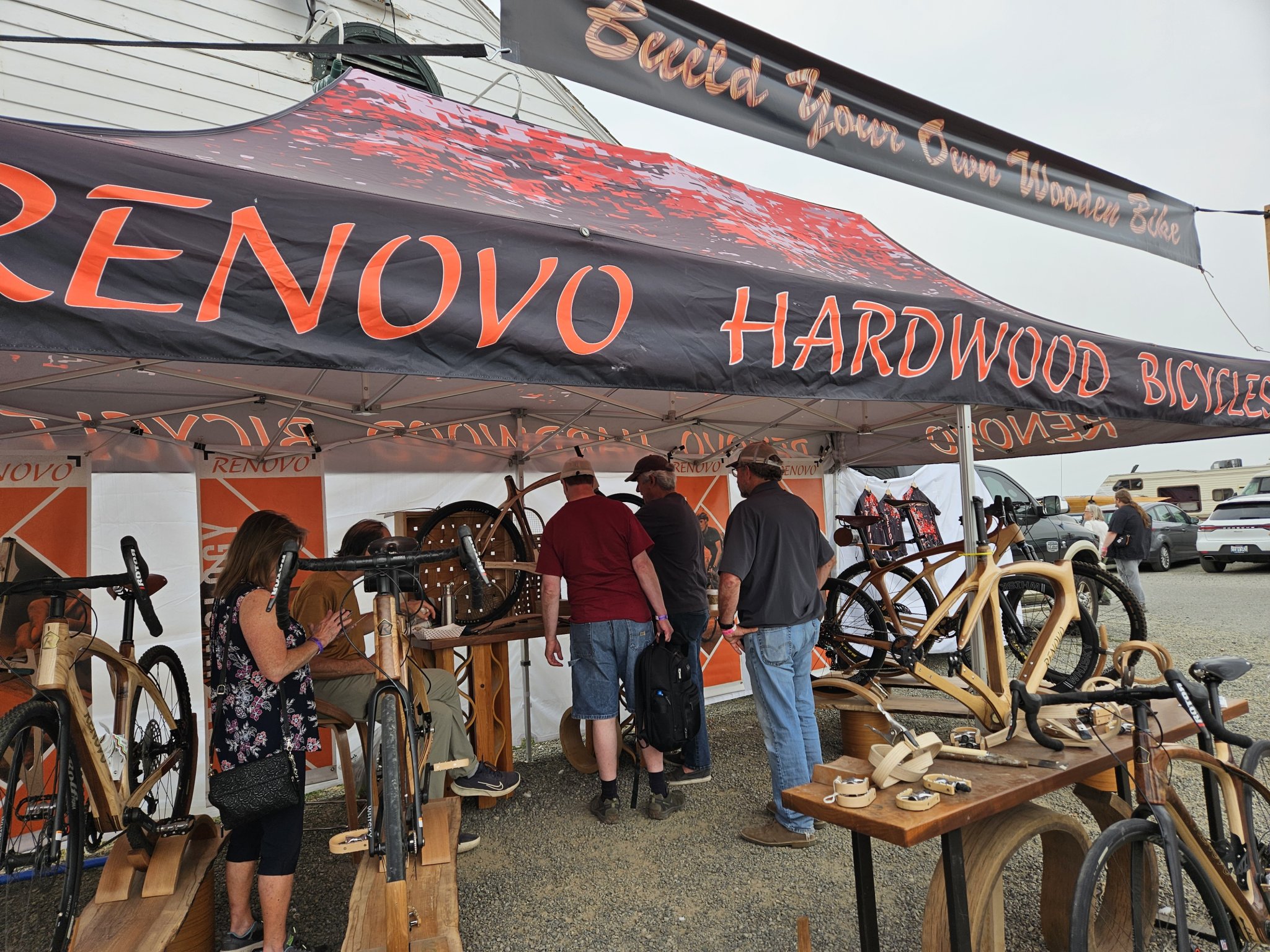

Not composite but I was just checking out some cool wood framed bikes at a Wooden Boat Fest.

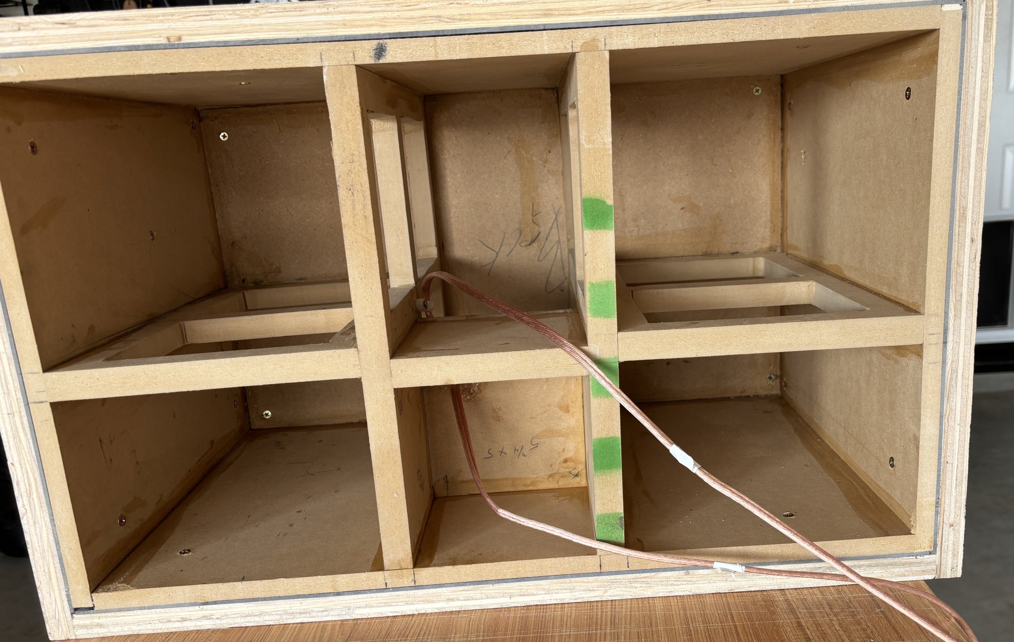

I have done a lot of experimentation on enclosure material. I no longer use one type when building a speaker. The reason is that I believe that you need at least two different materials with two different speeds of sound through them. This works to smear out and dampen resonances.
My latest pair is made from oak, birch plywood, a layer of rubbery/tar-like sound dampening material, a layer of foam and/or denim batting, then polyfill. All together it makes the cabinet "dead" when you knock on it.
