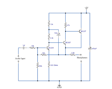

I've always wanted to build my own headphones and was curious if anyone here has any experience or tips as I am not sure if the circuit can work.

Here is the circuit.

Unfortunately, that circuit has a 2.2k series resistor which will block most of the signal for the headphone output.
TIP: First build a CMOY or something well known. Choose one that has opamp and 2 batteries instead of virtual ground. Please present a scaled schematic for readability. An attached image file should fill the window when clicked.
It can't, not for useful headphone level. There is no path for the DC in the output transistor except through 168k or the headphones. Also the connection of the un-labeled Q2 Q3 seems to be a multi-vibrator... not a follower as would be expected.I am not sure if the circuit can work.

You circuit has a few problems. Mostly the output makes ~no sense. What did you draw this with? I suggest:
1. Use LTC Spice to draw and simulate your circuits, including a load resistance. 30 Ohms is a fair approximation of headphones, unless you have better information.
2. Search for Elvee's headphone amp. It uses a low voltage like you did. Others on DIYA ignore such constraints. The problem with low voltage (3 Volts) circuits is that you can't waste voltage on bias and/or transistor saturation.
I tend to dismiss "headphone amplifiers" and class-A amplifiers as playthings for kids to fiddle with, but if you are serious, (<5V) battery power and distortion can be a real challenge. Some "headphone amplifiers" have a lot of 2nd harmonic distortion, ie asymmetric waveform distortion, which many people love the sound of. Other "commercial" headphone amplifier chips like the ones from TI are for use in cell phones and not particularly hifi.
A problem with simple AB amplifiers is thermal runaway but you can simply use relatively large emitter resistors (~10 Ohms) and still get plenty of output for headphones, and less heat than a class-A amplifier.

First - design. What is the output (load R and wattage) and what is the input (ie is it line level and what's the maximum voltage peaks?) - then what is the gain required to go from the output to the input. All the bells and whistles on top of that concept can be added in after.

For example - low impedance headphones need only minimal voltage gain (the same voltage in will often be more than enough for the voltage peak for the headphone) but instead the headphone power (P=I*I*R) means you’re looking for say 30mW into 55R means mAs only for
current but more than your line in - the design becomes more of a “buffer”, where the buffer supplies the current required to support the power requirements but doesn’t amplify voltage.
Higher impedance headphones (600R) means higher peak voltage than the line input peaks but less current - so a voltage amp design fits the bill.
