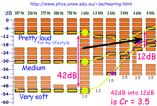

Here's me (on the tool Mooly linked):
Remember that HL is plotted upside-down to how we plot a microphone.
Audiology is founded on "can't hear" problems. So the reference test is very soft. By self-observation I hear OK in bass (thunder, distant Diesels), but terrible in treble (cymbals, speech sibilants). At "very soft" my treble HL rises (my hearing falls off) 33dB in 2.5 octaves 1KHz-6kHz. Even complete crap earbuds are not that bad.
However at "Medium" level only 15dB, and at "Loud" (live music, not live Who) my hearing is like +/-5dB.
A modern 1st-world hearing aid will compress the loss, which is what I was plotting here ("Cr=3.5").
Actually you never correct ALL the loss. You could not handle it after years/decades of muffle. "Half the loss" is a very old yet still useful guide. I'm taking 18dB boost @6kHz. Also limited by squeal, which is the next thing we will work on.
Yes, if you can hear but not understand your woman or children (etc etc etc), the UNSW hearing test is worth doing, with any generally satisfactory headphones. (Not ones YOU selected for excess highs, not noise-cancellers which may be modifying the clean sound.)
In many lands a hearing test is cheap or free. My state is over-regulated and my ex-work insurance is un-woke, so I paid $90 for a basic diagnostic. Other states, aid sales shops can offer free testing.
