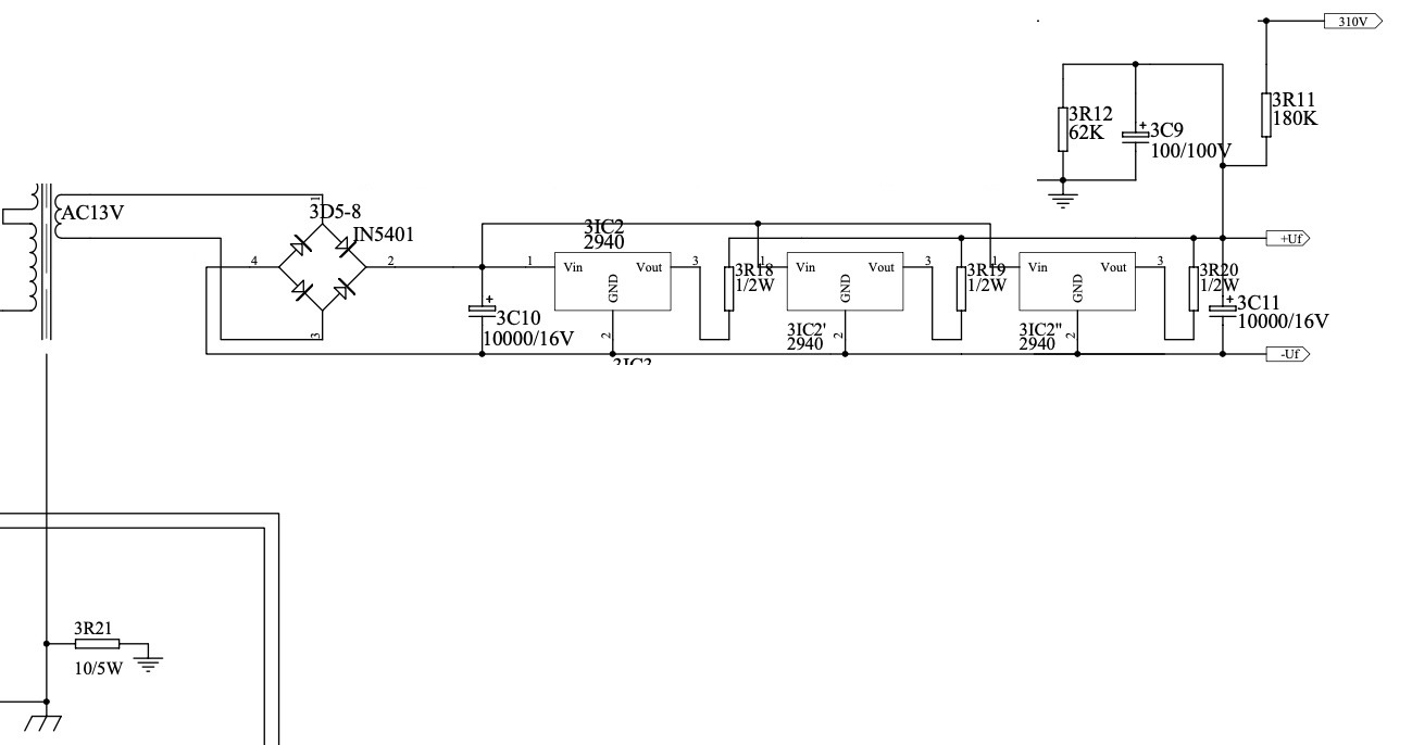

Now, in this preamp heaters are DC powered. here is an extract of the power supply schema:
First thing I noticed: although in the schematics the capacitor "3C10" is described as a 10000uF/16V, the one soldered in my preamp is 8800uF 25V. I assume this is good as well for its purpose, but not 100% sure.
Now, I've measured the rectified voltage between +Uf and -Uf with a multimeter and it stays around 11.80V. That's already a little bit strange, as it should be at least 12V. I assume that the 2940 here are the 12V ones, I cannot read it from the soldered one as they are too close to each other and cannot read the specs on them.
I also assume the designer has put three 2940 in parallel to obtain more juice (current) for the heaters (my preamp has a total of 8 tubes, n.4 12AX7 for the phono stage and n.4 12AT7 for the line stage).
With the scope, bypassing the DC, I've measured this strange signal (still between +Uf and -Uf):
It is around 20mV wide and the frequency is around 100Hz.
What do you experienced guys think? Is such level of noise normal with 2940 regulators? Or could this be the reason of the hum I'm hearing?

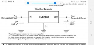

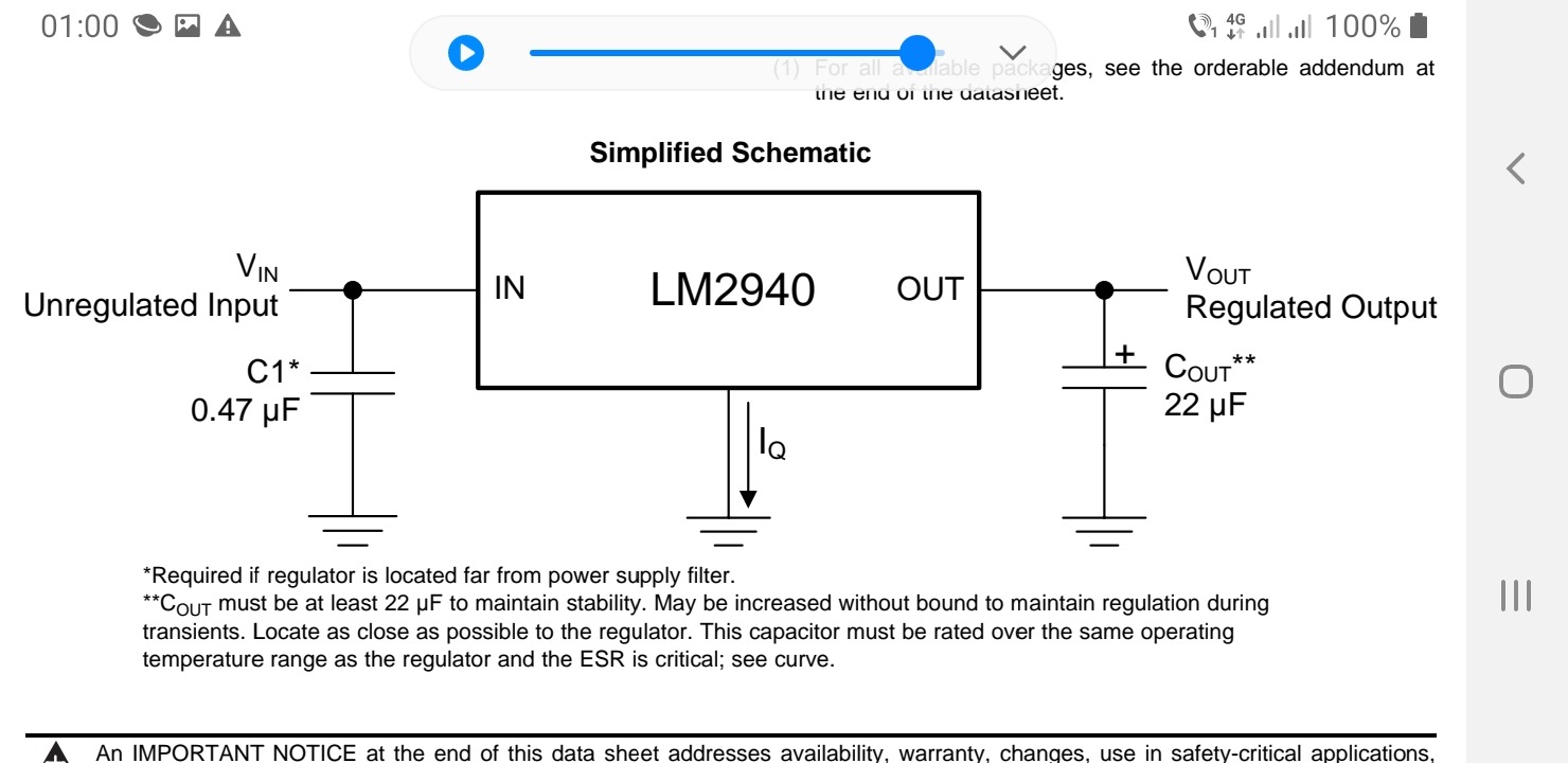

Yes, a 22uF or larger capacitor MUST be connected directly at the output pin of each regulator.
It's not just a good idea, it's the law. Also there must be > 3VDC across each regulator at all times,
including any input ripple minimum voltage sag.
The output capacitor ESR is somewhat critical for this regulator, needing > 30 mOhms and < 3 Ohms.
See figure 20 in the data sheet. How old is this preamp, the capacitors may be out of spec.

Aggreed - 20 mV of hum on the heater supply is nothing. Is either side of the heater supply grounded, or is it totally floating? Capacitance from primary to secondary can pass noise, which is common mode - regulators and filters don't stop it. If it's not grounded, ground -Uf at the input stage.
But it could be inductive pickup from the heater supply - the peak current will be 6A or more to get 1.2A of heater current. And there's full mains voltage somewhere in that box... hope it's far away from inputs!
I think the +Uf is elevated, and goes to ground through a 62Kohm resistor.
This is a more extended extract of the schema:
Yes, inputs are far away and isolated by an aluminium shield.
You could try using Schottky diodes to get a slightly higher voltage for 3C11 (before the regulators). This would give the regulators a bit more headroom. The only disadvantage could be a slightly higher dissipation in your regulators.

You only need to rule out the fillament of the first tube in the amplification chain.i'd put 100uF at the output of the Ic supplying it.Then the fillament potential lifting is better done with two resistors of 220k...1Megohm leaving that divider node and touching both ends of the first tube fillament.Also better to replace 3r21=10 ohms with 10nF capacitor
