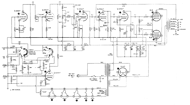

I may be getting a Heathkit A9 in decent condition with no tubes and a replaced power transformer soon.
I looked at the schematic and given my experience with tube amps and recently discovering how easy it is to do fixed bias instead of cathode bias, I may do that as it will improve the bass response.
Now in order to do another mod which is to increase the B+ cap value the output transformer connects to so that the amp can handle the bass better (did that mod and the fixed bias mod to a Magnavox AMP-142 and the sound quality improved a good bit) I'd have to go with a solid state power supply unless I go with a higher voltage power transformer, however losing the 5U4 will reduce the heat the amp puts out.
I can either use a lower voltage power transformer (may be replacing it anyways depending on what was stuck in there in place of the original) and a solid state supply or I can use the same voltage and add a filter cap after the diodes and a choke between the first and second filter caps to drop the voltage some and provide better filtering which will also reduce the initial surge current of the larger filter cap.
How much B- voltage should I have on the 6L6 control grids and what idle cathode current should I run them at?
That said if I'm reading the schematic right, there's no cap across the 6L6 cathode resistor. So one benefit of fixed bias which is getting rid of that pesky cathode bypass cap will not be realized so do I really need to mod it for fixed bias?
Now I've tested amps before with no cathode bypass cap and if I remember correctly that wasn't always the best option far as audio quality goes. I forget exactly what problem I saw with an amp that had no cathode bypass cap on the push pull output tube cathode resistor, but I know there was some issue.
I do know that in order to limit the effect of Miller capacitance I will need to replace the 1 meg volume control with a 100k volume control and I'll up the value of other coupling caps in the amp to reduce the phase shift at 20Hz to near zero as that will also improve the sound quality plus eliminate any potential bass instability issues caused by the phase shift. My way of thinking is if the phase shift is not there, it cannot cause problems.
As I typically do, I'll restore this amp to stock before making those two major mods just to see how well the amp works. That way I have a good baseline of what to expect from the amp.
EDIT:
It looks like I can maybe connect the line level input straight to the volume control as the tuner input uses a 1meg series resistor that connects to a 18k ressitor which goes to ground. So it attenuates the signal pretty heavily then steps it back up with the 12AX7.
Now if I do that and it works I'll install a 1/4" switched jack so that the original amp inputs can still function as designed when nothing is plugged into the jack.
The schematic.

Just looked at the photo of the front panel and it's actually the A9C.
I could, but I need a 1/4" switched jack as I want to feed the line input to the volume control given how much the signal level is being reduced by the resistors on the line input.
There is a 1 meg series resistor and a 18k resistor after it to ground.
For the specified 600mVrms input that gives me an output of 11mVrms.
I think reducing the line level input that much only to amplify it by the preamp stage is dumb as it could potentially reduce the audio quality.
Now if I do that, the output will be inverted phase given I'll be bypassing one 12AX7 stage which might not be a good idea.
What I'll do is restore the amp to 100% stock then thoroughly test it before deciding if any mod needs to be done.
I will definitely be changing the stock 1 meg volume control to a 100k volume control given the 1 meg pot will cause miller capacitance issues which will reduce the treble some unless the amp compensates for that.
A frequency response test will determine how flat the amp is. I'll run the test with the volume control near full CCW, mid position and full CW to get an idea what if any treble is being lost due to miller capacitance effects with the stock volume control.
I will also do a low frequency response test to see how much if any phase shift is present. I know some coupling caps may need to be increased in size to eliminate low frequency phase shift, but the test will reveal which ones to up in value.
Now the 18k resistor after the 1 meg resistor on the line input will keep the second 12AX7 stage from having miller capacitance effects.
What I may do is this.
If the amp reduces the treble some and I find the input stage is causing it, I'll just disconnect the line in jack and the 12AX7 output, connect the line in jack to the coupling cap that went to the 12AX7 plate and reverse the speaker wire connections at the output. That way I add no extra holes and it can be easily reversed. I'll also update the schematic to reflect that change.
Is there a cleaner schematic than what I found available online in a brief search, or is that the best one available for download?
Also it looks like maybe Heathkit knew the issues cathode bypass caps cause so eliminated them everywhere except the one spot where the higher gain was needed.
Also given the 560 ohm resistor right after the rectifier, I can easily up the value of the first filter cap to 200uF no problem. Only reason I can figure for that resistor being there is it reduces the B+ some which may have been done when they switched to the 5V4 rectifier given it drops less voltage than the 5U4.

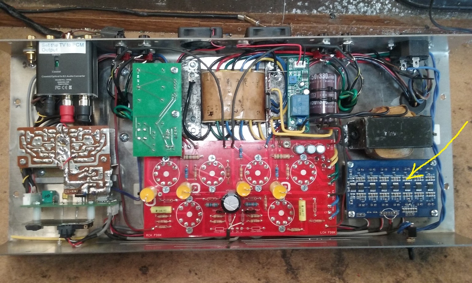

Also what is the general consensus about using a small four band analog EQ such as the Schiit Loki Mini+ https://www.amazon.com/Nobsound-Cur...n/dp/B0BYMK2XCM/ref=sr_1_1?crid=1Y9I0JI2WFYC1 before the amp to give more control over the tone and also to insure the amp sees a low impedance source (75 ohms) to eliminate miller capacitance issues?
Haven't seen that discussed much...
But my thinking was same as yours. We all have different sound tastes, acoustical environments, and speaker types. I added 7 band EQ to front end of my PP amp and will do it again in future designs-
https://www.aliexpress.us/item/3256805001763519.html?
Some may disagree- perhaps opinion that it takes away from a pure 'tube sound', but imo- to each his listening own
Jim
That board is interesting in that it has two sets of inputs and outputs. I'm assuming the inputs are in parallel as well as the outputs.
Indeed some think it takes away from the pure tube sound, however I bet most of them are feeding their tube amp with a DAC or other source that is solid state unless all they listen to is a tube tuner, reel to reel with tubes in it and/or or a tube phono preamp.

I did find a real legible schematic with the voltages listed which is nice. Only thing I am unsure of is what output transformer tap the feedback resistor connects to.
