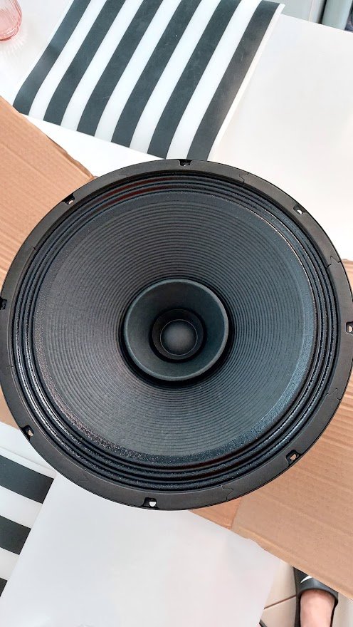

my name is Vincent and I own and run a studio/record label in a small village in Germany called binary pleasures.
I was interested in sounds and textures from a very young age and also love repairing and modifying electronics and equipment I use to work on music.
Now I would love to slowly step into the DIY speaker game but I am very overwhelmed by all the information both in the physical (acoustical) and electronic domain.

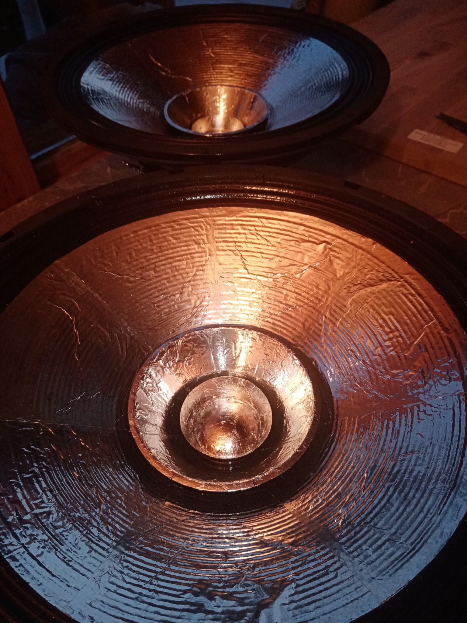

Hello Vincent, I like these 15 inch fullranges most, I aluminized them (my thread):
The drivers are ready. Will see if I manage to install them and make measurements.
Aluminized small double cone with thin foil from the goldsmith.
as a studio engineer I would go for the 15 inch (difficult to get as it is out of stock) or the 12 inch.
Here review about dsp use to get a linear speaker.
https://www.audiosciencereview.com/...eaker-based-project.39025/page-6#post-1900198
I would put it in a low tuned reflex box. And for availability take the 12 inch and aluminize it.
I would not correct loudspeakers in main listening position but only in the nearfield correcting the driver itself, not the room.
Nice music you make!
