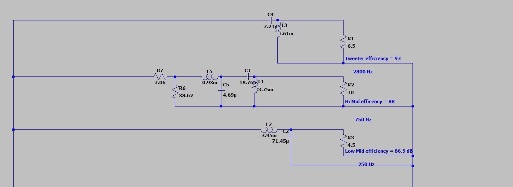

Hello! Im not a big Hi Fi audio person, so sorry if these questions are stupid 🙂
Anyways, I need to design a setup. The setup in question has a Woofer (4.5 ohms where I need it to crossover), a midrange speaker (10 ohms where I need it to cross over), and a tweeter (6.5 ohms where I need it to cross over). One of the speakers (the woofer) has a hump between 300-600 hz, so I need to begin my decent for the crossover before that. For the lower range of the mid, the crossover should be at 600 hz. I would like to use a 2nd order butterworth for all of this with a Q of 0.707.
the higher end is slightly more standard, however, I think i need to use an LPAD filter, because the efficiency of the tweeter is around 6db higher than that of the woofer.
Im starting to design the situation in spice. I have attached what I have so far.
I started to add the LPADs on the midrange speaker, but not the tweeter yet. The problem is that in the graph, the midrange speaker is slanted on the top and I have no idea why. Ive tried using calculators, but every one gives me a different answer. If anyone can help by explaining what I need to do or giving me equations so I can calculate it, that would be great! sorry this is so specific, it is for someone who is extremely particular in what they want. hopefully this doesn't sound too crazy and is possible to do.
Thanks so much and I look forward to hearing from you soon!

Looks to me like it's because your bandpass filter is relatively narrow and your inductor/capacitor choice for the low-pass is contributing also. Xsim is suggesting 0.787 mH and 4.02 µF for 2800 Hz, 2nd order, with Q of .707. That gives a more symmetrical shape. Bandpass calculations are often not that straightforward though, so it may need fine tuning in the end to meet a target curve.
Also, your model will be inaccurate if you base it on flat resistance (unless that's what your speaker has - which is typically only true of a planar unit or one that includes impedance equalizing circuits).
In your original circuit, lowering L5 to 0.62 mH gets things closer to your target (in Xsim, anyway).
And no questions like these are stupid. Everyone starts at zero, and many of the details are not obvious, so some guidance is bound to be needed here and there no matter how diligent you try to be.
Xsim is a free crossover modeler by Bill Waslo. It includes CircuitBlocks for some standard crossover functions, which can be helpful for sanity checking basic component values.

In practice, designing only electrical filters without considering the true acoustic characteristics of each speaker will not give good results.
It is advisable to make acoustic measurements of each speaker, or at least of the midrange and tweeter, and to calculate the enclosure volume for the woofer by knowing its Thiele Small parameters.
And then simulate the filters in VituixCAD or XSim. Then the best results are guaranteed.
