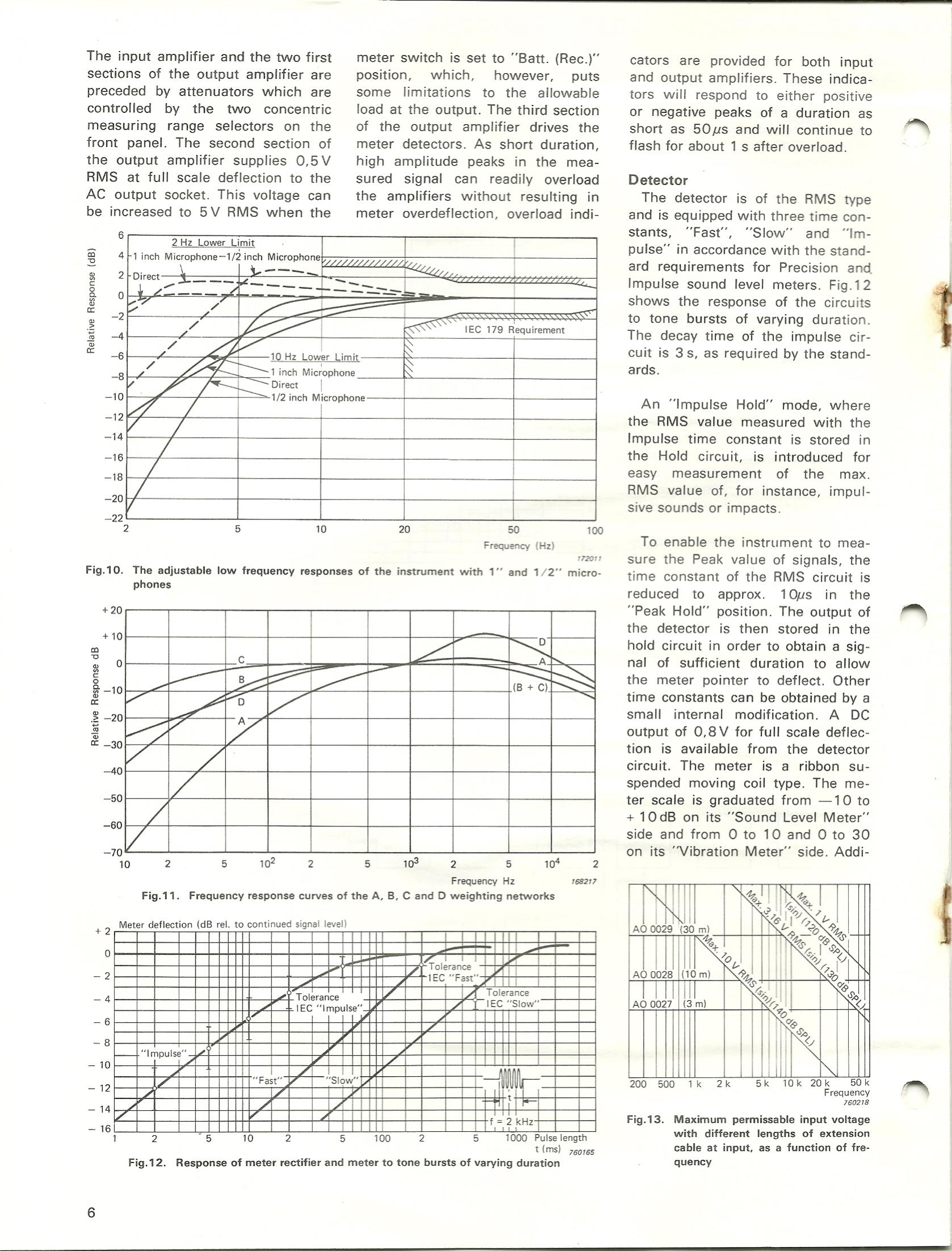

You have not provided very much information regarding exactly what you are doing. Assuming you are referring to a Bruel & Kjaer 2209 impulse sound level meter, this meter has built in selectable weighting (filtering) networks D, A, B, & C plus linear. Weighting networks alter the response of the instrument at different frequencies. Please refer to figure 11 below. Depending on just what you are measuring, you may not have any trouble with the instrument.

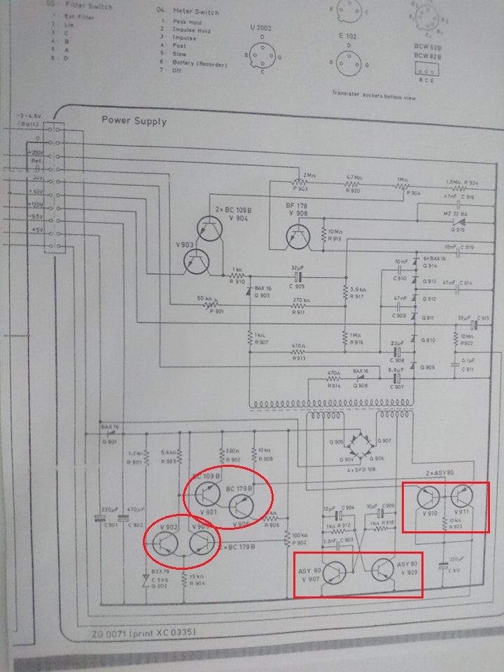

I started the calibration and adjustment procedure
I checked the power supply. The voltage in the center transformer
is w/in spec as shown on my schematic attachment.
8.5 Vdc measured vs. 5V schematic.
-4.12 Vdc measured vs. -9.5V schematic.
-3.6 Vdc measured vs. -2.9V schematic.🙁

Modification in measurements
-8.5 Vdc measured vs. -9.5V schematic.
4.12 Vdc measured vs. +5V schematic.

That seems to me to be close enough.
My first shotgun effort would be to replace the 40 year old electrolytics. Then check each transistor with a scope to see that they are all switching. If the doc's give you some input on the switching frequency you can get a sense for how much of the circuitry is working.
The 10 uF C904/C906 would be my first stop since they are part of the oscillator.
The bias supply for the microphone is at about 1/2 which would explain a -6 dB sensitivity.

Usually the next step (probably should have been earlier) is to disconnect the loads to see if any of them are drawing too much power. It isn't easy on a dense portable instrument like this but it's the next troubleshooting step. However since the supply is all on one PCB it seems you may be able to disconnect it and measure what happens with no load. Typically with this type of circuit if any load draws too much it affects all the supplies.
