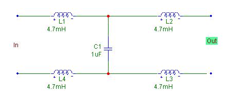

Self Made AC Filter

Before the transformator i had a AC filter
You have thus learnt a valuable lesson - a mains filter usually does more harm than good.

Line Filter
Hi Maarten, You did not use a current compensated coil or a ready made filter by Corcom or Schaffner for example?
maartentje said:Hai,
This is the filter i used....
Maarten
