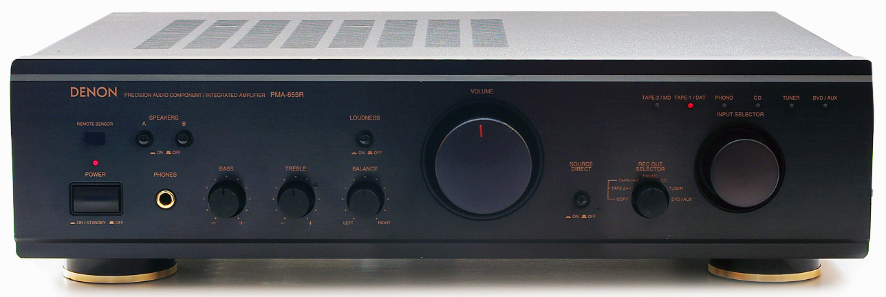

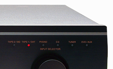

I have a problem with my Denon PMA-655R amplifier. The source input selector starts to "jump" or shift by itself suddenly. It's really annoying when listening to the Tuner and then it goes to the CD or to the Tape 1.
Any Denon user knows or had experienced this before?? How to solve this?

Many thanks!!
After read your comment I opened the amplifier tonight and, although it was a nightmare to reach the selector switch, I was able to cleaned it. Now the problem seems to be fixed!
I though it could be the relay on the main board and I didn't want to fix it (the relay) cause this amp is quite difficult to work on.

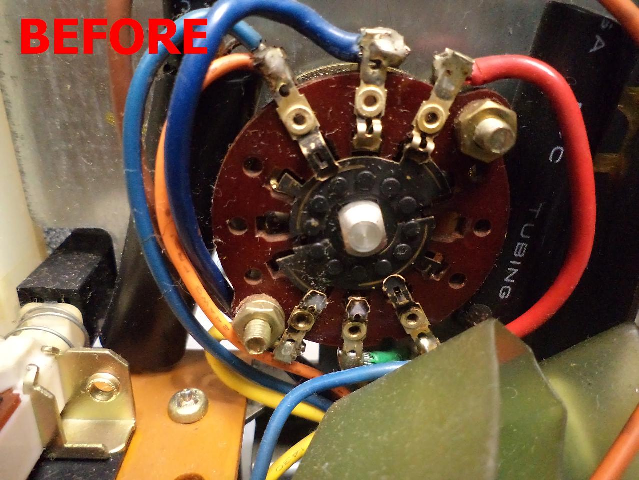

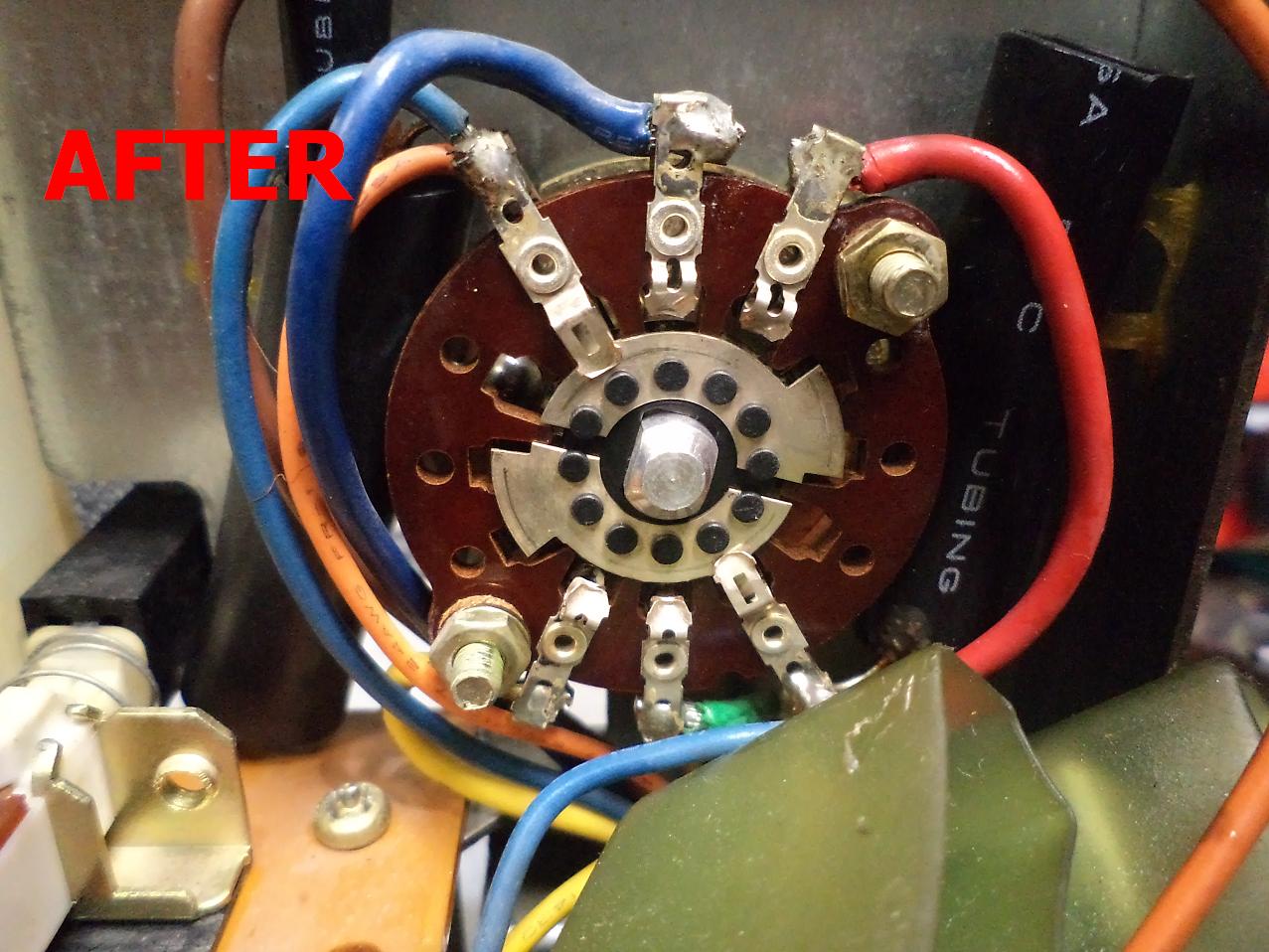

here is a picture of how an open switch is cleaned before and after ultrasonic .... For sealed switches we use pharmaceutical needles to inject our chemical product inside work the switch inside out and done !! Then you have to rinse flush the ammonia based chemical and relubricate teh switch with a very small bit of WD40
For lubrication it will be enough to spray with WD40 then clean the WD40 thoroughly with pressurized air and relay on the left overs of the WD40 to do the lubrication ...most of the time is enough ....

try to spray any open switch that you might have in your shop to realize the cleaning ability of your spray ...
If you are in the service business operating 1000 audio devices per year one thing that you dont want is a customer that pay a complete rebuild of a vintage amplifier to come back after 4-5 months while still on guarantee with scratchy or squeeky pots
We never looked for a temporary solution or a quick fix we actually wanted something that will last for more than 10-20 years ( this is how much time it took for the switch to become that black )
Both ultrasonic , ammonia based cleaning solution ( with a few more things inside obviously ) and lubrication actually did the trick ...
