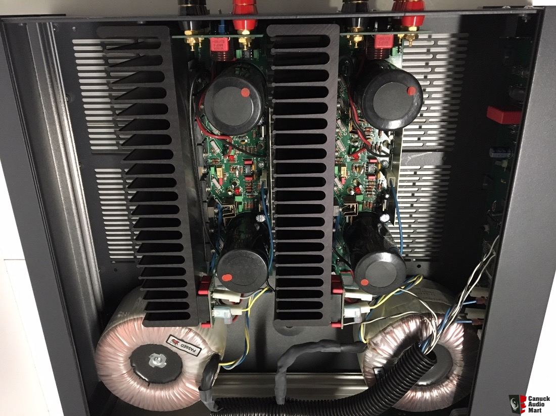

This intermittent buzzing comes and goes at random. I may catch it for 5 or 10 seconds once in a month, or as often as every hour or two for the entire length of my listening session. It starts then stops and all seems well. The amp sounds ok otherwise.
A few of the symptoms are as follows...
Right channel only
Does not get louder when volume is increased. Its not even noticeable when the volume is up. I can't even tell its occurring until I decrease the volume or catch it between tracks.
It stops and starts at random. Its happening more frequently today, still very sporadically. Yesterday during my listen I never heard it once.
I'm hoping its something simple, like a loose ground or inferior cap inside. I can't afford to pay a tech and will be system less if I'm not able to track down myself. I'm not sure if I'm pushing my luck by using the amp before it can be resolved. Hopfully more damage doesn't result. I can't afford to replace a 4k amp right now. I can't even afford to pay a tech to look at it.
I was hoping someone could possibly offer some kind of check list that might help me narrow it down?

The problem is in the power amplifier section of the right hand channel. That narrows done the possibilities quite a lot. Assuming the unit is a conventional post 1970 mass produced integrated amplifier, the source of the problem will not be in the wiring or controls, but will be on the circuit board The problem is intermittent. Most intermittent problems are faulty joints. On a circuit board most faulty joints are 'dry joints' AKA failed solder joints, or very occasionally in some '70s and '80s gear oxidised 'wire wrap' posts used for connections to the circuit board.
Dry joints can be identified by their mottled appearance (rather than shiny) or by hairline cracks through the solder - you might need a magnifying glass to see. They are most often either a result of poor soldering at time of manufacture, or by heat from hot components that were not stood off the circuit board far enough. Look for discoloured (toasted) PCB substrate too see if excess heat is involved. Intermittent connection can also result from hairline cracks in the printed circuit, which is often impossible to see.
The simplest and fastest way to approach a problem like yours is to simply re-solder the entire part of the circuit at fault. Identify the power amplifier section of the right hand channel and retouch all of the solder pads. If that fixes it, great! When you do the re-solder the chances are you will see what caused the problem. If the fault was heat related solder breakdown, the other channel is likely not far behind so re-solder that one as well.
If re-soldering doesn't fix it, then the next step is to start prodding around the circuit board with a chopstick (best to use a dim bulb current limiter and crappo speakers when doing this). Flex the circuit board by pressing on it, push against each component standing off the circuit board, and tap the circuit board all over the place and see if you can make the fault come and go, then narrow down to the most sensitive location. Good luck!

Its a Madrigal designed and built Mark Levinson. True balanced/ dual monaural design. Essentially its a ML in a different case. The only think that suggest its a ML on the outer case is the colours. https://skyfiaudio.com/products/proceed-from-mark-levinson-amp2-amplifierThe problem is in the power amplifier section of the right hand channel. That narrows done the possibilities quite a lot. Assuming the unit is a conventional post 1970 mass produced integrated amplifier, the source of the problem will not be in the wiring or controls, but will be on the circuit board The problem is intermittent. Most intermittent problems are faulty joints. On a circuit board most faulty joints are 'dry joints' AKA failed solder joints, or very occasionally in some '70s and '80s gear oxidised 'wire wrap' posts used for connections to the circuit board.

Good to know, and thanks. Because it almost makes my Bryston and Nad Bee integrated boring, I missed it while un-hooked.
I'm not a tech but it doesn't look like theres a whole lot there to weigh 48 lbs. I'll pop the top off mine and have a look around in a couple days, when feeling better.

By process of elimination I narrowed it down. I changed every connection, the power wire then finally the speakers, the noise always came back. The last time it occurred I managed to switch off the preamp essentially isolating everything upstream. I'm 100% sure the trouble exists in the right channel of the amp.A basic diagnostic step is to eliminate external effects. I suggest removing all connections except one pair of speakers. If you have some shorting plugs use them to short the inputs. Leave the unit running like this when you are not using it and see is the buzz occurs. If it doesn't the fault may be upstream in the preamp.

I was relieved to hear potential cracked solder joint/s. By reading around these particular amps are pretty reliable work horses. Thanks again. Since I got it it I haven't lifted it off the amp stand. But I had to have it shipped half way across Canada to buy it, perhaps it was bumped along the way. I'll upload some pictures with the top off when I get the time to have a look inside it.

I powered up the amp this morning, its dead silent, in fact the quietest amplifier I've ever owned. So far its being good to me, there are no noises in the way of humms or buzzes, it sounds incredible actually.. the late NAD 326 Bee I had playing previously doesn't come anywhere close to it in terms of sound quality. I'll take a big hit it if it dies. I'll get in there with some chop sticks this afternoon. To look for cracked solder joints.
what is the function of the circuit board on the right side of the picture? Does the input signal go through the board on the right?
