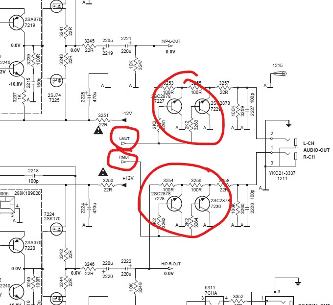

I received a Marantz CD 6000 OSE with a non-working RCA output.

The output of RCA at the first power on was very very feeble, then it fully disappeared. The optical exit it's working right.

Hearing a buzz suggests something else tbh... but you still need to check the mute.
The mute transistors are the two pairs shown here. The control lines, LMUT and RMUT should be at a negative voltage when playing normally. Those lines will go high to mute.
So that is the first check really.
The headphone output has similar muting. If the control lines are correct and the headphone feed is also faulty then the problem will not be any of those transistors.

Unless you do some measurements it is all guesswork 🙂 The proper test is to look with an oscilloscope at the output from the opamps (discrete opamps here) as that will be unaffected by the mute...
If you can't do that then you must at least measure the the control lines voltages as I mentioned earlier.
If you remove the mute transistors then you 100% prove/disprove that there is a problem around there. With them removed it is always unmuted.
Just check the voltages 🙂 and try headphones.
The headphones out has the same faulty behaviour. For the mesurement I'll try the voltage this weekend 🙂
That test means the mute transistors are almost certainly OK but you do need to measure the control voltages next.
Its only a two minute job to do that 🙂
If that doesn't reveal any clues then it all gets much more involved and you would probably need an oscilloscope to investigate further.

I found transistors and multimeter 🙂
They all four measure -11.80V while the player is spinning... but I don't have an oscilloscope

-11 volts means all the transistors should be off (so not muted).
I'm afraid it does sound like this is going to be outside your comfort zone... use of and knowing how to use an oscilloscope is essential here.
