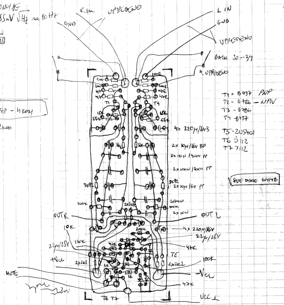

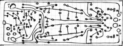

It appears at first glance that the DH102 DH111 and DH112 are pretty much the same thing.
Assuming Zen Mod's drawings were from the DH112, then the DH102 looks the same to me at a quick glance too. The Hafler manual for the DH110 states that the DH111 and DH112 "differ in electrical and mechanical configuration" but who knows, it may just be metal film resistors in the newer versions instead what looks like carbon film in the DH102.
I went to some trouble to make a power supply to match the DH102 (18 V each rail) to the DH110 which had 23V taps for the DH111 and DH112 power supply, but the transitors are the same in Zen Mod's drawing as in the DH102.
Zen Mod, are your drawings from the DH112?

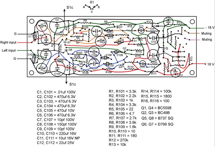

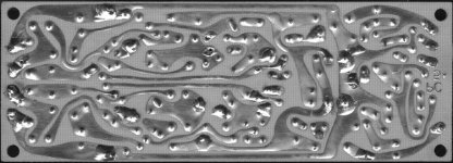

Baldric, let me know if you need the installation instructions for the DH102. Attached are a scan of the copper reversed so it matches the component side, and my circuit trace and list which should overlap the copper scan. The values for the bypass caps may be off; I had a hard time reading the stamps and I did not get consistent readings from the caps themselves.

yup - DH112 ;
also enclosed in rectangle case , with small switch - when xase is mounted inside DH101 pre , that switch is protruding to DH101 bottom plate .
all resistors (except few) are/were carbon ones
I'm off to the races with this information. Installing it is pretty simple if you know where the power taps are and the signal points.
I've been lucky lately. I've come across a complete functioning DH112 since this thread started. It appears that the blank PCB for the DH102 I got is identical.
BTW this is a pretty darn fine headamp coupled with the internal phono section of the DH110 preamp. It makes a pretty kick*ss combination, especially with my P3-RB300-ATOC9 setup.
Now I'm set to work on my so-called DH102 board. It'll be a DH112 in no time. Thanks guys.
