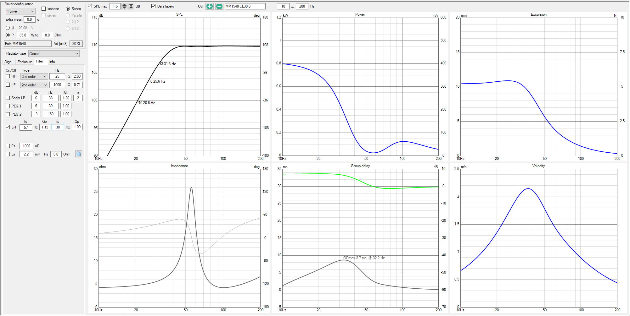

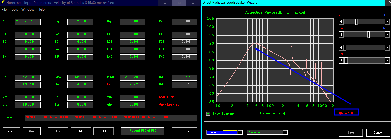

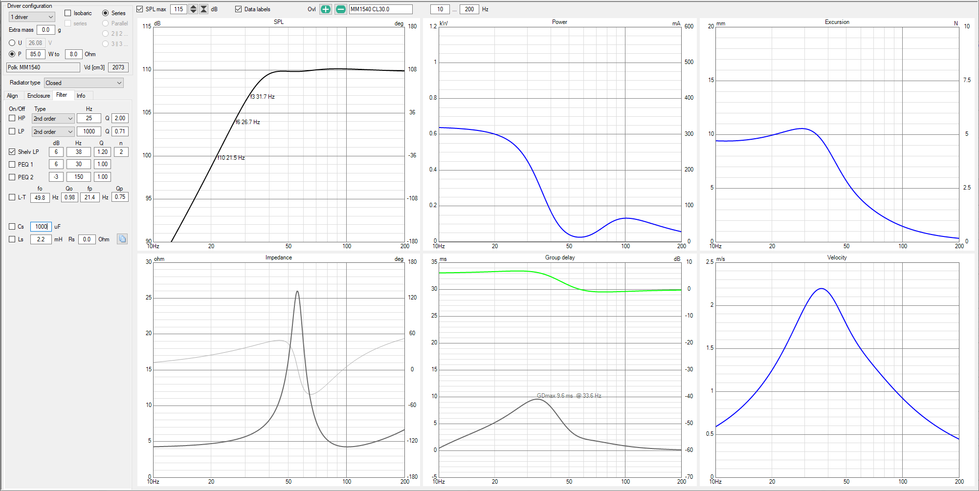

Here are some exploratory feasibility studies of various designs using the Polk MM1540 15-inch woofer.
In the manufacturer-recommended 45-litre sealed enclosure, the following low-frequency response is produced:
Reducing the enclosure volume to 30 litres and adding a Linkwitz Transform EQ produces the following. The f3 point is reduced by 12.3Hz, and the power required at 20Hz is about 650W.
Reducing the enclosure volume to 30 litres and adding an LP Shelf EQ produces the following results. The f3 point is reduced by 11.9Hz, and the power required at 20Hz is about 600W.
