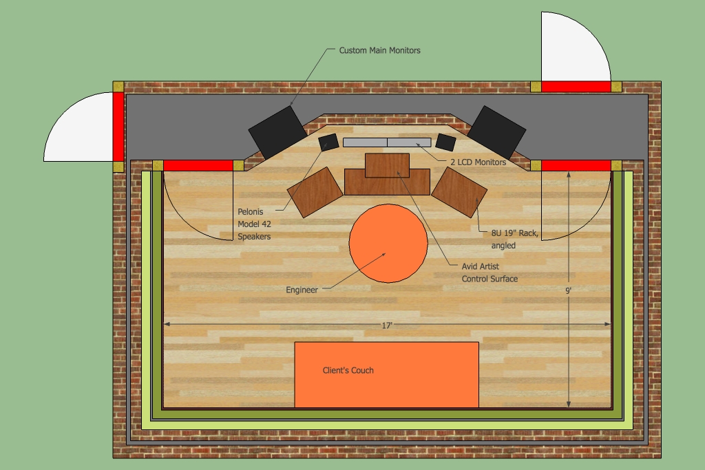

A couple of years, I had started on this project, bought a bunch of drivers... but it got put on hold... This time its for real... I am helping a friend set up his studio. Walls are being demolished as I type this, and the new walls will be completed to my specs in about a month. He has given me a free hand with the design of the studio and the monitoring system. The tentative layout of the studio is attached herewith. The space currently allocated for the flush mounted speakers is 20" width, 16" depth and height is to be decided, depending on which way the design heads.
I already have a pair of NOS Exodus Audio Tempest X15s to handle duties below 100 Hz. I will definitely use a 2x6 loudspeaker management system... the DEQX HDP Express II, if we can afford it... if not, we will resort to some Behringer DCX2496 type device, until finances permit us to upgrade to the DEQX.
Now, I want a 12"+ coaxial speaker to complete the driver complement. I want it to be coaxial for two reasons : 1. The engineer will be seated relatively close to the speakers, so the path length differences between sounds coming from the mid-woofer and HF driver can become a serious issue, if they are not dual concentric... and 2. I used to work with Tannoy DMT15s and I have never enjoyed working on any speaker more... just my personal experience/opinion.
The other requirement is that it should be able play loud... at least 110 dB continuously, with peaks of 120 dB+ (@ 1m)
The amps will most probably be QSC GX7 for the subs and its smaller siblings for the mid-woofer and HF driver.
So... help me pick a coaxial driver to take me forward with this design. Specifically, I would like a sealed enclosure for the mid-bass unit, which goes down to 100 Hz comfortably - and can produce the SPL I want, in the form factor I mentioned.

Video editing/post production suite?
Audio recording and mix studio. The front wall will be hard - extending the baffle of the flush mounted speaker. The floor will be hard. Every other surface will be as completely absorbent as I can make it, with the usage of metal and membrane trapping and insulation. This is inspired by the Non Environment approach propagated by Tom Hidley / Philip Newell.

Mr. Danley - honoured to have you on board. Everyone says that a smaller mid-woofer - 5" - 8" has the best mid-range clarity and dispersion - and integrates better with the HF driver. I have no doubt that this is true. I'm coming from a different place, and I hope my explanation makes sense.
I am a sound engineer... I record and mix music for a living. Like many engineers of my generation, I am self taught, and can easily be confounded by technology. Anyway - every time I take a track I have done a stereo mix on to a film mix stage, I hear things in the low end, that I never heard in my studio. I imagined that it was the acoustics in my small room that was leading to muddiness and lack of clarity in the bass. Over the years, I have had several sets of standard studio nearfields with competent subwoofers, and the low end has consistently been a problem. Last year, I built a pair of Econowaves (RIP Zilch) with 12" Dayton woofers, in huge 170L cabinets - and whoa! there it was, the missing clarity in the bass! I was hearing the low end like I was hearing it in the film mix stages... So I have concluded that for me to hear 100 Hz - 400 Hz the way I want to, I need it to come from a large driver in a large box. A three way, with crossover points @ around 400 Hz and 3 Khz, with a 5" midrange would appear to make sense, but then again, in this room, the listener is too close to the speaker for this to be an optimal choice...
In this case, there will be a pair of nearfield monitors, on which, in fact, most of the mixing will happen. The big monitors will come on when the engineer is checking the low end, or blasting it, to impress a client.

Note that in the "High End OB speaker" you refer to, extensive work has been done to get the response to sum flat at listening position and even then it is a little scary. High fidelity systems may not be the best base template for studio monitoring systems.
The 12" Beyma also has a very low Qts and some low end problems (I'm unsure to the exact nature of the problem, so treat it as heresy) which prevents its use on OBs - hence its availability only in the version with dedicated woofers. I suspect you may have issues in small sealed cabinets as well. My designs with the 15" versions of the same speakers pointed to a largish sealed box, with bass helpers running all the way to 100 -120Hz.
There are some major problems with coaxial speakers pointed out in the thread linked in the post and crossovers are an issue. However, for ultra-nearfield listening they are still a great option. A DEQx system would be a wise investment so you can take a lot of the guesswork out of the setup. I would prioritise the purchase of the front end before you get the actual drivers in place.
I would go for either the 12XA or 12CXA from the Beyma range, with the caveat that with the use case you have presented you will have to cross really low ~800Hz. Though the compression driver can handle it, power handling will suffer quite a bit (assume 50% of the rated 90W/1KHz power) though even that should be enough output for a 17x10 heavily treated room.
The 12XA cost around 50k a pair (CXA probably more), the Eminence with a good compression driver will cost half that. IME for translating mixes and overall performance, you will be equally able to work with either, as the Beyma has an edge mostly in power handling and bass distortion, and it doesn't look to me that either of those are going to be significant issues in your application.
