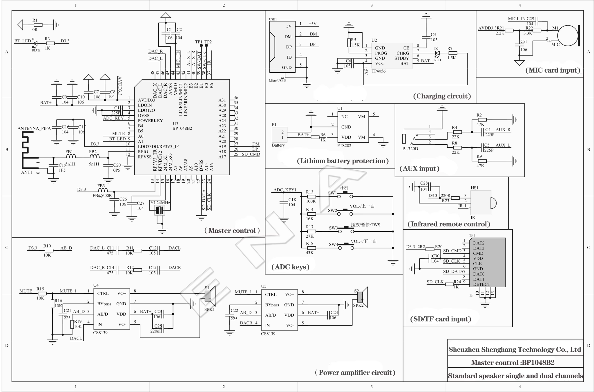

Do you mean this thing: https://www.aliexpress.com/i/3256805900869984.html?gatewayAdapt=4itemAdapt
If so, there is a schematic for what looks like part of it at: https://www.aliexpress.com/i/3256804589587740.html
And there is a datasheet on another part of it at: https://www.ti.com/product/TPA3116D2
Basically, you need to look at what you have there, and more or less reverse engineer it to figure out how to make it work.
Also, if you ask the seller for a schematic sometimes they will can get one for you, other times not. Usually worth a try.
Also, maybe some info on programming the BT module at: https://www.ti.com/product/TPA3116D2
Or, maybe this: https://www.arylic.com/products/acp...smSnofH-Iqp7U_PCmZ9MG4MXAgAO9320GCwfZwOIH2f10

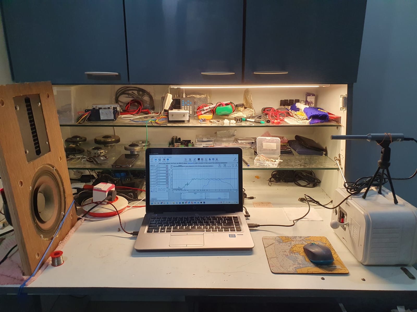

Hi Kyleag, Ive faced this issue too, mostly took place when the board was connected to ACP workbench and I was setting the eq to get a flat response. The solution was to remove the the signal feed from laptop and supply some feed directly to the input - in this case i just used my hand to feed it some grid noise - and it cleared up.

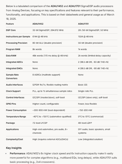

I am now looking for a Linkplay pcb as input - to stream, ADAU 1452 for processing and any decent D/A converter - all in one board solution.
I agree with you Wondom is good they have the following with ADAU 1701 , wish they had with 1452. Or if any one here makes one with 1452.
I'm not sure what you mean exactly. Do you mean while the bp1048b2 was hooked up to your laptop you got strange results? I'm using a USB to 4 pin header male plug cable I made to hook the chip to my laptop and feeding audio into the amplifier using RCA's that are wired to the BDM8's Bluetooth input ports. The BDM8 comes with the option to use AUX input or there's a header that shares AUX input with Bluetooth input. It comes with a jumper installed between the "KEY" pin and the right channel input to activate Bluetooth input. I have a switch that replaces this jumper so I can change between Bluetooth and RCA inputs. A problem I have often is getting the chip to switch back from Bluetooth to AUX input. When the jumper is removed from Bluetooth KEY pin its supposed to default to AUX input but it doesn't always work correctly and I have to power cycle the amp a few times. I honestly dont know how I get it to work again I may be doing something else to activate it that I don't realize. Is that the problem you had?
https://www.aliexpress.com/item/100...3e4100!12000034681998126!ct!BR!137474716!!1!0

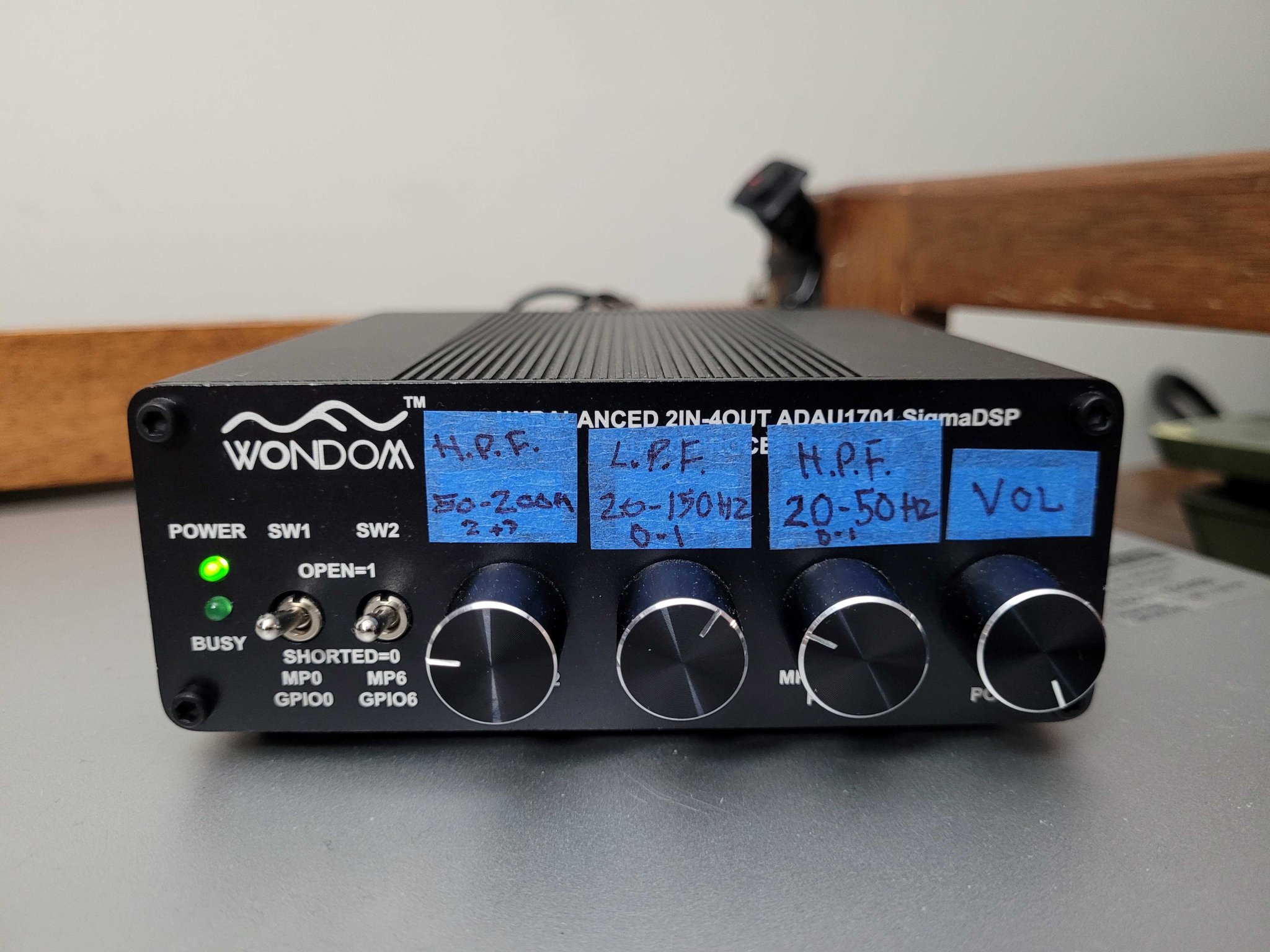

I actually have this from Wondom along with the newest programmer. It was the first product I purchased from them awhile back. I agree with you on the programmer not being integrated is very dumb in my opinion as there is plenty of space to fit it inside the enclosure. I haven't been able to do much with it other than change the program to a 2.1 set-up using simple filters because SIgma Studio is a steep learning curve for me! Sigma Studio was made for electrical engineers and I am far from one of them! I actually had a 3.3v voltage regulator go bad on mine recently and the board still powered on and you could program it but there was no audio output. That took me awhile to diagnose because I thought it had something to do with my programming rather than an actual hardware issue! It was the regulator that fed power to the digital volume control chip I a PT2259.
Why do you prefer the 1452 over the 1701? I thought the 1701 was the newer better DSP?

That's how I have mine set-up for now. I use it in my bedroom with 2 bookshelf speakers powered with a TDA7498E and an 8" subwoofer I made with a 150w plate amp. The 50-200HZ HPF is for the stereo channels going to the TDA7498E and the LPF/HPF is for the Subwoofer channels(2).
