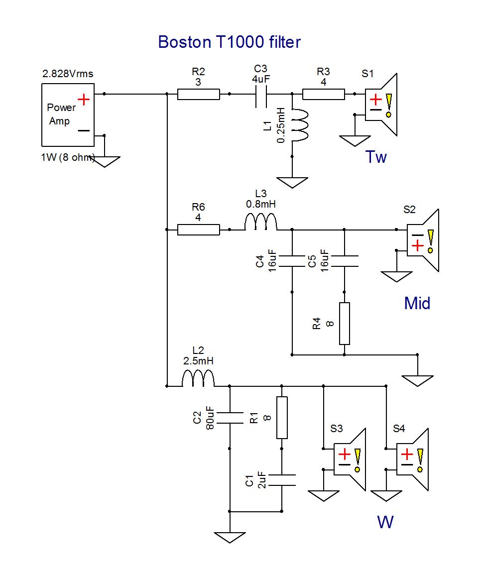

I have a Boston Acoustics T1000 crossover but I do not know how to wire it to the drivers or to the input from the driving amplifier. (I also have all the drivers)
This late 1980's 3-way speaker system has two 8 inch woofers, a 6.5 inch mid and 1 inch dome tweeter. Obviously they all have to be wired to the crossover and the whole business needs to have a + and a - terminal for connection to a driving amplifier.
I wrote Boston Acoustics and they could offer no guidance.
Can someone help me figure out how to wire this up?
I've drawn the schematic and taken a photo of the crossover. Some wires were still connected to the crossover - these wires lead to drivers and to the speaker systems's pair of input terminals, one + and one -. I've indicated these connection points on the schematic, and the labeled points' letter correspond between schematic and photo.
