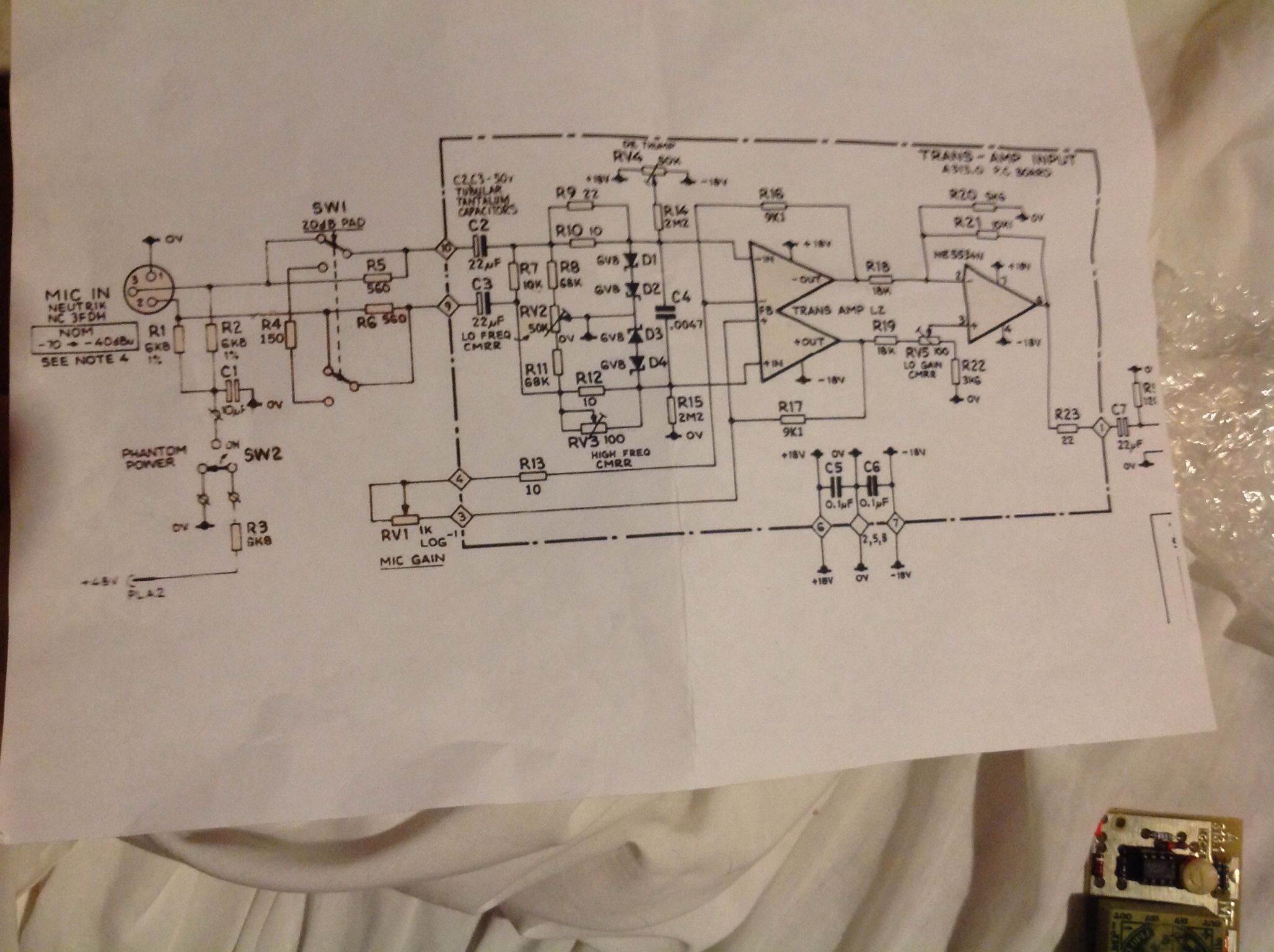

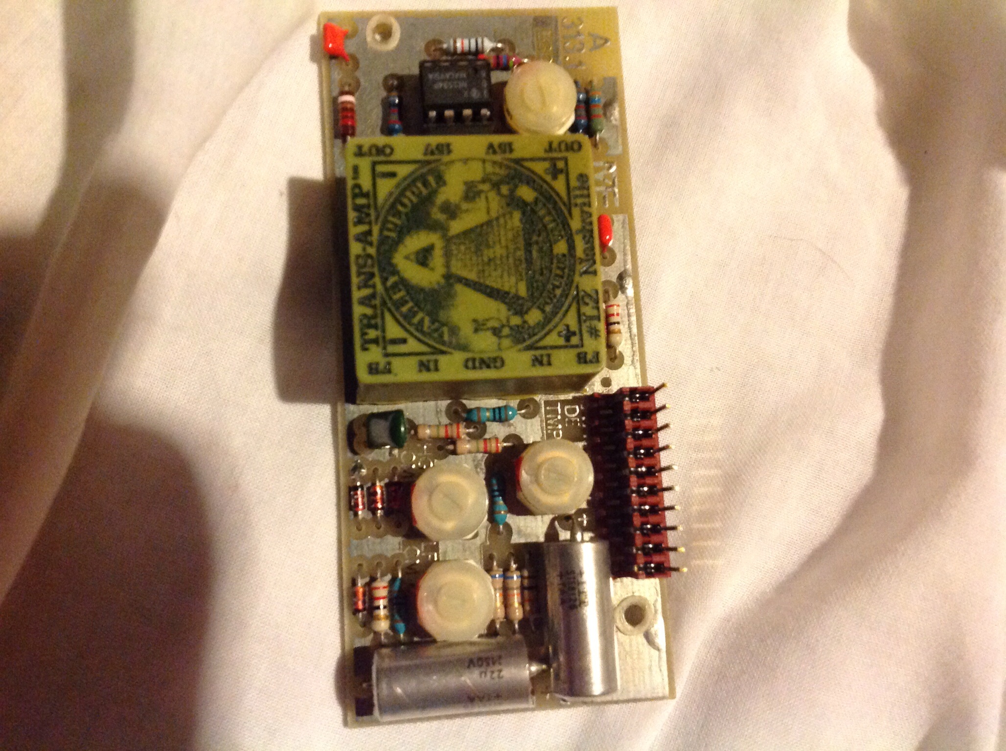

Hi, I'm new to both this website and this project that I'm about to take on.
I bought this circuit on eBay hoping to build a preamp unit from it.
It doesn't seem to be as straight forward as I would have liked but nevertheless it should be a good learning experience...
I don't totally understand where to connect input,power and output.
The more I look at it the more it seems that I have to create a circuit at either end.
From the schematic I think that I understand what is needed component wise but not sure what exactly to do for output.

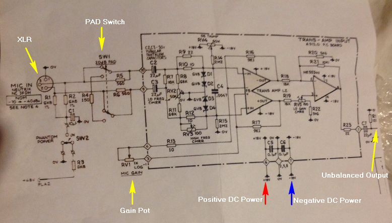

Basically can I connect a input xlr,output xlr,pad switch and a gain pot?
I'm not concerned about phantom power at this point just want to see if it works
and how it sounds.

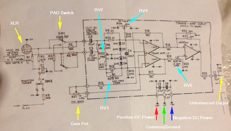

RV2 & RV3 & RV5 are to optimise CMRR = Common Mode Ratio Reduction, not eq. If you don't have an Oscilliscope to test & alter them correctly, you "could" easily screw things up !
RV4 looks like a DC offset control. Again if not set properly, it will mess things up.
Quite honestly if you're not sure of what you're doing, i would go for a more simpler, but still good, circuit. Where in the world are you ? When you let me know i'll give a link to some vendors that should be able to supply what you need.
Australia, OK. ESP has a number of highly regarded designs, & PCBs are available for a number of them.
