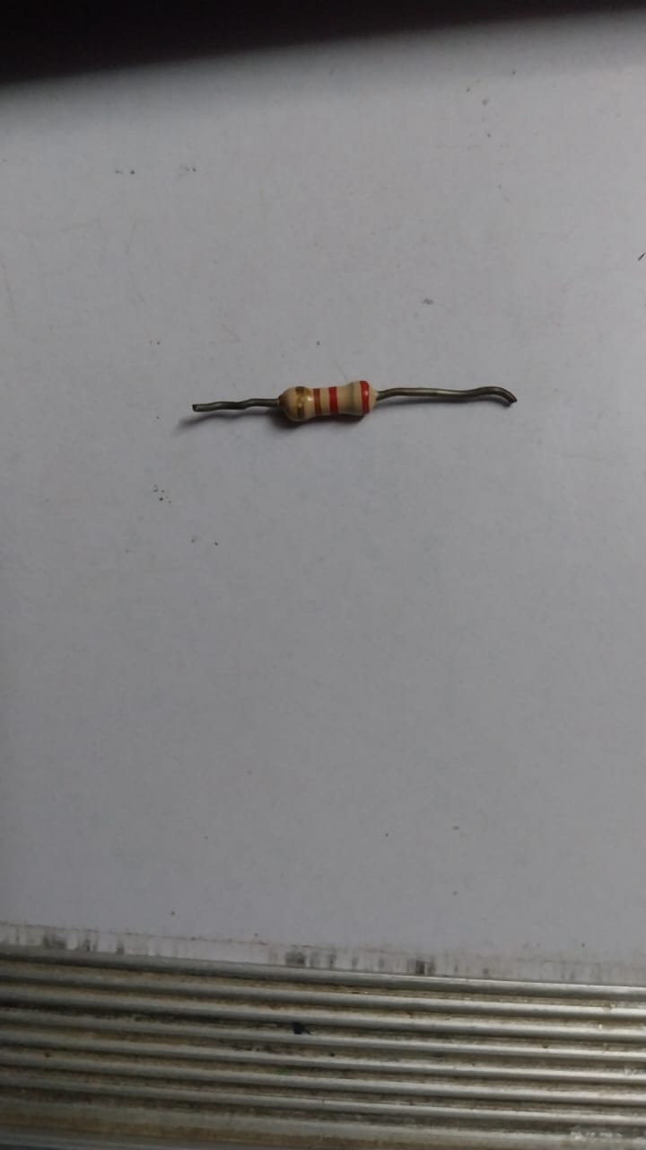

5. The tweeters seem to be hooked up directly in parallel with the speaker. Is this okay or the resistor i found goes in somewhere.

The tweeters are piezo types which usually have a resistor in series with them.

P.S. A piezo tweeter can be connected directly across the bass speaker terminals, but putting a resistor of the order of 20 ohm in series with the tweeter makes it a more stable load for the amplifier.

i found this resistor with it seems to be of about 220 ohms but is clearly not a wire wound one much less one of significant wattage so is that fine? or should i put in a wire wound one?No, but best to include the resistor - a 5 or 10 W wirewound resistor is suitable.
For certain, yes!
Use a standard value of 22 ohm and make sure it's a 5 W or 10 W ceramic (wirewound) resistor.

I don't know whether I'd go that far but I'd measure this resistor before reusing it, or in at least investigating whether it may have been sufficiently specified to begin with if replacing it.should i put in a wire wound one?
More importantly, where was it used? You might have a little testing to do before making a decision.
Srimp has said that the resistor is 220 ohm and, judging by the second photograph in post #1, it is rated at no more than 1/4 of a watt.
I think it may simply be a rogue resistor!
220 ohm is inappropriate for the desired application, as that would roll down the high frequencies noticeably. Instead, I have recommended 22 ohms in series with the piezo. It does not have to be a wirewound resistor, but a power handling measured in watts is preferable to one measured in fractions of a watt.
If Srimp wanted to get the best performance from his piezo tweeter, he could wire the 22 ohm resistor in parallel with the tweeter and connect a 4.7 uF film capacitor in series with the parallel tweeter/resistor combination.
Srimp said he found the tiny resistor with the drivers and asked if it should go in somewhere.
The resistor is not included in the wiring shown in Srimp's photographs, but is only pictured as a separate entity.
It's possible that it may have nothing to do with the speakers at all, and has simply "fallen in the box"!
As you said, and I don't disagree. A resistor will roll off the highs into a capacitive load, and always with the same slope. It only makes sense as a series element in a subset of possibilities.
