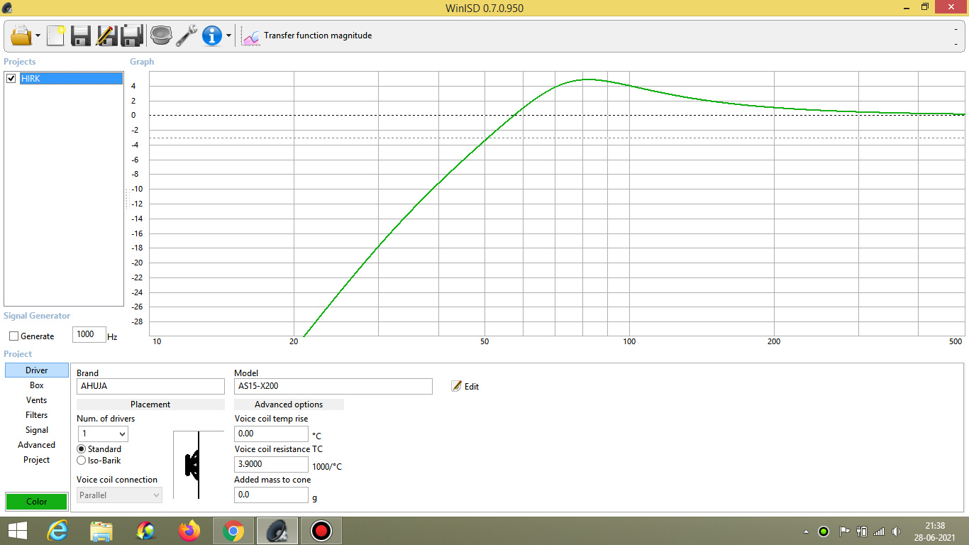

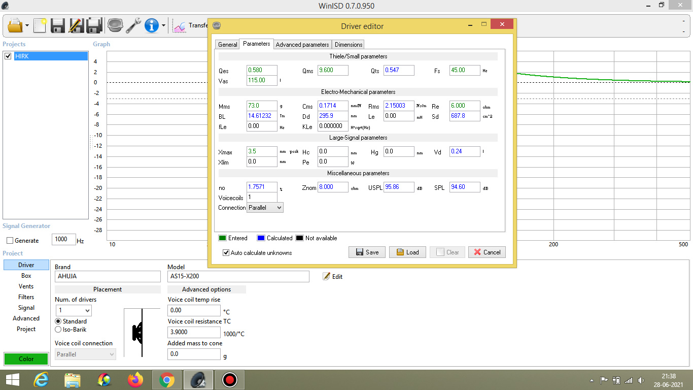

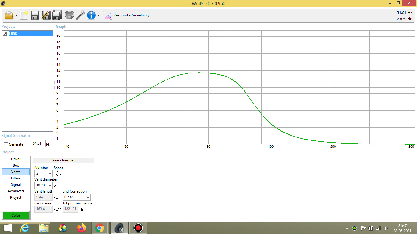

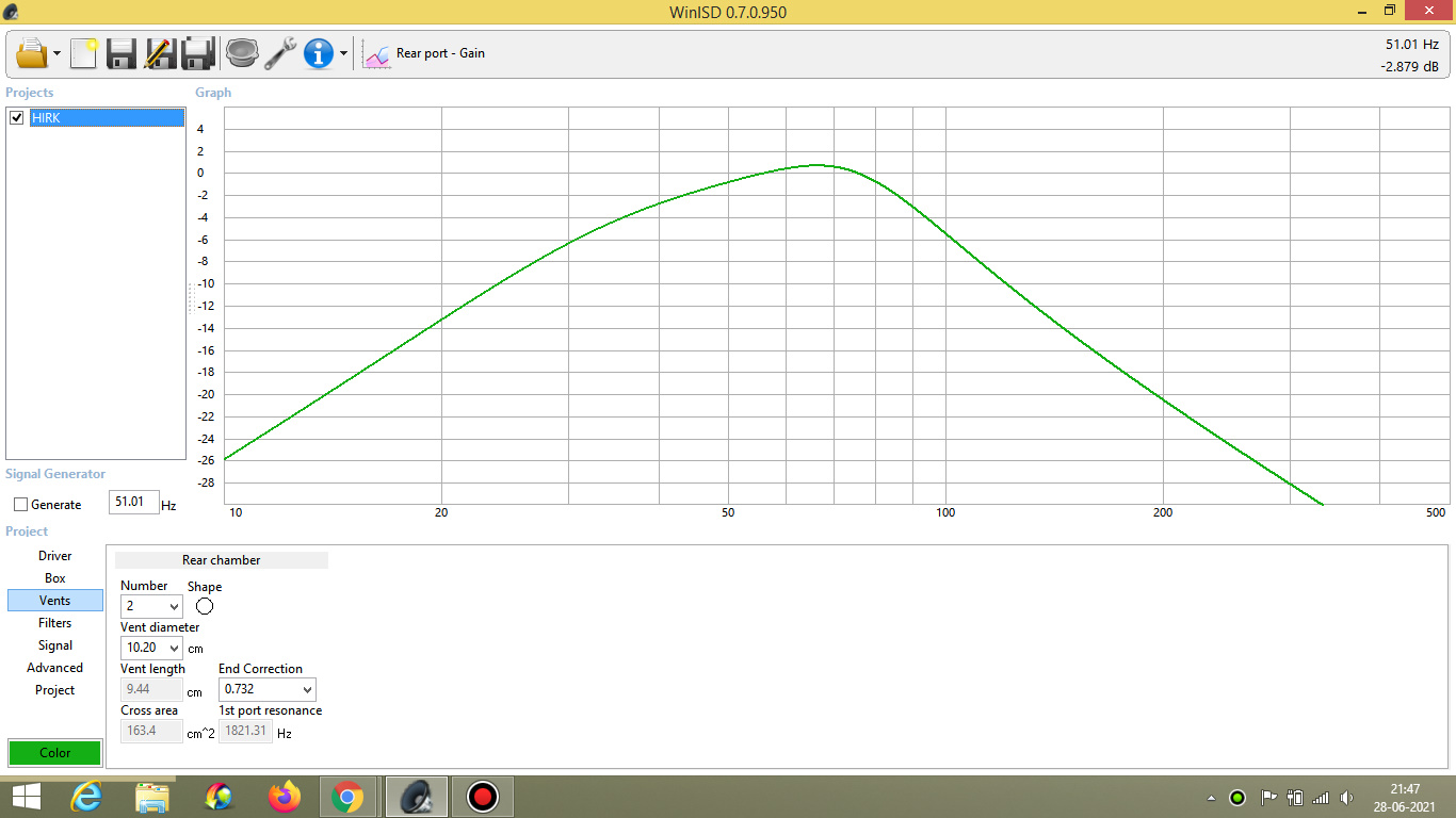

This is my first post here. I'am a complete newbie when it comes to diy loudspeakers, so please bear with me. Recently, I have attempted a project in winisd using a 15" driver by the name Ahuja AS-15 X200. The T/S Parameters for the driver are as in the image along with frequency response graph. The box volume is 86 litres with tuning frequency as 58Hz, however the -3.0Db point of the box is at 51Hz. The Ports are 10.2cm in diameter and there will be two of them. Looking at the FR graph there is huge peak from 50hz to around 70hz. So Friends, looking at the graph how do you think this box would sound? Thank you very much.

Tricky question.
Depending on your room size, the proposed speaker location within the room, and the absorptive materials in the room it could be enjoyable, or fulsome or completely overblown. Some would add a Sub woofer for the very lowest frequencies.
Double check your parameter's and verify correct units are used and see if you can fill in a few more parameters just to make sure you have captured as much data as possible. What does the impedance curve show two equal amplitude peaks either side of the box frequency?
Try running the model for sealed with a Q or 0.5, and maybe 0.8 to see how it behaves and lessens the bass hump. Also try the vented SBB4 alignment and see if that gives less of a hump, but falling off a a bit quicker.
15" bass drivers are not something I play with, but there are lost here who should know what to try next, or give their views.

Unfortunately this driver is not well suited for bass reflex cabinets as its Qts value is 0.55. This high Qts is prohibiting a flat response leading to a huge bump in the frequency response. In most cases this will result in a boomy 'one note' bass. Furthermore, your cabinet is too small - at least twice the volume would be required to achieve a more flat response. Closing the ports (to get a CB) will result in an overall Qts of approx. 0.82 which will be reasonable flat but the -3dB frequency will be even higher (somewhere around 65 to 68 Hz)
Overall, this driver due to its TS parameters is best for transmission line cabinets or open baffle speakers.

It's not so much of a mistake the Qts being higher than what's considered optimal, it's too small of a volume with too high of a tuning.
Right, a T/S max flat with a bit of wiring resistance requires ~381 L tuned to ~32 Hz, so a better choice overall to EQ a HIFI/HT app if the reduced LF power handling is offset enough by room gain or try a higher tuning with differing EQ as required and use the 'click' test [impulse response] to damp any vent peaking [boominess]: Click Test | GM210 | Flickr

Dunno, from the ~ early days up to ~2000, prosound was ~ flat from 300 - 80 Hz, decaying 4th order to 40 Hz, i.e. reflex cabs tuned to ~45 Hz with ~56 Hz tuning for 'slam', so the majority of the vinyl, etc., HIFI speakers I designed and/or built were tuned in the 40s with party speakers in the 50s and sometimes 60s and went backwards as CDs, DVDs, etc., kept pushing the LF cutoff ever lower to the point now that only sealed can go low enough for some movies.
Regardless, 2.5 dB is just barely audible unless a room mode amplifies it enough, so for your music, may want more.
'Boomy' is when there's a prominent mid bass hump due to a truly under-damped alignment or inductance rise due to VC heating when driven too hard for too long even if not driven to Xmax like can happen reproducing a low note pipe organ sustain or electronic tone for the length of a song/whatever.

Anyway, 'tight' 'slam' with this driver would in theory be a classic alignment = ~ 80 L tuned to actual Fs with at least a 6" vent to get the historically desired 'bump' plus it can handle its full 200 W rating down to 40 Hz, but if the specs aren't pretty accurate it might take a lot of EQ to get it right in room.

Thanks again for the replies.What I want to know is with the graphs and details I have posted, if I were to use this box indoors with some bass boosting how would it likely sound?

Well, using Hornresp and adding some inductance [Le] that should have been part of the specs, the actual designed in 'bump' is more like +6 dB, which in a typical room is car boombox sounding to me, but I assume DSP can reshape it or boost the bandwidth [BW] above it to flatten it in room, or boost it if wanting even more 'boom'.
