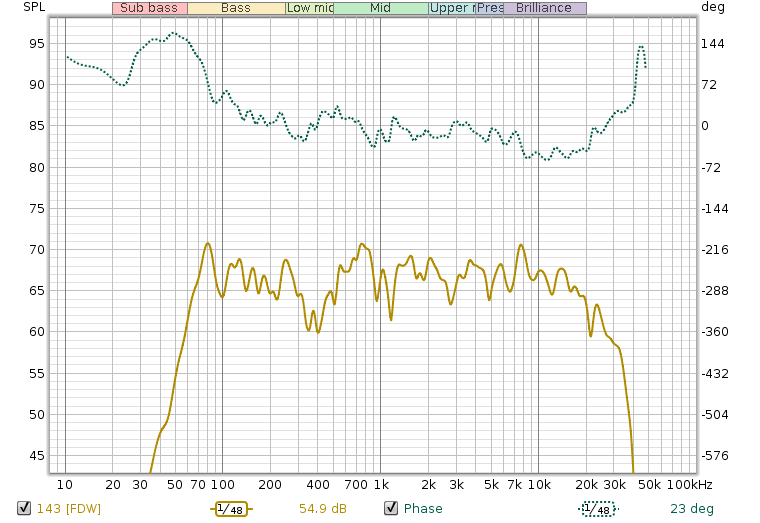

I measured response with the tweeter and woofer connected solo in box, 22 inches away on the plane of the bottom half of the woofer. This is roughly in a 13 foot cubic room, but I took care to reduce direct reflections. If this is acceptable I will post the REW files.

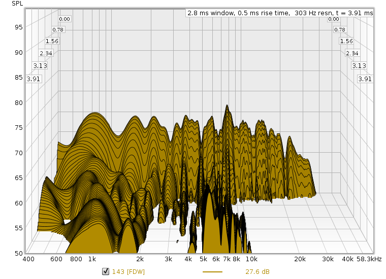

You said a 2.5 kHz XO won't work and 4.5 kHz would be a better choice - I would be very worried that the apparent ~3.2 kHz breakup mode (assuming it is one) would be wreaking havoc on directivity. The likes of Boxsim are no good predicting radiation in regions of non-pistonic motion. That said, smallish ribbon tweeters are in fact notorious for their excursion-related distortion issues towards the low end of their range, so you probably wouldn't want to go below ~4 kHz either.
The Stereophile measurements honestly are less terrible than they could be. The breakup mode seems to behave itself reasonably well once EQ'd out (mind you, you aren't going to eliminate the resulting peak in 3rd harmonic at ~1.1 kHz if inductance / B*L nonlinearity is a factor), and other than that there's just the usual issue of very mismatched woofer and tweeter directivity at crossover. Some designs have used the baffle step to their advantage in the past, but apparently not this one... the XO point might just be too high altogether.
What's intriguing is that things are actually looking less disjointed in the vertical. So some experimenting with baffle width may be worth it. This may be why e.g. the usual ADAMs are looking the way they do.

The reason this speaker appealed to me is pretty much just the AMT. Any peaks in the 3-5KHz region drive me absolutely nuts. Augerpro's mod with the notch filter convinced me to give it a go.
And then I decided I wanted to listen with equidistant acoustic centers, which everyone tells me is inadvisable but the resulting response actually seems pretty even and phase is pretty flat. Maybe this is related to how the AMT works. I was ready to throw away this idea until I saw that it actually works. The question is where do I go from here?
This is the frequency response and spectral decay. For the response I used a 15 cycle window. For more extensive mods (if worth pursuing) I'm thinking a shallower woofer to move the acoustic centers closer (so you don't have to tilt the speaker back as much) and better match the dispersion of the woofer with the tweeter makes sense. At least for my amateur crossover.
The treble sounds hot, so maybe you are right about the dispersion problem. I just don't trust dome tweeters enough to pay for one I haven't heard yet. And it would be hysterical to try to mod one into the baffle anyway.
